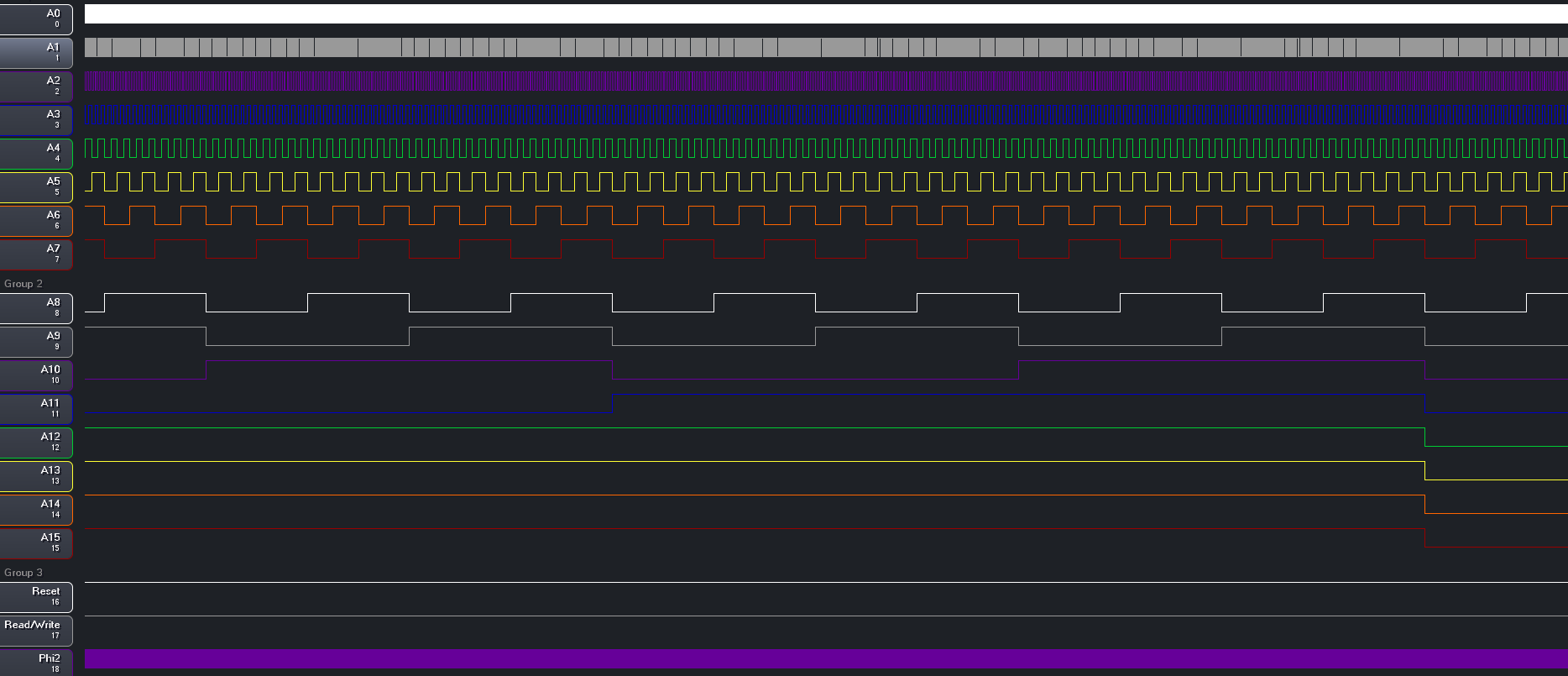

Alright, so here is the progress I made today: First, I swapped the 65C02 with one that I tested on a breadboard setup, and have in-fact run BASIC on just to rule out a bad processor. Admittedly I hadn't tested the other one yet, but it was brand new so... didn't think to. It will get the breadboard treatment soon enough.

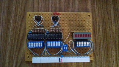

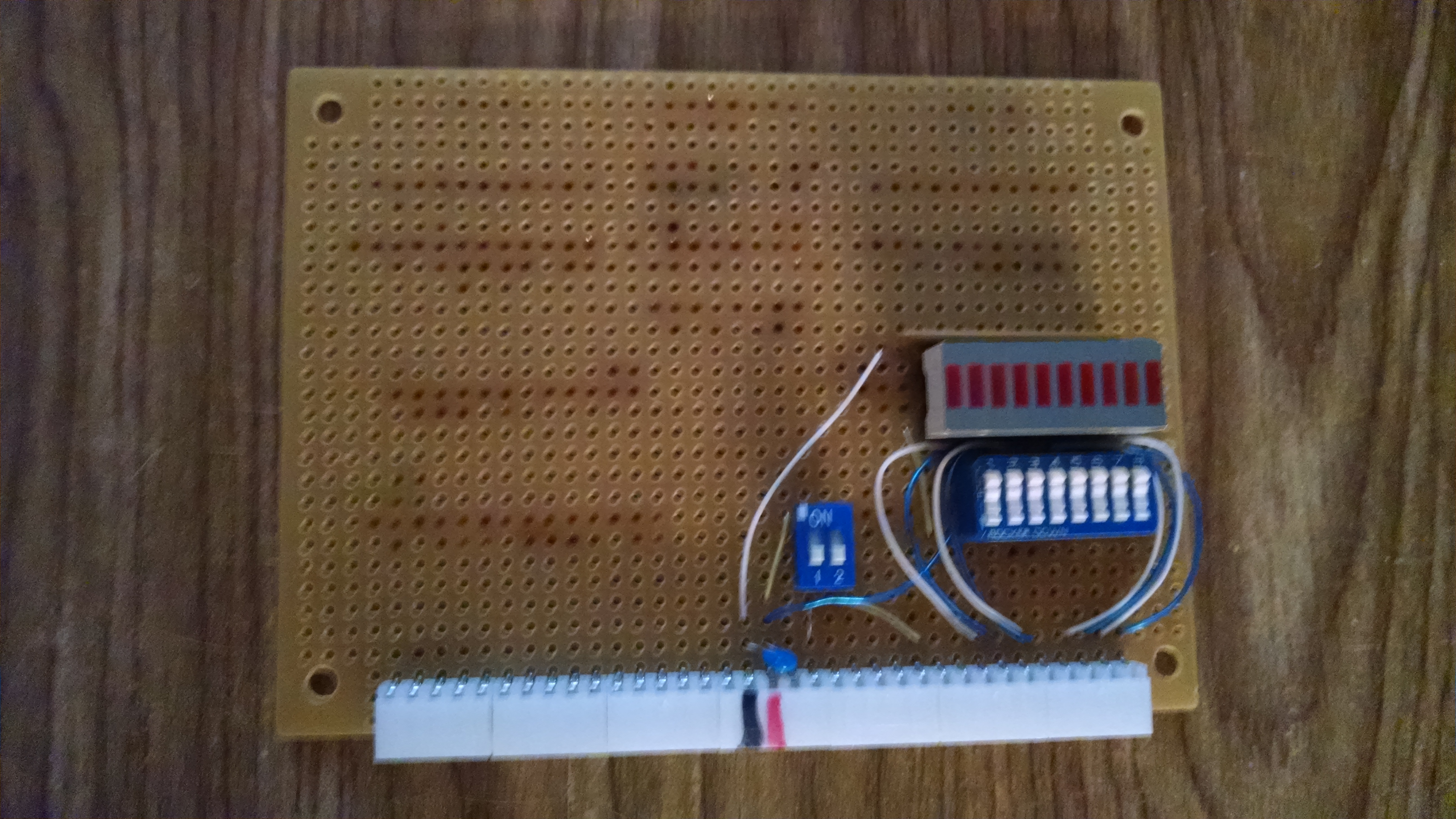

I built a little diagnostic board to interface with the data bus and avoid all of my complex front panel circuitry for the moment. I put a little socket on there for an LED bar for another test I want to perform. For the NOP test, it was not in place, and those three signal lines were tied to ground.
Diagnostic board
Diagnostic board
The stains on there are from my first attempt at making a serial board. No reason to let good protoboard go to waste.

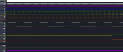

This is pretty cool to see. I turned down the sampling rate to see more of the address bus transitions. It's fun seeing 0xFFFF come and go.
Test #1
Test #1
I performed the test with the CPU card sitting where you see it pictured, and again and the other end of the backplane, just to verify the results matched. Sure enough, both locations produce the same results during the NOP test.

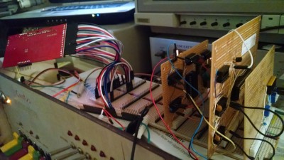

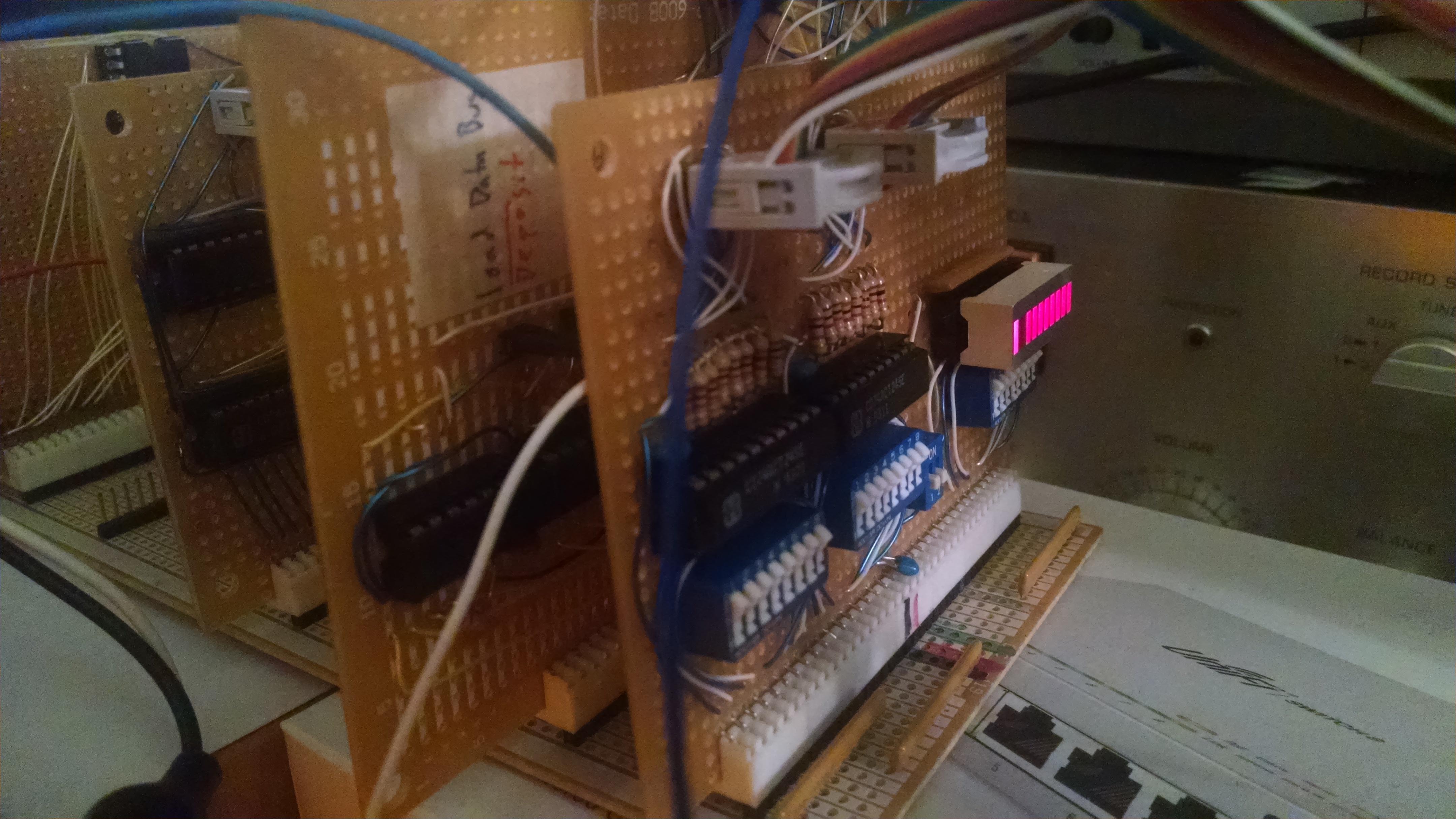

I've been making a few improvements.
First off, I decided to throw some 1K terminating resistors on the data and address buses. It got rid of plenty of phantom signals, so I don't know why I didn't try this sooner.
Card bus closeup
Card bus closeup
I've updated the debug card to now let me directly control the data and address buses. The address bus LED signals are going through 74245's to avoid having to zigzag back and forth like with '244's.
Debug Card
Debug Card

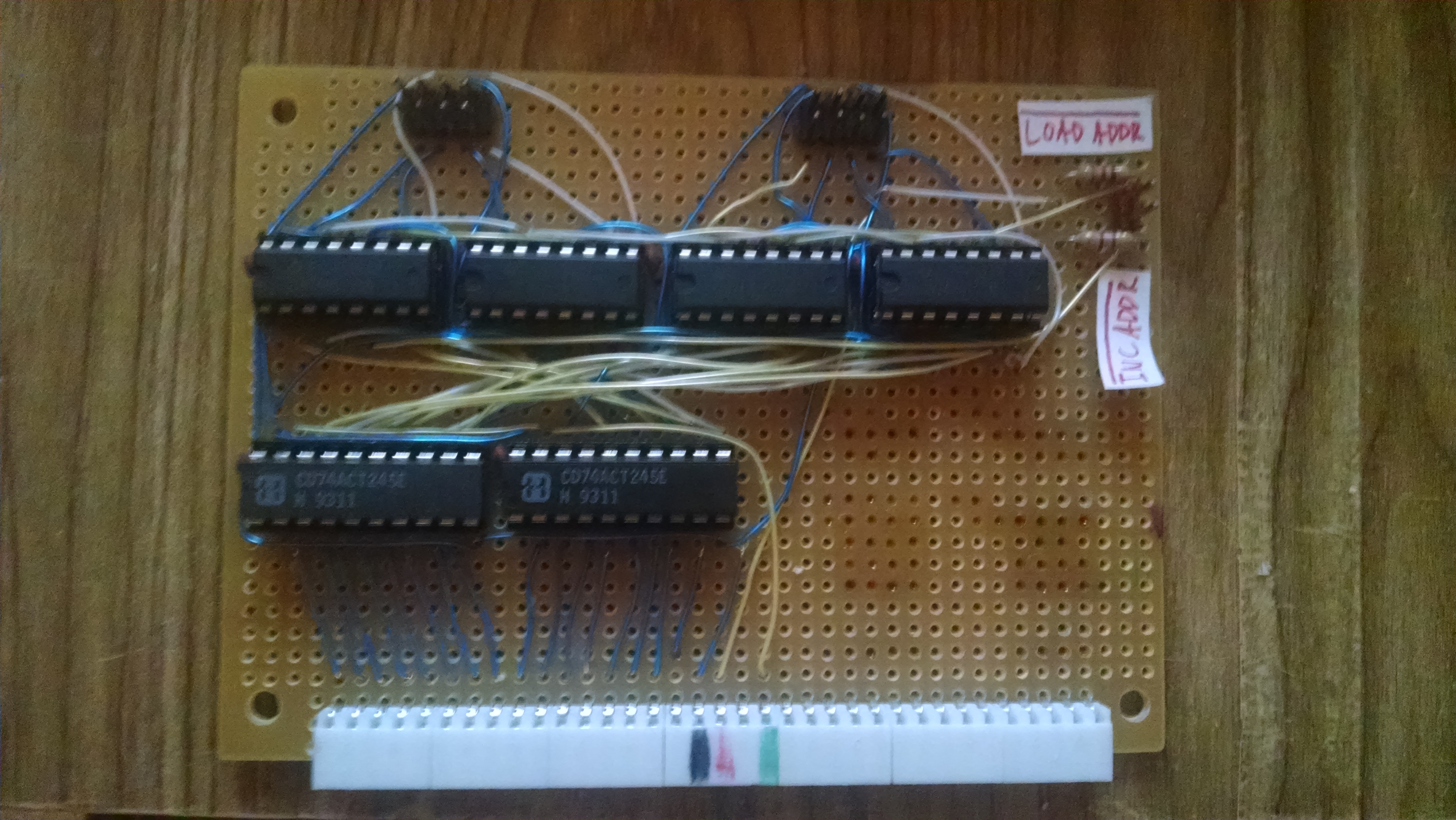

While I was at it, I overhauled the Address Control card. Replaced the '244's with '245's to make the wiring easier for my eyes to follow. I also touched up the 5V traces to make sure the chips were all getting power. Tests show that this card is working better than ever! At least something I built works. :lol:
Address Control Card Rev 2

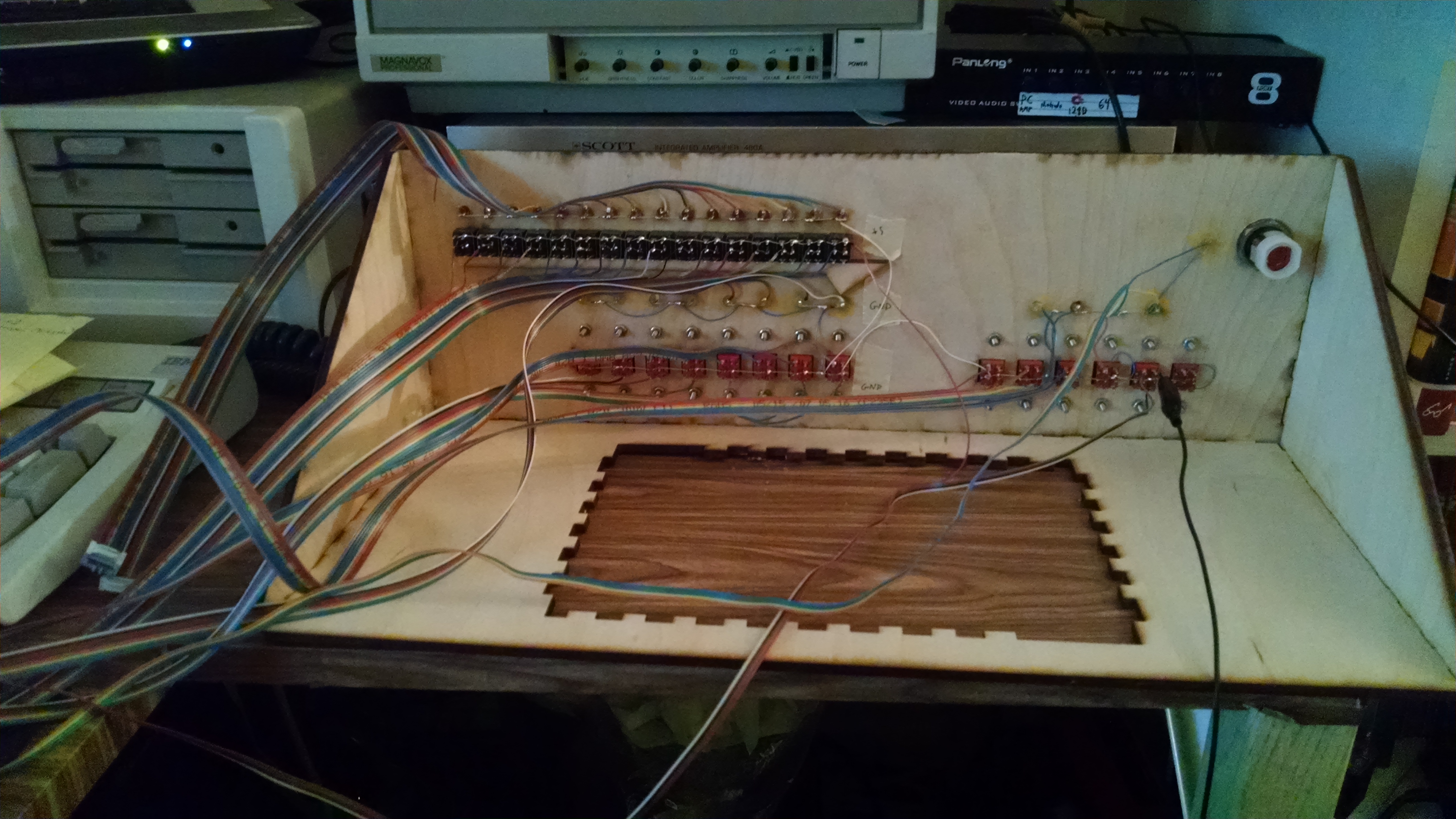

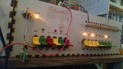

Front panel energized
I'm running a few EPROM reads and RAM writes using the front panel logic. Since the status control card isn't present to actually perform tasks like telling the address control card to load the front panel switch value, or deposit a value into RAM, I'm having to manually signal those inputs high or low. I get to be the orchestrator. During such tests, I can successfully read and write values from RAM. The individual clear signals don't seem to work incredibly well, but the individual set signals seem to be just fine. I'll have to check over that card next to see what the heck I'm doing wrong.
I burned an EPROM with zeros for the reset vector, and tried entering a program into RAM by hand to see if I could get something to run. Nothing too fancy, but something I know works fine on an OSI-300.
A2 05 8E 08 00 4C 00 00
The rest of RAM was filled with garbage. The majority of ROM was filled with 0xFF's. I tried letting the CPU run, performing a reset first. I watched the lights to see what was going on, only to see that the CPU was jumping around all over the place, probably running on errant instructions in RAM. A few of my values got clobbered...

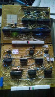

I've got the Memory Protect toggle working now, along with the R/W line indicator (which is mainly useful while depositing bytes into RAM). I've also replaced a handful of the 7400 series chips with the most modern variants I have on hand.
Status & Data Control Cards
Seems I had original SN7474's in the data control card, which were experiencing "phantom all-clears" as I call them. Whenever I would press the clear switch for any of the 8 bits on the front panel, 90% of the time, more than one if not all 8 bits would clear themselves from the front panel flip-flops. That kinda defeats the whole purpose of having individual clear switches. Turns out newer chips don't seem to have this problem, which is nice.
As well, my 27128 was jumpered incorrectly, due to a holdover from when I was using a 27256. The result was that I could read from the EPROM maybe... 10% of the time, and would get a garbage result another 10% of the time. The remaining 80% was no response. With that pin held low, I shouldn't have been able to get any reads at all, but that seems to be cleared up now.
After trying a handful of short programs, either entered into RAM, or read back from an EPROM, I'm still getting no evidence of computation occurring. I have come to the conclusion that due to how long the bus traces are, I should add in some 74245 bus transceivers to help the 65C02 drive all the devices it needs to. I thought I wouldn't need them because of the helpful Bus Enable pin, but I'm going to play it safe and revise my processor card either way.
During some of my tests of the single stepping circuitry, I'm noticing voltages feeding the Ready line that I find concerning. They aren't 0 or 5, so I know I have some work to do there. I had just overhauled the card's logic too, to pull the Bus Enable Pin high on either single step or normal clocked operation. For the moment for clocked operation, I'm bypassing this circuitry to pull Ready and Bus Enable high.
I've had alot of trouble getting my logic analyzer to work, and it seems to be causing more interference than helping things right now, which is frustrating. Not to mention, it hasn't been correctly responding to capture-on-trigger events, so I can see what's happening on a reset or anything like that.
I filmed a demonstration of my front panel logic, if you're interested in watching me ramble for a bit, during a moment when things seem to actually be working: https://www.youtube.com/watch?v=3Sv3pIyMBEk

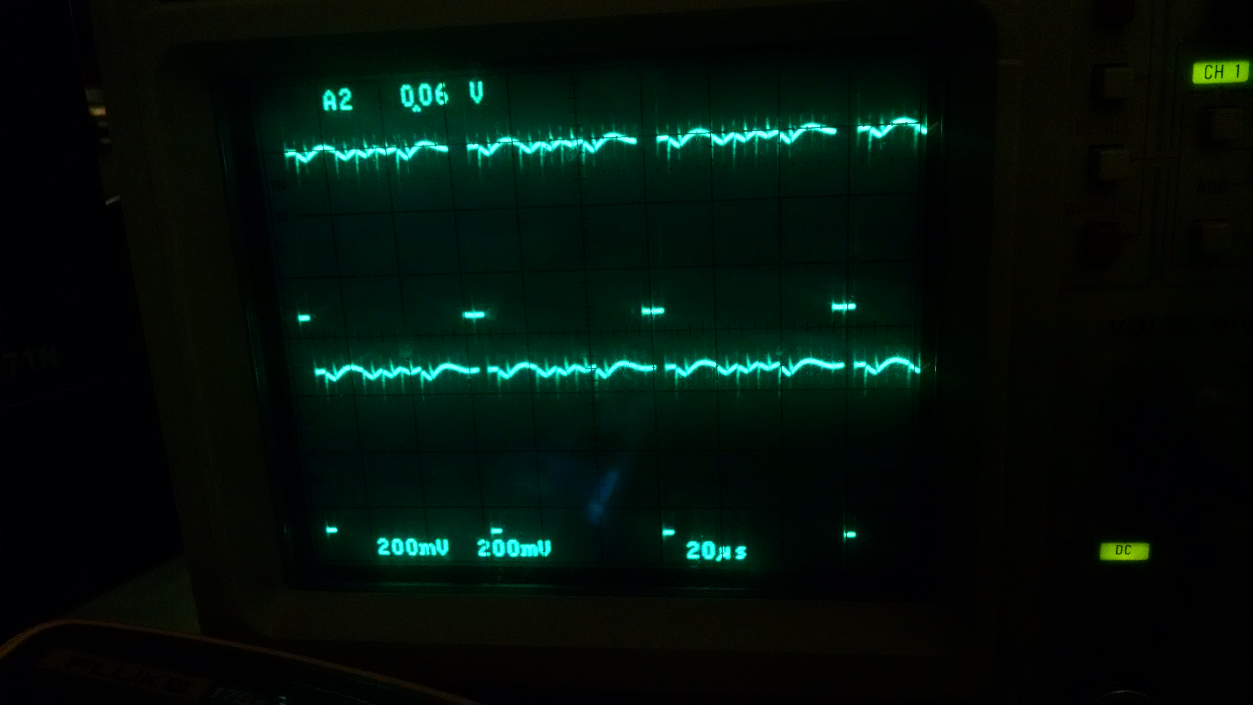

So I made a few signal line tweaks, and put the R/W line on a tri-state buffer that would be high-Z while the processor was running and...
I've now run a few simple hand-toggled programs from the front panel.

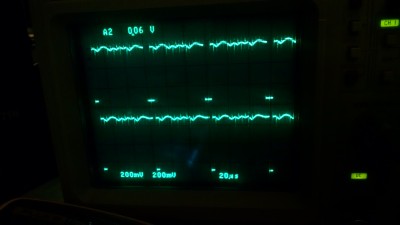

This is how bad the R/W line was looking after the first set of tweaks. The upper waveform is the R/W output on the 65C02, and the lower waveform is the /WE line on the RAM.
The signal has since been cleaned up due to the subsequent tweaks and modifications. Time to see what else I can get working!

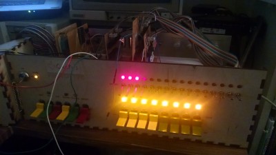

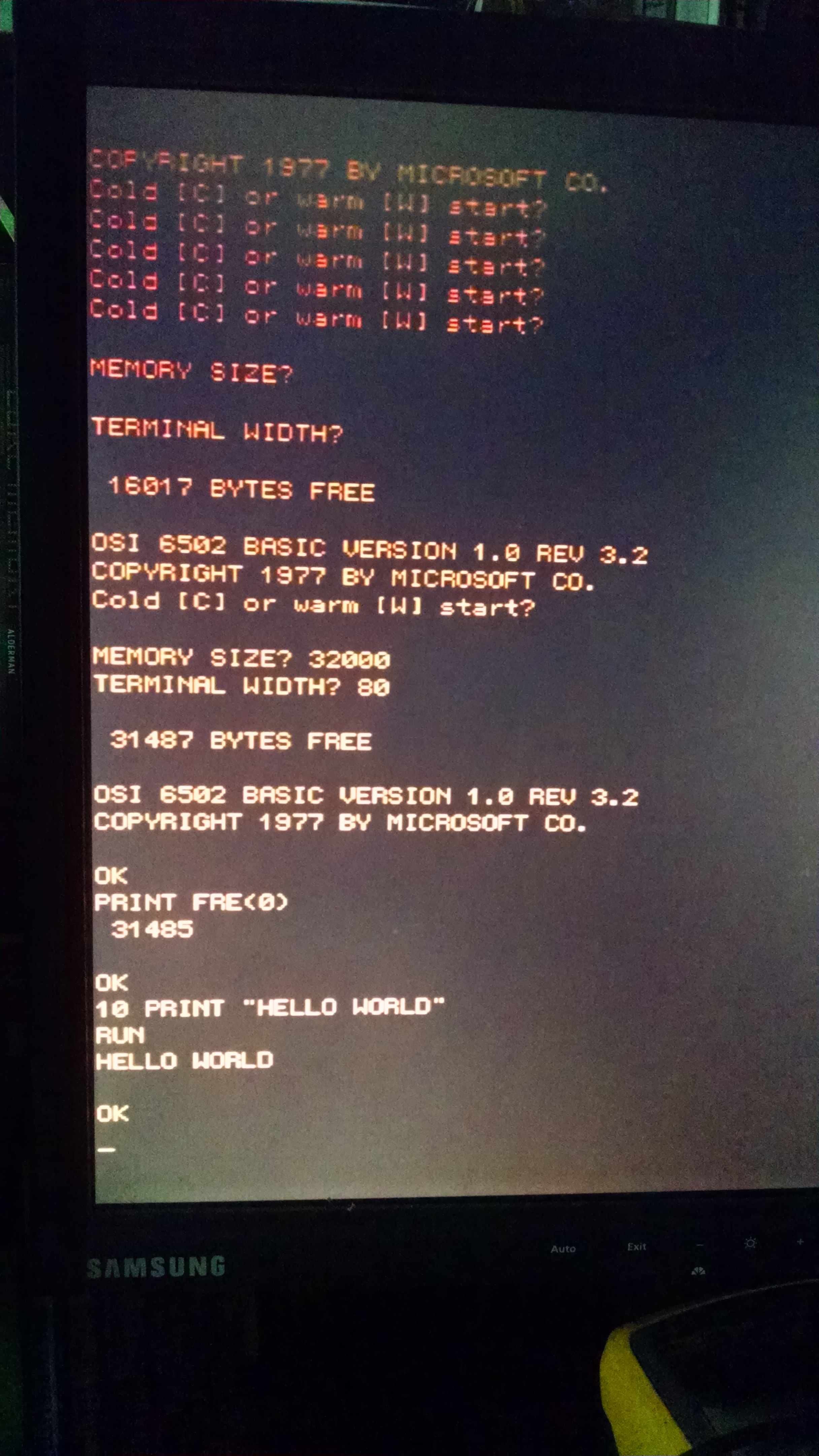

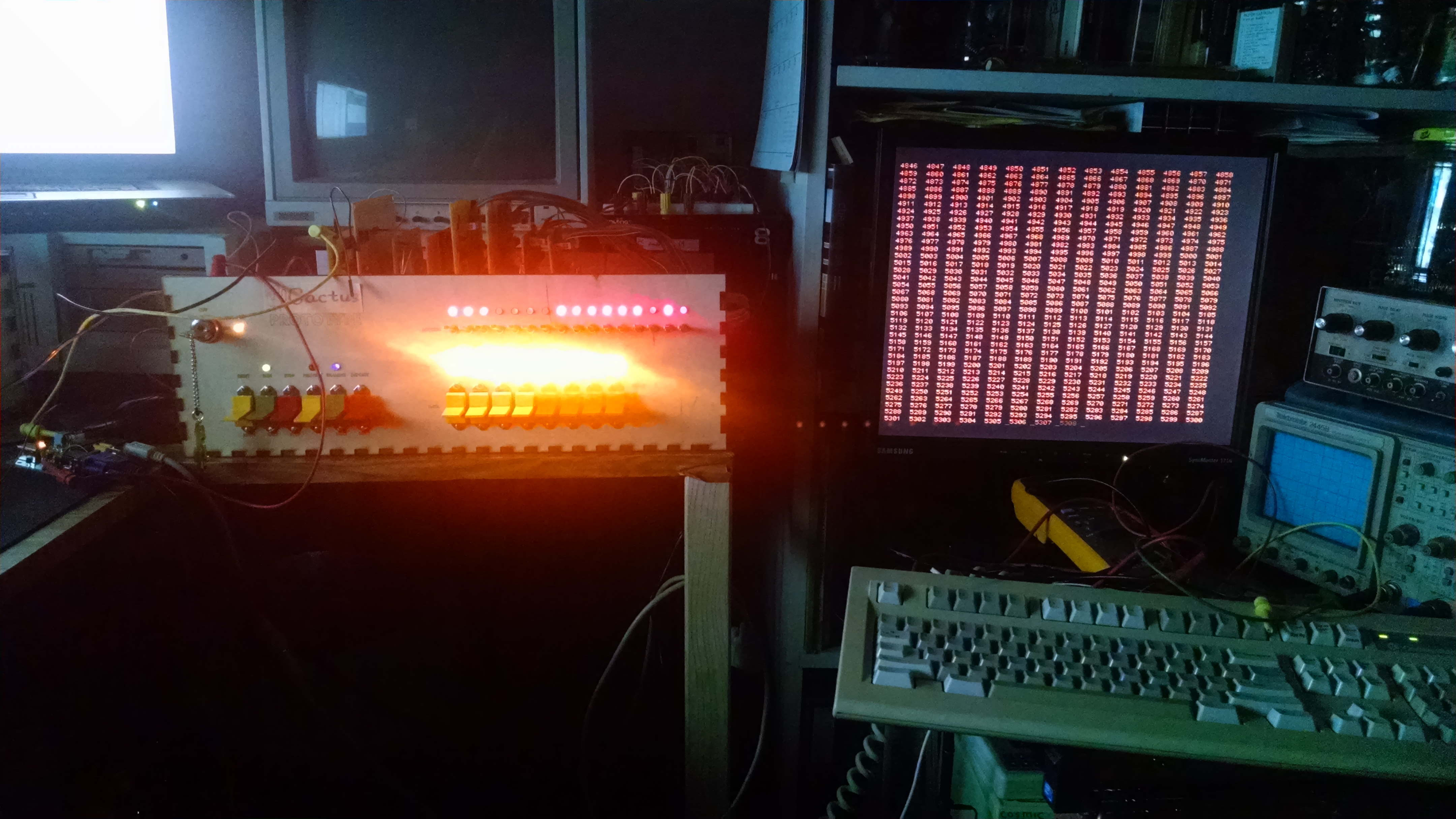

It took a bit of finagling, but I was able to get the serial card to play nice at TTL levels. The RAM calculation method seems to only detect the first 16K automatically, and you end up in a loop if you let BASIC figure out how much RAM it has on its own. If you tell it 32K is available (yes, I know that's not precisely 32K), then its will let you start entering programs just fine. I tested a few simple BASIC programs, but I know I have some adjustments to make to get RS232 level conversion working.
Would you look at that. Serial & blinkenlights.
