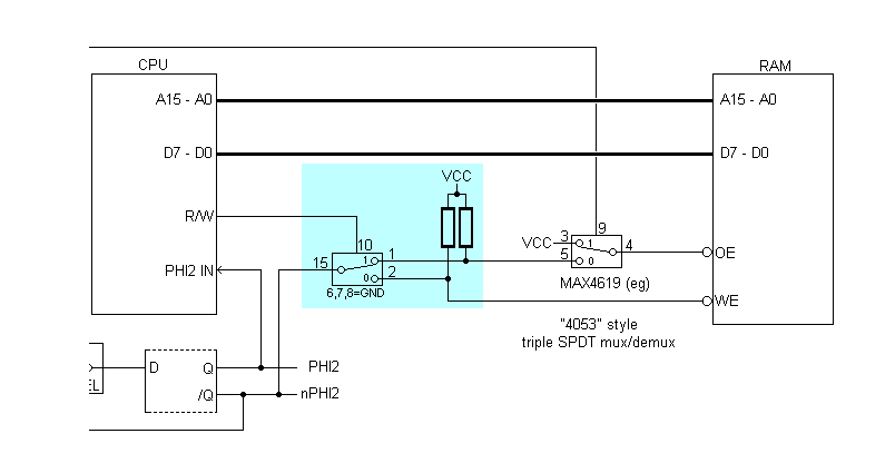

BTW it's perhaps worthwhile to comment on how the SPDT mux/demux generates /OE and /WE in the schematic in my previous post. (For reference I also posted an equivalent that doesn't use a mux/demux.) Here's an excerpt, with the area of interest highlighted.
pullup detail.png (5.5 KiB) Viewed 2446 times
Basically the SPDT "steers" the active-low version of Phi2 to either /OE or /WE.
  • This is NOT "open collector" logic, at least not in the usual sense. The pullup resistors are not responsible for returning /OE and /WE to the high state after the end of each cycle. They are actively driven back to the high state during the delay that exists before the CPU then the mux/demux select input can respond. The pullups are only intended to keep /OE and /WE high thereafter. (We don't want them to drift low during single-step operations.) I used 2k2 pullups but a much higher value would've been OK.
  • The mux/demux has, in effect, almost zero propagation delay, and that can make a big difference in some cases. Signals pass through the contacts of the SPDT "relay" as if they were a 10-ohm resistor -- almost the same as a piece of wire. (However, the select input -- the "coil" of the relay -- is subject to normal propagation delay.)
  • A mux/demux can often reduce the package count in a discrete-logic design -- and that's why I used it here. It saves space, and there are fewer connections for me to hook up! :)
( MAX4619 datasheet attached. There are LOTS of mux/demuxes on the market. 10 ohms is a rather good figure for on resistance; some products are even lower, some are higher. )

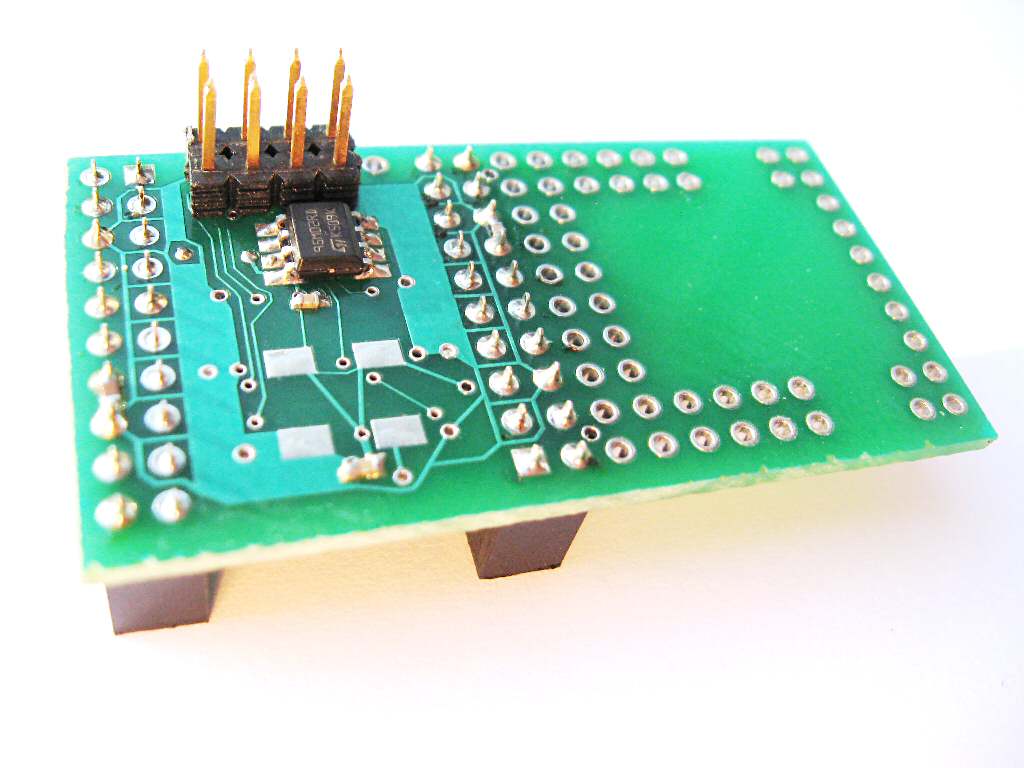

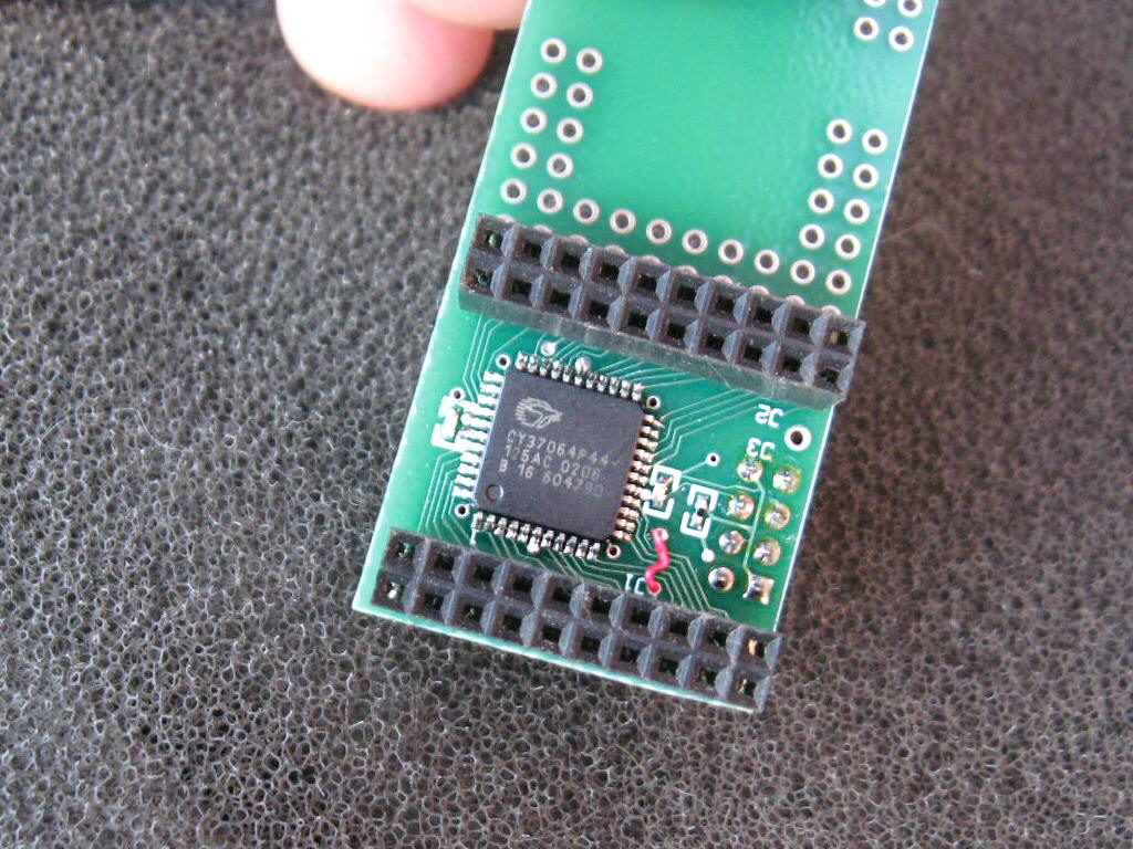

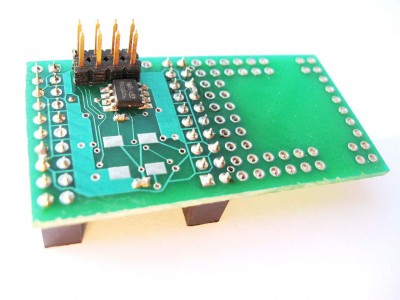

So tell me, please... How do you use your CPLD-ish boot loader? Does TTC (Throw Together Computer) have ROM in it or do you need a PC and the CPLD boot-loader to boot it up? Also, does TTC have an address decoder and any I/O chips?

No -- no address decoder and no I/O chips. And the CPLD is mounted on a breakout board that mounts onto a pair of wire-wrap headers on TTC itself. Besides providing a wiring interface, this also makes the breakout detachable; ie, recyclable for another project. The 8-pin header on top is for programming, and there's also a small prototyping area -- with fewer holes than I would prefer, but holes are budgeted, and the proto area (a low priority) is where I went broke! The entire breakout project was an afterthought, riding on the coattails of an unrelated PCB order.
Presently TTC does rely on a host PC for bootup, but that could change since the breakout board has a serial EEPROM (and an oscillator footprint, not yet populated when the photo was taken). The CPLD ( CY37064 ) is an obsolete part but I found some locally; also I have the Cypress programming software.
