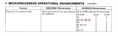

The most numerous undefined NOP's have no time for a data fetch, as they are both single-byte and single-cycle. 64 such NOP's are present on older 'C02 processors such as the NCR65C02; their opcodes fill columns $3, $7, $B and $F of the opcode map. Slightly newer C02's including Rockwell use columns $7 and $F to accommodate the bit-manipulation instructions, thus reducing the number of single-byte, single-cycle NOP's to 32. Modern WDC C02's further reduce that number to 30, as the STP and WAI opcodes reside in column $B.

The really curious one is $5C which is apparently a 3 byte, 8 cycle NOP. That doesn't correspond to any addressing mode, not even the illegal RMW (zp),Y / (zp,X) instructions on the original 6502, which are 8 cycles but only 2 bytes long. Anyone know what the memory access pattern is during NOP $5C?
(Edit: it's in Jeff's link - thanks for the info. Bizarre indeed!)

I tested the instruction "5C 1234h" (stored little-endian as 5Ch 34h 12h) as an example, and observed the following: 3 cycles fetching the instruction, 1 cycle reading FF34, then 4 cycles reading FFFF.
The pattern for $5C is pure nonsense, I'd say. It certainly doesn't correspond to any legitimate address mode. But we don't expect it to. The single-byte, single-cycle NOP's don't do so, either. Only a minority of the undefined NOP's happen to display semi-meaningful behavior -- and even that is more by fluke than by plan. The only requirement is that the undefined NOP's be benign.
To me it's clear the 'C02 designers wanted to ensure processor registers and flags were unaffected by undefined instructions. They fully met that spec, but they weren't the least bit fussy about how it was done -- they just chose whatever cheesy shortcuts were easiest. It's not surprising that some of the resulting behavior is gobbledygook.
