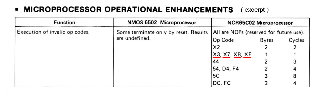

Are all unimplemented codes on the C02 NOPs?
The processor thinks they're NOP's, because no flags or registers are altered. But in some cases a data fetch (a fetch other than the instruction fetch) is generated. Depending on the system, that might have potential for a destructive read of an I/O register -- so, perhaps not a NOP from the system's point of view. :!:
On a more positive note, the NOP's are useful for hardware and software hacks. (The software hack, discussed here, uses the NOP to skip a byte or two. It's smaller and may be faster than a BRA.)
The most numerous undefined NOP's have no time for a data fetch, as they are both single-byte and single-cycle. 64 such NOP's are present on older 'C02 processors such as the NCR65C02; their opcodes fill columns $3, $7, $B and $F of the opcode map. Slightly newer C02's including Rockwell use columns $7 and $F to accommodate the bit-manipulation instructions, thus reducing the number of single-byte, single-cycle NOP's to 32. Modern WDC C02's further reduce that number to 30, as the STP and WAI opcodes reside in column $B.
Jeff has used the single-cycle ones for his fast-I/O tricks.
Yes, the single-byte, single-cycle have great potential for hacking. :twisted: :D They're fast, compact and plentiful. And your hardware perhaps won't need to decode the entire opcode -- merely decoding the column may suffice.
That said, the remaining NOP's (non-single-cycle) are the most intriguing, as they give your hardware access to the following address modes (as dictated by an appropriate program):
  • Absolute
  • Zero-page
  • Zero-page,X
  • Immediate
For example, your program might include the two-byte instruction $44, $69. $69 is some arbitrary location of interest, and $44 is the opcode for "NOP" Zero-page. At runtime $44, $69 will cause the processor to obligingly fetch whatever's at $69. The processor discards the byte fetched, and it remains only for your hardware to capture it by snooping the data bus. That's how my KK Computer is able to load a Bank Register in only three cycles. :mrgreen: (Or two cycles, using "NOP" Immediate.)
For detailed specifics on 'C02 NOP's see here.

The really curious one is $5C which is apparently a 3 byte, 8 cycle NOP. That doesn't correspond to any addressing mode, not even the illegal RMW (zp),Y / (zp,X) instructions on the original 6502, which are 8 cycles but only 2 bytes long. Anyone know what the memory access pattern is during NOP $5C?
(Edit: it's in Jeff's link - thanks for the info. Bizarre indeed!)

I tested the instruction "5C 1234h" (stored little-endian as 5Ch 34h 12h) as an example, and observed the following: 3 cycles fetching the instruction, 1 cycle reading FF34, then 4 cycles reading FFFF.
The pattern for $5C is pure nonsense, I'd say. It certainly doesn't correspond to any legitimate address mode. But we don't expect it to. The single-byte, single-cycle NOP's don't do so, either. Only a minority of the undefined NOP's happen to display semi-meaningful behavior -- and even that is more by fluke than by plan. The only requirement is that the undefined NOP's be benign.
To me it's clear the 'C02 designers wanted to ensure processor registers and flags were unaffected by undefined instructions. They fully met that spec, but they weren't the least bit fussy about how it was done -- they just chose whatever cheesy shortcuts were easiest. It's not surprising that some of the resulting behavior is gobbledygook.
The main shortcut is to throw a wrench in the instruction-fetch procedure when a column-$3 or -$B opcode is fetched. As we know, a 65xx processor's usual procedure for beginning an instruction is to
  1. put SYNC high and fetch the opcode byte
  2. put SYNC low and fetch at least one more byte
But when a 'C02 detects a -$3 or -$B opcode it simply shrugs it off and restarts the opcode fetch procedure. Here's the 'C02 procedure:
  1. put SYNC high and fetch the opcode byte. If it's column-$3 or -$B then GOTO Step 1.
Evidently the predecode logic is at work here, as the usual pipeline is short-circuited. But it successfully prevents whatever non-benign gobbledygook might otherwise result from the -$3 or -$B opcodes.
It'd be interesting to see how the 65C02 decode ROM compares to that of the 6502. In column $xC, there are some new instructions (TSB/TRB abs, JMP (ind,X), etc), so I guess it's conceivable $5C ended up with unusual behaviour, and they just added the minimal number of patches to the PLA to ensure that it was benign. I guess we'll only know for sure with a Visual 65C02!
