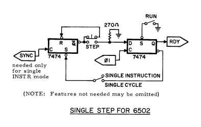

I've attached a small schematics for a single step circuit and I wonder if it will do?
single step.png (26.32 KiB) Viewed 3501 times

I seem to recognize that as a Wozniak circuit -- someone (Alarm Siren ?) posted it once before. It should work as-is using a 7474, but with any other part you'll need minor changes.
If you use 74LS74 then the 270 ohm resistor may need to be replaced with a somewhat larger value (determined by experiment).
If you use a CMOS flipflop such as 74HC74 or 74HCT74 then replace the 270 ohm with 1K - 4K7 (not critical). On the left FF section add a pullup resistor on the /S input and another on the /R input, and tie the D input (not shown) high. On the right FF section add a pullup resistor to the /S input, and tie the /R input (not shown) high. You can add pullups on both Ck inputs as well, but they're not really needed unless the CPU is NMOS and you use 74HC74 (rather than HCT).
Woz has taken a slightly dubious short-cut. With 74xx and 74LSxx chips you can kinda-sorta rely on unconnected inputs pulling themselves high.

... Woz has taken a slightly dubious short-cut ...
That's one of his most endearing qualities, IMO. :) His hardware and software designs are sprinkled liberally with slightly dubious short-cut seasoning.

I wasn't being critical -- I'm a Woz fan, too! And the "pull themselves high" principle is certainly adequate for unconnected TTL inputs in a hobby environment. You have a very good chance of never getting trouble from using this trick, and it can save you some time and space if you're just hacking around on a breadboard.
But it is a trick for TTL only, and these days it's hard to find any good reason for using TTL. Moreover it's not a trick the datasheets will endorse. In a more cautious design you'd use a pullup or tie the unconnected input high. Otherwise there's a risk of an unwanted signal (noise or leakage current) causing the input -- which in this case you want to be high -- NOT to be high (perhaps only instantaneously).
TTL and CMOS chips both have some degree of noise susceptibility regarding unconnected inputs, but TTL is less critical -- also more predictable, for whatever that's worth. TTL inputs source a small amount of current and thus tend to go high when left unconnected. CMOS inputs have much higher impedance (increasing noise susceptibility if unconnected), and also you can't predict whether they'll drift high or low. So an unconnected TTL input is comparatively safe but still at risk under adverse conditions.

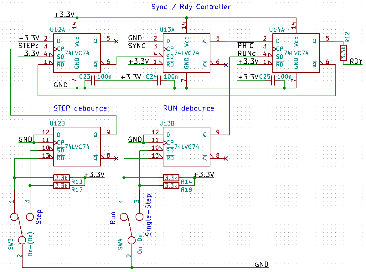

Yes, it was a Woz circuit that I was never able to get to work properly. I suspect there's something important missing from the diagram that he assumed as "obvious" but isn't.
jgroth wrote:
If someone could post a schematic for how to single step the MPU I would be able to do that.
I have a single-stepping circuit on my current 65c02-SBC, see attachment. It works like a charm and only requires 3 flip-flops (5 if you include debounce, but you could debounce using low-pass filters instead). This is single-instruction stepping, not single-cycle stepping.
You can substitute 5V for 3.3V rail, and you can substitute 74AHC for 74LVC. I wouldn't recommend using 74HC parts due to the propagation delay and assertion of the RDY signal needing to happen within a specific timeframe relative to PHI0. Also note that I've named PHI2 as PHI0 in this diagram, as I find PHI0/PHI2 less confusing than PHI2/PHI2O.
65C02 Single-Stepping Circuit Diagram

That circuit looks a lot simpler. I don't have any Schmidt triggers yet though but I have ordered a couple.

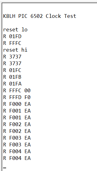

If it helps, here's the output I got using a PIC uC for single-cycle stepping an R65C02 several years ago;
6502 reset.png (8.08 KiB) Viewed 3431 times
