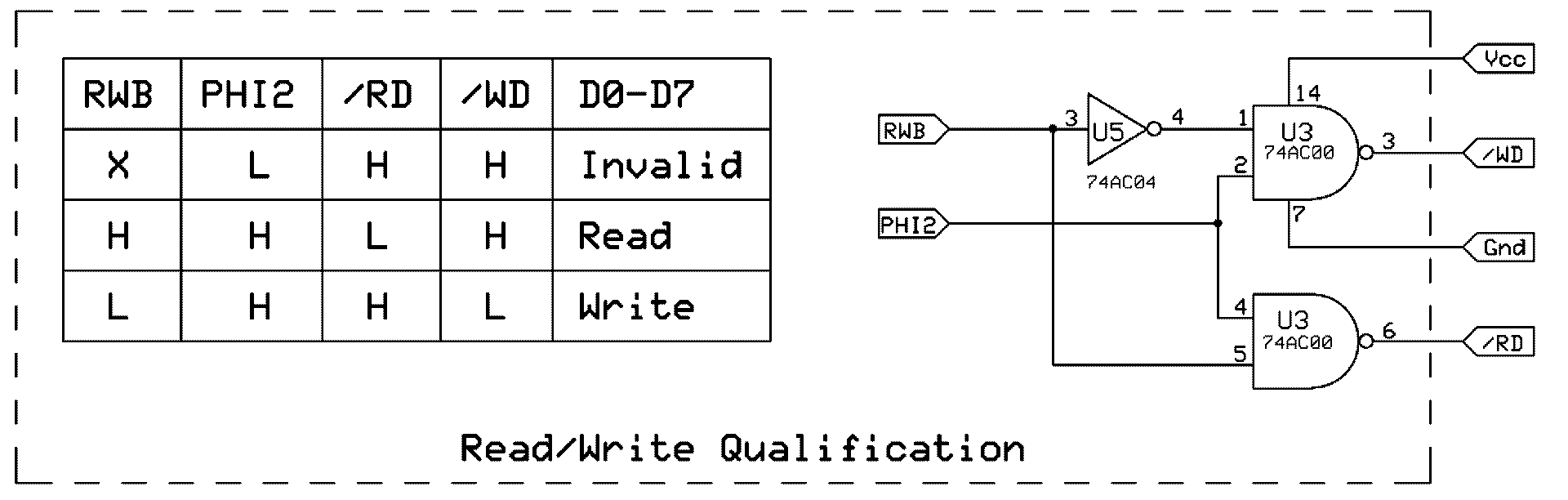

Posts: 9426
Re: Issue with Indirect Addressing
ChaseHQ85 wrote:
An Update! So after BigEd suggestion of it having to do with WR timing, I decided to remove my NAND gate from Phase2 out and CS and viola it all works as expected. Which is weird because that goes against timing. Here is what i think it is - and please correct me if im completely wrong.
So... My high performance low propagation time NAND gates are coming in tomorrow, so until then I created a NAND gate out of two 2n2222 transistors - I cannot find any propagation or switch time in any datasheet for them but apparently they could be the source of why the timing was off. I wont be able to confirm this until the correct Gates come in the mail tomorrow. Until then, just driving the CS off my decoding logic seems to work just fine... for now im sure... while there is nothing crazy going on or any high clock frequency.
Let me know your thoughts, but i am ecstatic that it's working.
The 2N2222s are rather slow and if saturated, can take quite a while (in computer terms) to turn off, creating all sorts of potential timing ambiguities. It'll be interesting to see if your problems get rectified with proper gates.
Regarding SRAM control, I know Garth's primer shows a circuit in which /CS is qualified by Ø2. The problem with doing it that way is you lose part of Ø2 low when you could be doing your setup. You should gate /CS as soon as a valid address is on the bus, which occurs approximately midway during Ø2 low on the 65C02 and 65C816.
What does need to be qualified by Ø2 is RWB, as allowing a write when Ø2 is low can have undefined effects, especially when access I/O hardware. The data bus contains undefined content during Ø2 low. Qualifying reads and writes with Ø2 addresses that matter. See attached for an example circuit.
Read/Write Circuit
Read/Write Circuit
The reason I do that is not just simplicity, but that SRAM is available in faster speeds than anything else you'll put on the bus, down to 6 or 8ns access time, so it doesn't need the extra time. Now if you're using old 450ns RAM at 1MHz or higher, then yes, you better get it started before Φ2 rises.
The big problem with allowing writes before Φ2 rises is that the address bus is not guaranteed to be valid and stable before R/W\ goes low, so you might write to an unintended address. According to the processor data sheet, the data is not valid yet when Φ2 rises; but for a legitimate address, as long as the data is valid and stable before the RAM's setup time before Φ2 falls at the end of the cycle and the RAM is de-selected, you're ok. This might be more than 3/4 of the way through the cycle.

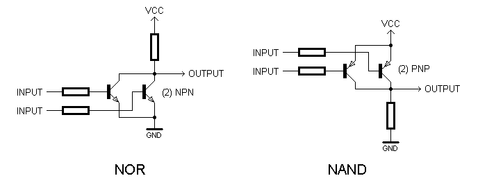

Posts: 3526
I'm having a hard time picturing what you mean. The gates I imagine look like the ones below. But 2n2222 is an NPN, and the gate using NPN's is a NOR, not a NAND. I'm not sure why my approach seemingly doesn't match yours, but maybe the concerns about 2n2222 delay and saturation are secondary to a more basic issue.
ChaseHQ85
Posts: 38
Joined: 21 Feb 2017
Post by ChaseHQ85 »
Hey Jeff,
This is the NAND gate I used. Image
But... Great News!~ The logic gates arrived, i plugged them in, and up to 4mhz on a breadboard so far with zero issues! I couldn't get it over 350khz prior with the transistor setup. I have the RAM and VRAM set up that writes are only valid on rising edge of clock now as well. Safe to say, im on my way! I'll keep you all posted!
