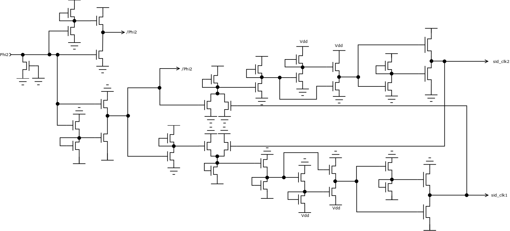

drfiemost wrote:
While checking the schematics again I noticed that some of the Phi2 and Reset signals are wrong, need to update the graphs, maybe they'll make more sense then.
Ah, (almost) got it! The /Reset line is actually tied to the reset pin while the one marked as Reset comes from the clock instead. There is a complex circuit attached to the Phi2 pin that generates two outputs, I guess it's some sort of clock divider.
Posts: 11464
Re: Understanding the SID
There's a good chance it's generator of two non-overlapping clocks: look for cross-coupled NOR gates which prevent both clocks being high at once.
drfiemost
Posts: 53
Joined: 07 Jun 2016
Post by drfiemost »
Yes, I can see the NOR gates, but there are some other things that baffle me, will post more on this later.

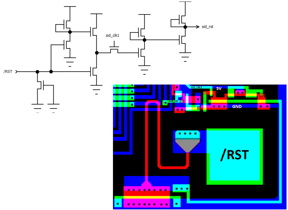

Meanwhile here comes the reset input. There's a ggNMOS for electrostatic discharge protection, then a push-pull inverter and, after a clocked gate, a couple of inverters. Not sure what this does, I'd say it regenerates and inverts the signal (the input is active low).

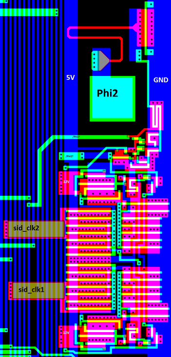

Here is the first attempt at reconstructing the clock circuitry. The transistor size is not represented in the schematic.
There are two symmetrical parts that produce two signals used to clock the digital logic of the chip, sid_clk2 which is high when phi2 is high and sid_clk1 which is high when phi2 is low. There are also some timing effects involved, as bigger transistors have longer switching times, but I don't think these are critical for the analysis so I won't get a headache over this for now. The one thing that instead puzzles me is why there are two inverters powered with Vdd at 12V while the remaining are connected to Vcc at 5V... :?
There are also two other lines driven by push-pull inverters that forward the inverted phi2 signal to the R/W and CS pins circuit and to another part of the chip which I haven't looked at yet.
Edit: updated transistor schematic
Edit2: fixed transistor schematic again
Posts: 11464
OK, so we do see the cross-coupled NORs to make non-overlapping clocks.
Looks to me from the layout - but not the schematic - that sid_clkX have both pulldowns and pullups, as you'd expect. Big transistors too, which again you'd expect for a global clock.
If there's a 12V VDD rail, it could be to help with the analogue circuitry. Or it could be an elevated rail to help drive critical signals like clocks hard - getting fast full-rail rising edges is hard in NMOS, even with depletion loads.

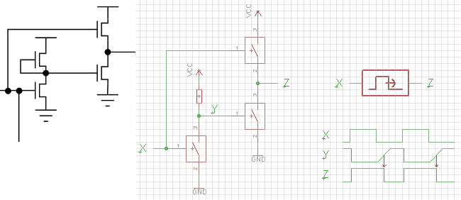

The reason why I'm asking about "normally open" and "normally closed" switches is,
that the results of my reverse_engineering attempts don't make sense to me so far.
For instance, when trying my luck with the SID_CLKx circuitry...
I assume, that this part of the circuitry is for delaying the falling edge of a signal:
Edit: deleted two schematics because they were plain wrong.
Posts: 11464
That circuit you're thinking of as a delay is called a superbuffer - usually used to drive a large capacitance, because it has better rising edge drive than a conventional buffer. Although, if it isn't driving a large load, perhaps it is there for delay??
I see four inversions after the NOR gates, two of them before taking off the clock signals and two of them after. So, logically, that's just the same as the NOR gates alone, which means the two signals will never both be high. That sounds right. Now we have to add back in the delays... and I don't know what we get.
It's also possible that the schematic as drawn isn't right!

We better assume, that some of the signal names\labels on the silicon are not too correct,
and maybe the transistor level schematics contain the one or other little bug...
this would explain quite a few things.
Also, my propagation delays in the picture above are not to scale
and most certainly wrong. :)
NMOS 6502 clock generation schematic, Beregnyei Balazs:
http://www.visual6502.org/wiki/index.ph ... _documents
Unfortunately, it's too different from the SID_CLKx logic above to be really useful now,
but when drawing transistor level schematics of the silicon,
drawing transistors in the schematics at a size which corresponds to the size
of the transistor on the silicon
suddenly is starting to make sense to me...
