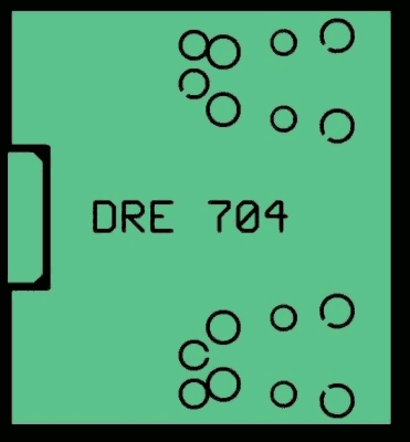

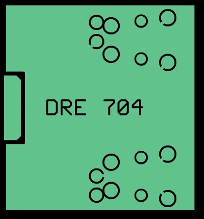

- Attachments
- 704TopCopper.png (7.16 KiB) Viewed 1038 times

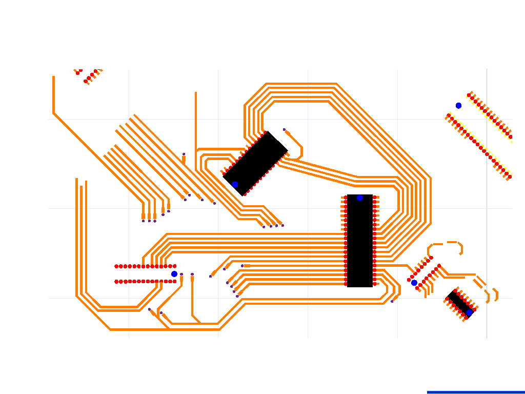

Moving on to the topic of my "6502 madness", I will post, below this post, the PCB plan, so far. You have my permission to laugh, as I have broken every rule that I know I shouldn't break (very similar to my "9-image-sensor" project, a few years ago). My goals, as always, are (1) construct something that MIGHT work, (2) if it doesn't, try to get it to work and (3) if it still doesn't work, admire it as art, and finally (4) learn something.

Thanks, all, for the info regarding images and lossy formats. It isn't too often that I ruin an image by not paying attention to "platform portabilty" and file format, but it sure stinks when I do mess things up.
My CAD program is difficult. I am using some "off-the-shelf", Big-Lots/Walmart/Staples/Big-Box-Store, 15$ CAD program; like the same kind they sell to amateur architects, and high school art students (i.e. people who don't know any better and/or can't afford professional tools). The file format choices all stink!
I think I got some good images out, once, but can't quite remember how? Also, I remember forgetting how to do this, once before, and I remember resorting to "screen shots" (i.e. ctrl + "print screen" button) of small portions of the board, copy + paste + save, to bmp, in "windows paintbrush", and then, stitching them all together, like they were some kind of quilt. Pain in the butt!!! But it worked.
If I have to, I will resort to the same, this time around. I am like 70% done with the board. All that is left is the mystery pins, the optional mem. extension (I forgot already is 32MB max address space of 65816? don't answer that? I will look it up again; check my memory map again?), ground and power pins (should have done it first; I even read Garth's primer and ignored the advice to do a "star arrangement"), the OE's, CEs' and WEs, and the 6522 (which I have zero idea how to use!).
Anybody know if I left too much room for input-output? (24KB RAM; 16KB I/O ; 24KB ROM)? Is such a memory map foolish? I thought I would keep it simple; $0000-$5FFF RAM ; $6000-$9FFF I/O ; $A000-$FFFF ROM). Seems reasonable?
So, I definitely need advice on this one question; where do the 65816 address pins attach to the 6522? I mean, they have to, don't they?
(you'll note that, despite the advice I got on the first day I posted here, I am "trying to build/fly a 747, before I've even tried a piper/Cessna/etc.).
Now, the only thing I know for sure about my I/O applications is that they need to be I2C (for my previous Kodak image sensor (9 QTY) focal plane array). But, since that part is discontinued, and other image sensors are both (1) better and (2) cheaper, now, it seems the old project might never function. But, a new FPA project, might be in order! I assume I2C is something of an industry standard, but perhaps, I'll keep an open mind (CCDs used to be the "gold standard" and some scientific applications consider CCDs best... it might be changing though.... I am "out of the loop" ...).
Unfortunately, I am just one person; not like NASA, who gets a team of people to design their FPAs! download/file.php?id=2961&mode=view
Well, so I guess I'll post the PCB (low res, though they are!) pics and offer one parting comment. I am thinking of a ground plane, but I am sure I didn't quite understand Garth's primer discussion of it. I only have a two layer PCB (no internal vias, or multilayer stack) and, though I have some colloidal silver + carbon/graphite solution (for plated through holes), you will be able to see in the pictures little blue-black dots that are the drill holes. I will just snake a jumper wire through and solder to pads on either side. (maybe, if this type of board is unacceptable, I can alter the pattern and try a second time; the second time, I can try my hand at plated through holes. Somebody told me they were tough to do, because of burrs on inside of drill holes, and etc. I can do a plating bath. That shouldn't be too tough!).

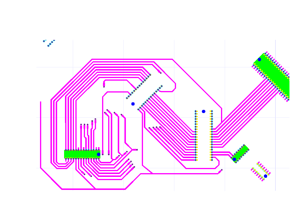

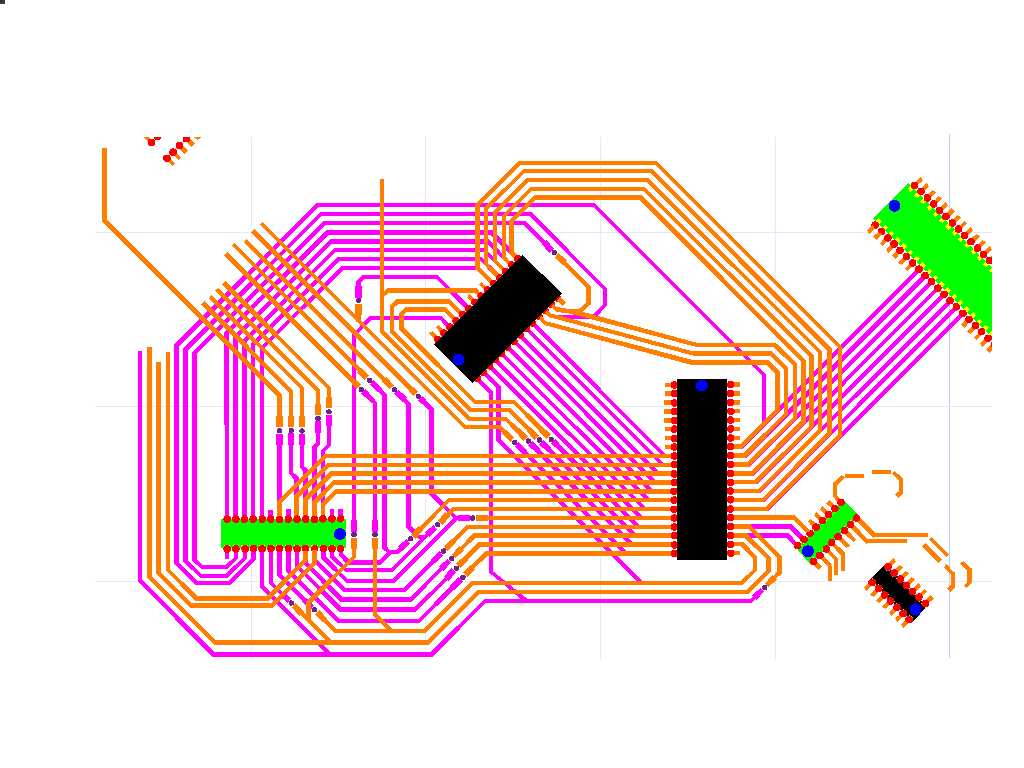

Whoops; a glitch on my CAD program tends to freeze the program if I label things with letters and numbers. So, no labels on the chips. Sorry; here they are; 65816, (black) front and center (i.e. off-center).
Bottom left green (Cypress) 65256 RAM; Top Left (a few red pin holes/rings) memory expansion socket; ROM (black chip) diagonal Top/Center; Green (slanted, top right) 6522; and bottom right is the 74HC138 (green) and the 74HC11 (3-input AND).
Oh yeah, no reset circuit yet, and no clock yet. Unfortunately, the board is about 11 inches by 6 inches (I think? I forget?). I was hoping for more compact and fewer "jumpers".
Maybe I'll put the pin diagrams up later; if you are a glutton for punishment, you can "check my work". Certainly, the decode circuit will need an extra set of eyes.
Thanks and Cheers!
(If you see " a train wreck" developing, feel free to set me straight (I am stubborn about doing things my own way, but also very yielding to wisdom and experience. The latter is especially true, when I have already tried--and failed--once or twice!).)

Have gotten deeply involved in the PCB design.
Still don't know how to implement power planes or ground planes. I just put one of each, one or two inches square, every few inches on the board (skirting the edges of the board; some unfortunate cases involve long traces--2 inches or more--running close to the planes; maybe bad?). Can't remember if my two-sided copper board should have a power plane on the opposite side of a ground plane, or if it is better to keep ground planes opposite ground planes? Any advice?
Still looking for my book about PCB design; library is a mess. Maybe try the internet for a pdf book on the subject?

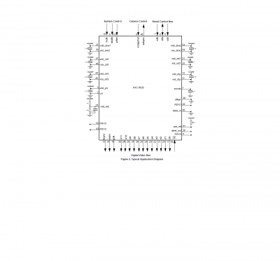

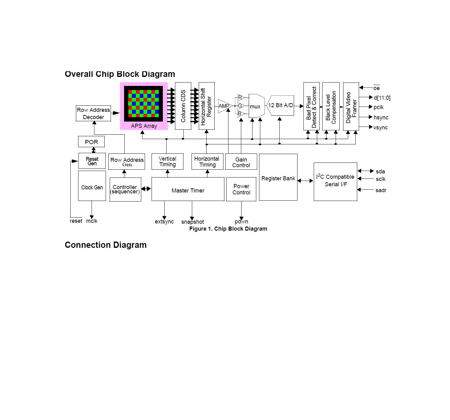

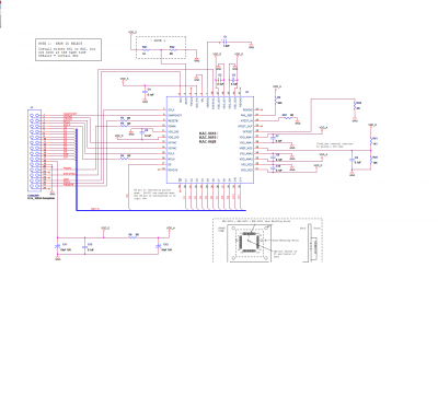

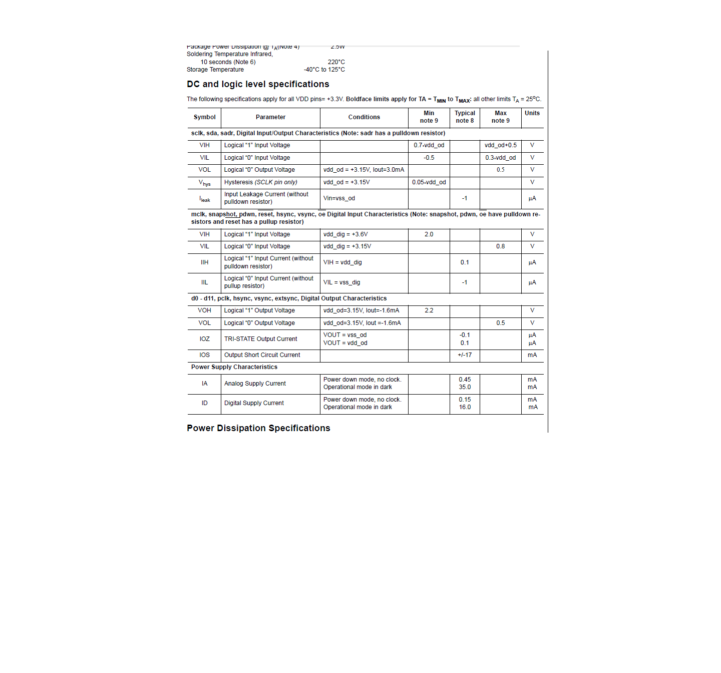

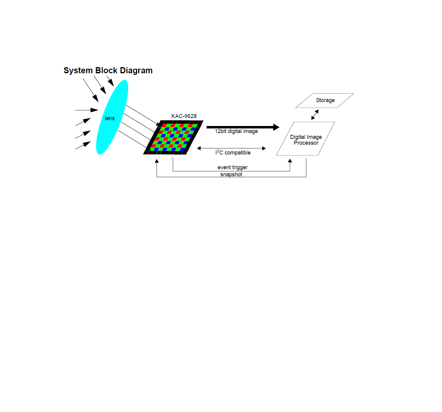

Have been thinking seriously about my 7 (9?) QTY , KAC-9628, kodak image sensor project. 300 kp (approx. VGA), 30 fps, (8, 10 or 12 bit) digital video output, with I2C bus control and programming. I have a printout somewhere; but library a mess! Maybe I'll print out the ten pages or so of "timing specs" and "video-mode operation; slave and master modes" section. That way, I can read and mark and note-take, at will.
Unfortunately, these sensors run at 3.3 v, which maybe isn't such a bad thing, EXCEPT, the digital output is then 3V too (more like 2.2 V to 3.15 Volts; and 0 to 0.5 volts low). Also, clock max is 48 MHz (25 MhZ normal) and 12 MHz min.. I guess that is OK, since the 65816 can clock as high as 14 MHz (at 5.5 V).
Hey! maybe I could run the '816 at 3 volts? But then the RAM/ROM and everything else might be wrong? I dunno? I should stick to 5V for 65816 and etc....KAC project will run at 3.3 and I will look for solution to lower logic levels? Maybe buffers? Maybe register-chips? register/latch? Maybe a RAM that accepts 3V levels and outputs 5v levels?
Maybe I'll check the 65C22 specs? Do they allow 3 volt inputs and give 5 volt outputs to the '816?
Oh well... too much speculation for Friday night. I will go home, make dinner, watch movie, and study til I sleep!

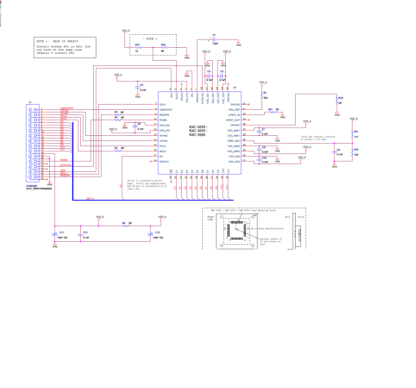

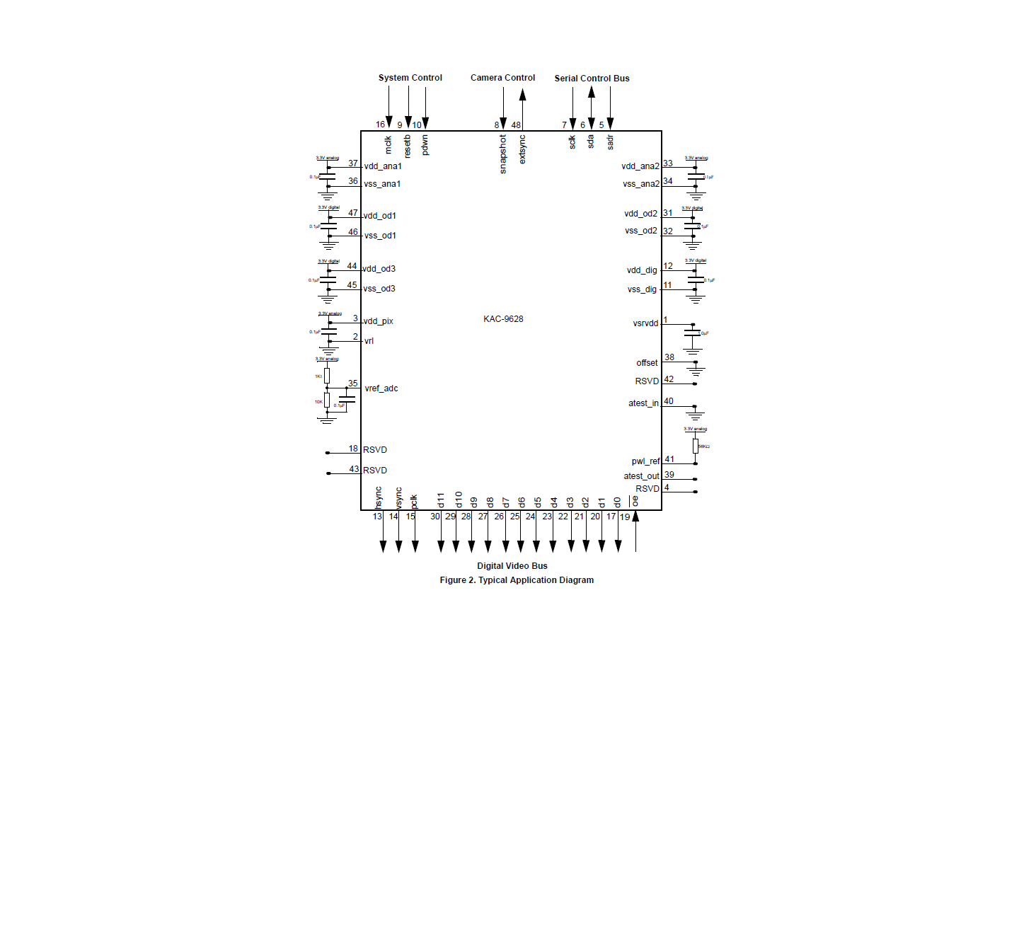

Here are a few schematics, for posterity's sake!

Re: An actual project for a newbie biologist

Right now, on the schematic, both my RAM and ROM have OE/ tied to low, i.e. GND plane. I think that is right, since WE/ is tied to the RWB pin on the 65816, and when it swings high, my RAM/ROM chip decides to listen to WE/ and CS/ and ignore the OE/ pin (level).
I've been having some trouble following your posts, but gather that you are designing with the 65C816 in mind. The '816 is not as tolerant of haphazard bus management as is the 65C02. In particular, you have to be constantly aware of the use of the data bus to emit the bank address, which occurs when !Ø2 && (VDA || VPA) is true. If your RAM or ROM has its /OE permanently tied low and the '816 is in a read cycle (RWB is high), the RAM or ROM when selected will drive the data bus. If that happens while Ø2 is low (!Ø2), your device and the '816 will be simultaneously driving the data bus, the former with who-knows-what and the latter with the bank address. There's no telling how your circuit will behave in such a case.
