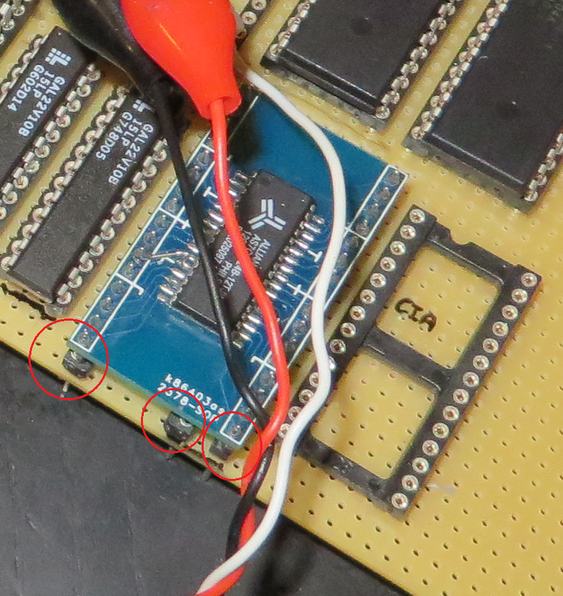

Now that is quite tempting :). I've used an adapter for the first time going from SOJ32 to DIP for my 10ns memory and that's worked well. Given that, I might consider this as I hate to pay so much for WW sockets as those PLCC ones.

Talking about your SOJ32 to DIP conversion, you are aware that there are various 128kbyte Cache SRAMs still available in DIP, e.g. the DIP version of your AS7C1024 exists as AS7C1024-20TPC (thin plastic case a 300mil 32-DIP) or as AS7C1024-15PC (plastic case a 400mil 32-DIP) and there is also the IS61C1024-15N (300mil 32-DIP).

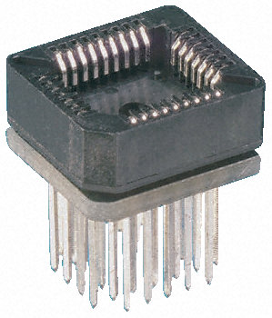

Here's a source of WW PLCC sockets that Ed pointed out a couple of years ago:
http://uk.rs-online.com/web/c/connector ... LCC+socket

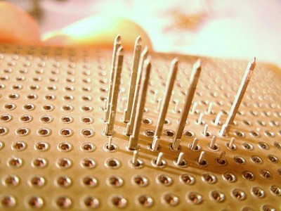

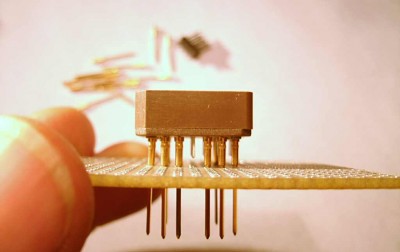

Two alternative ways to wire-wrap PLCCs are described here. The option using plain pins (lower photo) is remarkably inexpensive.
wire-wrap PLCC with machined pins.JPG (17.85 KiB) Viewed 2219 times
wire-wrap PLCC with plain pins (bottom).JPG (38.04 KiB) Viewed 2219 times

I'd never used an adapter before so used it as an excuse to buy the parts and solder them together. The RAM socket on my board can take both the standard DIP width RAM and the wider adapter that I've created:
Also, the AS7C1024B-12TJIN seemed the best of the bunch available at Farnell (I tacked it on to a larger order).
