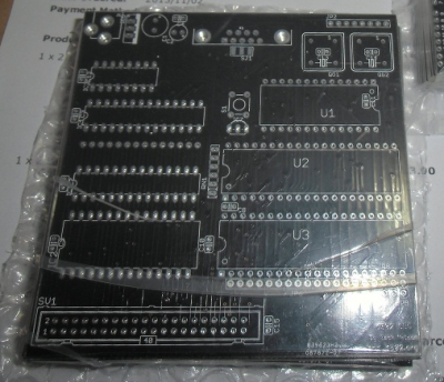

Boards are made and on their way. Pic from the manufacturer attached.

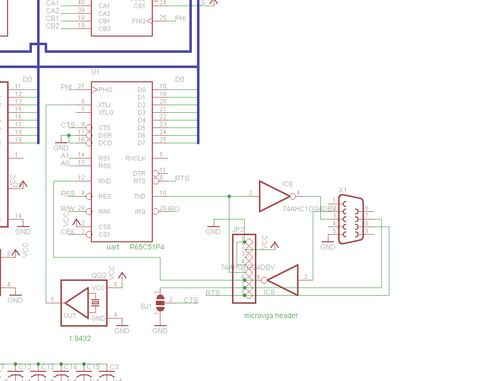

Let me restate the problem. I'm not really trying to adhere to the RS-232 standard. I want to wire the UART to the db9 connector so that I can hook up an FTDI chip + level shifter cable. My understanding is that the signals need to be inverted between the UART and the connector. I'm using MC74HC1G04 inverters to do this. The problem is, the input of the inverters isn't ±7V tolerant. It is -.5 to +5v tolerant. My question is: How do I get the RS232 signals within this tolerance?
Re: First SBC design, need a second set of eyes
After reviewing where we had been on this topic, I'm still not sure I know exactly what you want to do. One of the things the RS-232 standard specifies is the high signal voltages and semi-low load impedances; but since some people have not needed the extra noise immunity the high voltages can bring under certain conditions, they have gone without the line drivers and receivers. When they do that, it is no longer truly RS-232; but that's ok as long as a real RS-232 line driver is not accidentally connected which would damage the receiving end. The SP213ECA you referenced further up puts out the higher voltages. If you want to go with 0-5V only, then it would be better to omit that (or any RS-232) line driver/receiver, instead of using it and adding protection diodes. If you still need the same polarities for some reason (keeping in mind that RS-232 line drivers and receivers invert the signal), a simple inverter will do; otherwise you might be able to eliminate that too, as long as static discharge won't be damaging the UARTs whose signals get hard-wired to the connectors. I believe FTDI makes USB/RS-232 interface converters with and without line drivers. In have not looked at the details of all of them to know if the ones without the line drivers/receivers invert the signals or not.

To clarify I've added the schematic of the serial circuit. I want to connect this to a device similar to this
So the idea is to have TTL level serial, but make the board RS232 level tolerant.
If that doesn't make sense or can't easily be done, no worries. The microvga header breaks out all of the signals and makes it easy to use adapters.
Here is an RS232 level adapter and here is a USB one.
I have that one. It puts out the high voltages.
The old 14-pin single-supply MC1489 quad line receiver apparently meets that requirement. It can handle ±30V at the input, but from the data sheet, it looks like it will work down to TTL levels.

Yeah the MC1489 would have worked if it routed, but the boards are already made. I looked for devices with the same footprint and proper tolerances, but I found nothing. If I can't slap on a few passive to fix it, I'll call it caput.
