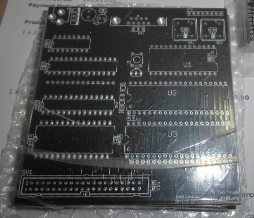

Boards are made and on their way. Pic from the manufacturer attached.
