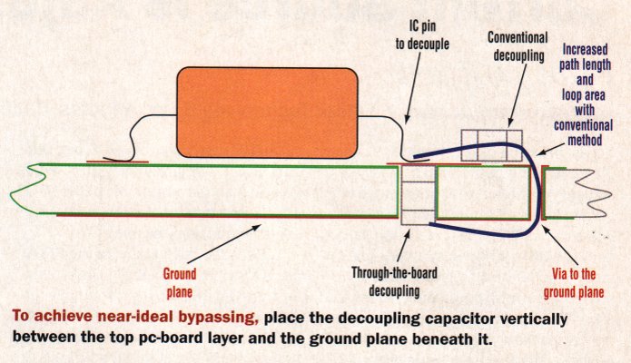

  • two-layer board's high-speed performance is maximized by unorthodox layout and bypass chip capacitors under the ICs actually embedded in the board for minimum inductance
Capacitors embedded in the board? Cool! That would be underneath an IC, then, right? I've wondered about trying something like that. Care to share the details, and a photo maybe? Sounds like you'd have to use a chisel or router to create a cavity in the PCB material...
ps- lovely job on the RAM module!
Thanks. I got the embedded-capacitor idea from page 56 of the 4/28/03 issue of Electronics Design magazine. I was going to try to describe it here, then realized I could probably find it online for you. The article is here, and the missing diagram is below. I put the chip capacitors under the ICs (right under the die) instead of in the SMT pads. I left holes with big-enough pads on both sides of the board, then instead of paying for a secondary drilling operation (which I probably should have), I drill out the via so the Vdd and ground are no longer connected by the thru-plating, then put the chip capacitor in the round hole, and solder one end of the capacitor to the top side of the board and the other end to the bottom. 0603 chip capacitors' length is almost the thickness of the board. It would be a little easier to solder if they were slightly longer, or if the board were a little thinner. It's rather labor-intensive, and since you can't see inside once you've soldered, you have to check the capacitance from Vdd to ground after each one you install, to make sure it went up by .1uF and there's no short.
Conventional decoupling (on the right) adds unwanted inductance.
Anyone who knows anything about SMT assembly can see that this method is definitely not suited for efficient automated assembly; but if you want the best performance, well...
I also thought about soldering 0402 chip capacitors to the Vdd and ground leads since they're next to each other in the middle of each side of each IC, but it's just too much work.
In Daryl's last picture above, you can kind of see where two of the capacitors are installed right near the pin header, a half-dozen pins from each end. The other four are under the ICs, each one serving the IC above and below it since there are ICs on both sides of the board. There are vias in the SMT pads, something you cannot get away with for automated assembly since it would allow a gob of solderpaste to squirt through. This is strictly for assembling by hand.

Capacitors embedded in the board? Cool! That would be underneath an IC, then, right? I've wondered about trying something like that...
That's what I thought too. That the bypass caps were underneath the IC, I almost thought about doing this in the 65Org16 devboard in order to save space on the opposite side of the board. However, it wouldn't have fit unless I modified the IC and bent the pins downward , something I would definately NOT recommend as most SMD's have very thin/delicate pins...
This is an ingenious idea though, putting the cap into a via. Only potential problem is putting too much solder into the via, but as Garth noted, check for a short circuit after soldering each and every cap.
This recent discussion has reminded me to keep distances short when planning traces for bypass caps in my project, something I've not strictly adhered to in my recent designs. I had forgotten the importance of it...
I would've liked to use this concept though I don't think I can take advantage of it on a 4 layer board, with the internal 2 layers being GND and Power.

Keep 'em short & thick.
You could probably do the same thing with a pad, which unlike a via, is not ephemeral.
Yes. Short and thick. In my designs, I tend to connect the "positive" side of the decoupling cap to Vcc (this is usually on a 4-layer board) and connect the Vcc pin(s) of the chip to the cap using a thick trace, not the power plane/layer. Hence the only path for switching noise is back to the decoupling cap, helping to minimize propagation to other board areas via the power plane/layer. If possible, I also connect the ground pin(s) of the chip to the ground side of the cap in the same fashion. I did this on my new SCSI host adapter. The 53C94 controller makes quite a bit of (electronic) racket, thanks, in part, to the 48 ma active outputs on all 18 SCSI pins. None of it is showing up in the power and ground layers.
Probably not. Drilling out the plate-through in a via or pad connected to one of the inner layers would most likely break the connection. Plus you'd run the risk of shorting the inner layers together and converting the PCB into a nice (and expensive) bookmark. :)
I seem to remember reading that two infinite parallel planes in the board have no non-mutual inductance. We can't get them infinite, but keeping parts away from the edge gets close enough. If that's the case, then putting bypass capacitors at each IC should not be necessary. There's some skin effect, but bypassing is not going to fix that. In any case, you would want the ground pins to get to ground immediately, not take an "access road" to a bypass capacitor first. The inductance to ground needs to be minimized as much as possible. If there's no power plane it will be important to get the shortest possible path from the power pins, through the bypass capacitors, to ground.
I don't think I would want to drill out a via for this in a multilayer board if there were pads on the inside layers. It's hard enough to avoid shorts as it is (although I'm getting better at installing the capacitors). Drilling out the via would leave you with .0014" (assuming 1oz copper on inside layers) rings down in the hole which unwanted solder might adhere to and be harder to remove. Just because there's a hole there however does not mean you have to have a pad there on a given inside layer if there's not supposed to be any connection on that layer at that point. Some board manufacturers automatically modify your gerber files to remove pads on inside layers where there is no connection to them.
In the case of the 53C94 (the big power-user on the host adapter assembly), all ground pins are grounded directly to the inner ground layer. It wouldn't have been practical (or wise) to tie all the ground pins back to a common point.
In any case, the inductance on a short, thick trace is negligible, in the range of a few pico-henries. I didn't originate the idea—I've seen it used quite a bit on digital designs.
