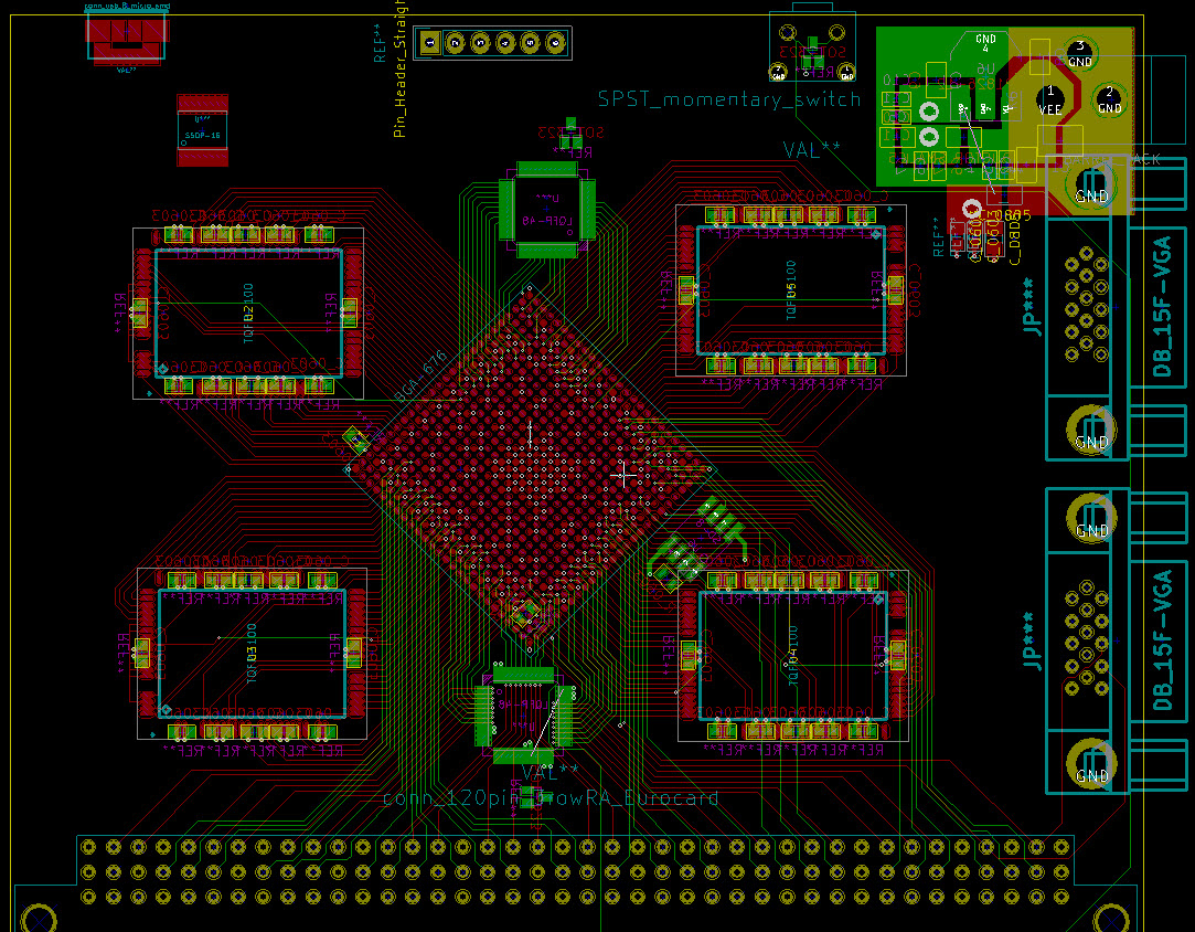

I've wanted to hold off on posting on any progress of the board layout until I felt I'd mastered at least the basics of KiCAD.
What you see in the pic is an expanded version of the original PVB project. The 6 layer board size is 4.5"Hx3.75"V with a 120-pin main connector.
I've felt it necessary to post now because as one can see, only 2 signal layers are utilized for such high speed Random Access power! I'll have to use another layer dedicated for signals for the 120-pin interconnect.
So far I have the 6 layers setup like so: FRONT/GND/SIG/VCC/VDD/BACK. VCC is 3.3V. VDD is 1.2V. FRONT/SIG/BACK are signal layers. I've yet to route on the SIG layer.
There's a Xilinx XC6SLX150-676 at the center. 4 GSITech NBT SyncRAMs surround it with all signals routed on the top layer, except for the 4 individual clock signals. The pads can support the 400MHz 2Mx18 or the 300MHz 4Mx18 NBT devices. For experimentation purposes, the FPGA also has control over whether each SyncRAM is in Flow-Thru mode or Pass-Thru mode. The individual ADV pins are also under FPGA control to aid address loading in either these modes.
2 24-bit VideoDACs in the form of 48-pin QFPs, bottom mounted, have the potential to be present as well. The VideoDAC mounted closest to the 120-pin connector is the main video out. It will utilize the bottom DBA-15 VGA connector. The second VideoDAC was wired in to aid in development if necessary. There's the potential for quad-buffering as well, so I added in the 2nd VGA connector.
The purpose of the 120-pin main connector is to route 24-bit RGB data out from the board on the top row of pins with associated HSYNC/VSYNC/PixelCLK while also accepting 24-bit RGB and associated signals on the bottom row of pins.
The middle row has I/O signals to allow for board control. It is 16-bit wide I/O data bus and 9-bit wide address bus allowing for a potential 512 video registers to be programmed on the fly from an external controller board.

Re: PVBV4 is coming into focus
Watch out for the rules on SSOs - simultaneous switching outputs. See p36 of http://www.xilinx.com/support/documenta ... /ds162.pdf
Similarly be sure you've got enough decoupling caps on the power rails. See p13 of
http://www.xilinx.com/support/documenta ... /ug393.pdf
(I mention this because of some teething problems seen on the multicoprocessor board over on stardot.)

ElEctric_EyE
- Posts: 3260
- Joined: 02 Mar 2009
- Location: OH, USA
...(I mention this because of some teething problems seen on the multicoprocessor board over on stardot.)
Also, I suspect the 1 thing which I've noticed is a real life effect of main frequency vs. noise & presence of bypass caps when you compare WW to a 4-layer board.
I for one like to toy with a lack of bypass capacitors as regards to a spec sheet. As a hobbyist and tinkerer, this is a habit I've grown with ever transitioning from using wire-wrap to 4 layer boards. I like to experiment, I'm not an engineer.
Keep in mind, when I was utilizing WW in my projects main volts was 5v and frequencies around 20MHz with discrete logic. I was religious using bypass cap's and manually soldering in copper wire for the power/GND rails on all IC's. My failures and measurements dictated that I do this for the circuit to work. BTW breadboard sucks!
When I transitioned to 4 layer boards, main volts was 3.3v and frequencies I used jumped to 100MHz+ with FPGA's. I was pushing Arlet's 6502 core and I had noticed that bypass cap's were not as critical as the hardware seemed functional...
What really was interesting in my latest failure of PVBV2 is that I noticed 1 thing: When I switched from an external 3.3v 100MHz can oscillator to a 3.3v 200Mhz can oscillator, the 1080p picture was slightly improved.
IMO this says one thing: There is a natural bypass capacitance of the powers/GND plane VIAs especially in regards to the 256-pin BGA power/GND vias under the chip and the higher speeds started to take advantage of this fact.
Maybe Garth will expound. Looking forward to it!
Early board layout and schematic: http://stardot.org.uk/forums/viewtopic. ... 780#p98780
Later layout and photos: http://stardot.org.uk/forums/viewtopic. ... 901#p99901
Front and back: http://stardot.org.uk/forums/viewtopic. ... 21#p103121
(The co-pro is the red board. The Beeb is still a popular micro and there's a whole variety of addin boards to be compatible with - both mechanically and electrically.)
nyef wrote:
Ideally, you have every signal layer next to a ground or virtual ground plane, with no other layers between them. (A "virtual" ground plane can be a power plane that is bypassed to ground in all the many right places.) For four layers, having power and ground planes together in the middle of the board is fine, but if you went to six layers, you're better off putting two signal layers on the outsides, and two more between the power and ground planes, with traces running mostly at right angles to the neighboring layer. There is a board technology that puts power and ground layers just a couple of mills apart so as to increase the capacitance between them, but as I understand it, two parallel planes have no inductance anyway, as long as you stay away from the edges, so you no longer need a bypass capacitors at every IC. I believe hi-speed digital-design guru Dr. Howard Johnson said this, and it makes sense, but I have not been able to find it again.

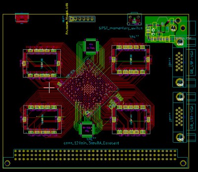

Almost time to finish the layout! I've backed the original work up and am ready to start considering what needs to be done next to start utilizing the last 'SIGNAL' layer in order to route the incoming RGBin signals to the FPGA from the bottom row of pins on the 120-pin main connector.
This part will take some consideration because although the HSYNC/VSYNC signals have been routed on the top/bottom layers for both videoDACs, the 3 RGB signals still need to be routed from the videoDACs to the VGA connectors and it cannot be done on those layers. Routing these few signals will most likely have to be done on the 'SIGNAL' layer and will cut across half of the connector. This will force me to route all RGBin traces around the left of the bottom videoDAC. Gonna be tight, but I think it's doable. I'll work on it soon.

Hello 6502.org!
I've completed a new desktop build around the 6-core Intel I7-6850K with a RAID 5 array with 3x 1GB drives for the server/backup a few months ago.
Also, I've reconsidered using KiCad. I've gotten pretty far using ExpressPCB and couldn't afford to throw money with a new process and I've been keeping track of ExpressPCB PLUS software updates. Today I got my feet wet with the current version 1.14 trying to put soldermask on top of a via and it seemed to be a success. This was the small detail that killed my PVB project as I had moved on to BGA IC's and the via rings under the BGA were exposed thereby shorting to the BGA pads during mounting.
So the project is going to change a little I think. Instead of pursuing parallel video boards, I would like to do 1 board with a header to control it. And try to move up to 4K resolution. Not sure why they went from 1080p vertical spec to 4K horizontal spec, but I guess that's progress. I see Intel is running 4K video out of their CPUs at around 330MHz IIRC, and I was running the PVB project at 300MHz, with all needed clocks divided down from it.
Plans are to use the same layout as the pic above using the same BGA 676pin Xilinx Spartan 6 and some larger syncRAM's. Will have to see what's EOL. So much EOL these days on some of this stuff.
