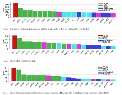

Posted: Sun Aug 14, 2011 2:14 pm
by BigEd
This topic is now the top hit for 6502 code density, so: search for a pdf titled "Code Density Concerns for New Architectures" and you should find a diagram like this:
From http://web.eece.maine.edu/~vweaver/papers/iccd09/iccd09_density.pdf
(There are more breakdowns for different elements of the benchmark - all the sources are here and there are comments on the architectures here)
(Fair use exception to copyright, of course. Credit to the authors: Vincent M. Weaver and Sally A. McKee)
Edit: replaced lost image with new screenshot
