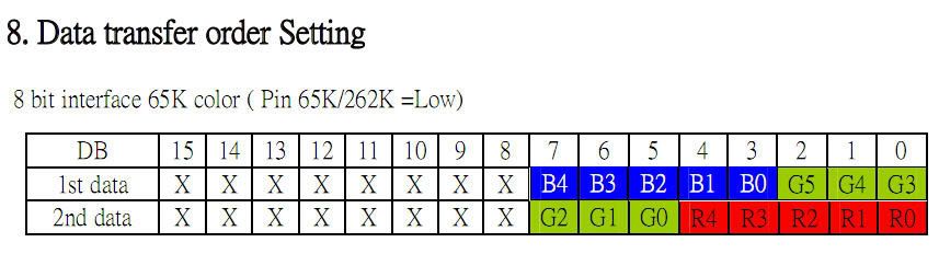

This is from the display datasheet. I think they have red and blue switched. Checking that right now...

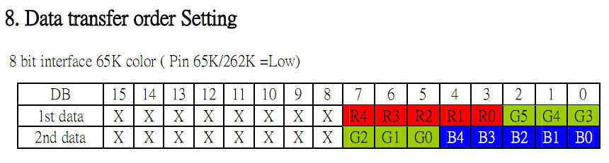

The red and blue IS switched. I know this because of the green data. The green is brightest when I send $07, $E0. Earlier, when I was having signal problems I would send $F0,$00 and get blue. But I knew data being sent was not 100% reliable, so I thought it was my circuit. Now that the signal problems are gone, I can confirm 100% the datasheet should look like this:

NHD confirms the previous posts' correction...

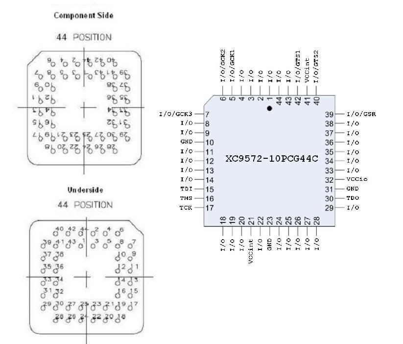

Today's time has been spent updating pinouts. When I wirewrap, I like to follow a simple datasheet. Good luck on finding one for a CPLD. Many I/O options change the layout/# of pins. So first step for me was to make this pinout of the XC9572-10PCG44C, since I'll be using the same 44-pin PLCC socket that I used for the W65C02:
Keep in mind this family (XC95xxx) of Xylinx CPLD's is JTAG programmable, and has the dedicated pins. Time to wirewrap soon...

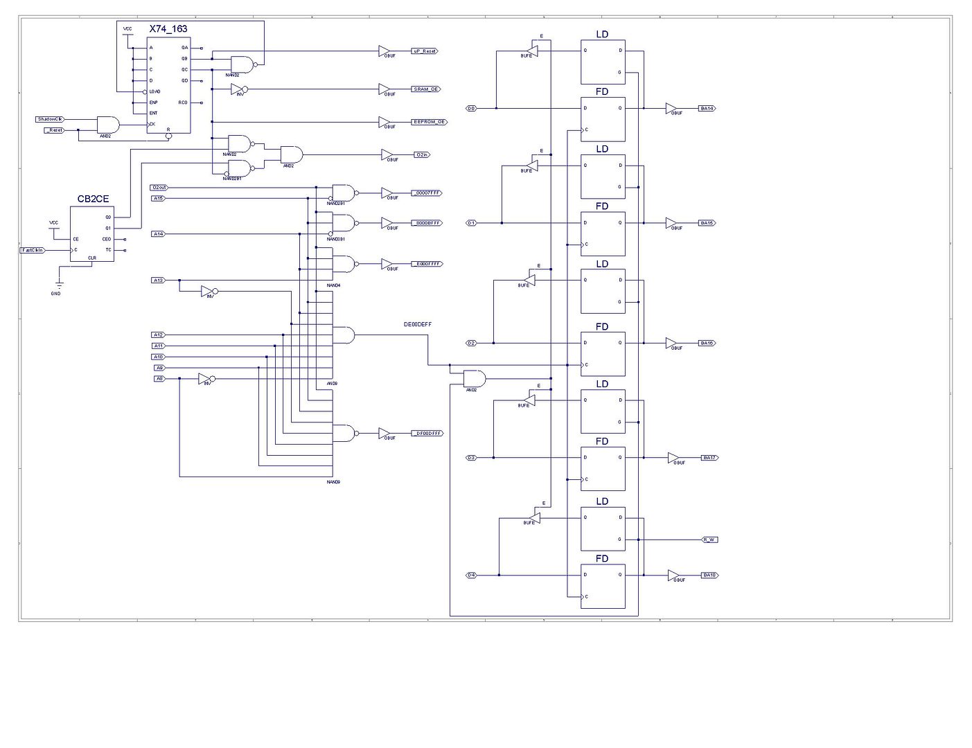

Here's a look inside the CPLD, pretty simple stuff:

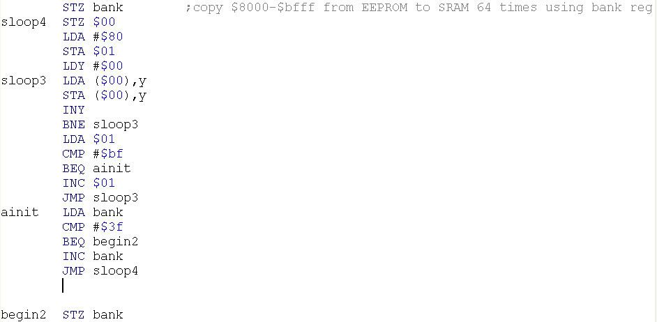

This is the software to copy the 512K EEPROM to 512 SRAM. Seems to be getting stuck here. If I comment out this part the program progresses... My mind is in hardware mode, maybe someone can help me out here. What am I missing? I'm sure it's software related...

Have you tried with code that doesn't rely on being able to read the bank register?
This should work.
      LDY   #$00        ; clear the block index
      STY   $00         ; clear the pointer low byte
      LDX   #$00        ; clear the bank number
sloop4
      STX   bank        ; set the bank
      LDA   #$80
      STA   $01         ; reset the pointer high byte
sloop3
      LDA   ($00),Y     ; copy the byte ..
      STA   ($00),Y     ; .. to RAM
      INY
      BNE   sloop3      ; loop if more bytes to copy
      INC   $01
      LDA   $01
      CMP   #$C0        ; compare it with end + 1
      BNE   sloop3      ; loop if not there yet
      INX               ; increment the bank number
      CPX   #$40        ; compare it with end + 1
      BNE   sloop4      ; loop if not there yet
begin2
      STZ   bank
Lee.

From the schematic, it looks like a write to DExx loads the upper address bytes. Is this the "bank" variable referenced in your code?
What address is this code being read from?
Is it possible that once you write the bank variable with a bank other than 0, (1 for example) that the program hangs because the PC now points to an address in bank 1 that does not contain valid program code?
Just a thought.
