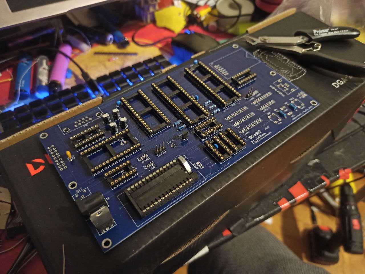

As for my PCB, I've ordered a bunch of Aries low-profile sockets (28-526-10) from Mouser, they are noticeably smaller than typical ZIF sockets, and so I was able to squeeze a mini-DIN-6 (PS/2) connector to my board, as well as some more headers, plus a socket for micro SD card adapter. The board looks much cleaner and less crammed now!

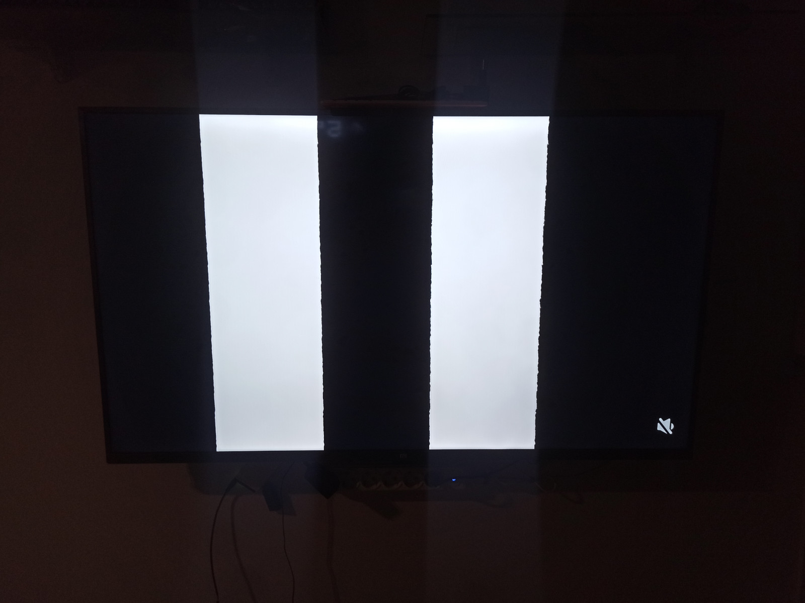

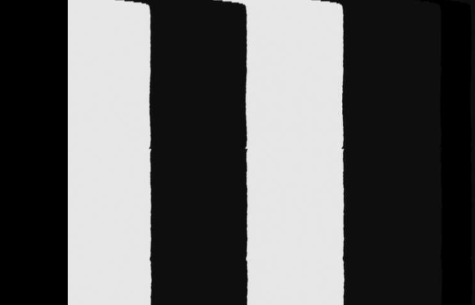

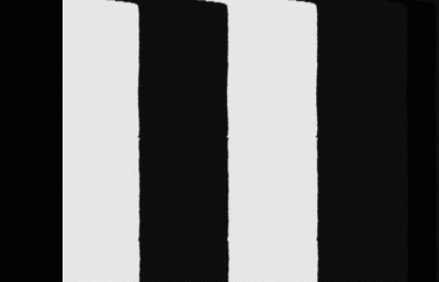

Ah, yes - animated noise
(You can see me screwing up with cycles in the beginning, as well as a jag in the middle - I'm drawing 156 lines twice, and I'm off by few cycles when drawing bottom half of the field.)

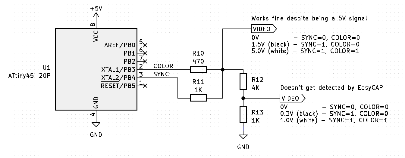

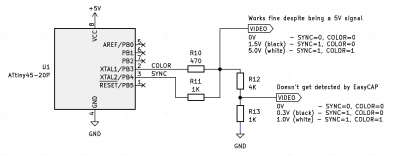

Also I'm puzzled why didn't my EasyCAP detect the image when I fed it through a voltage divider (to get 1V peak instead of 5V), but worked fine when I fed 5V directly:
Neil - that's cool, I totally forgot about VGA!

Now THIS is art! :D Yeah, composite video turned out to be really easy to do. The bigger problem for me is to nicely fit it into my system so that it can actually draw something useful! :)

EDIT: Okay, the composite signal is actually noticably better when viewed on my real TV! I've also fixed few timing issues and the edges are kinda smooth now. The top slope is gone when connecting to TV, but EasyCAP still shows it.

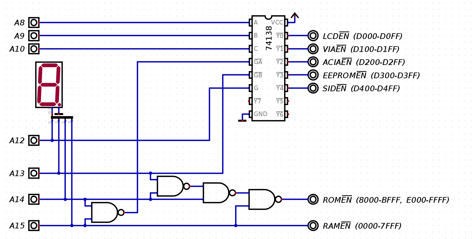

So it turns out I really don't need 48K of RAM! I'm mostly using my SBC for various software stuff as well as playing SID tunes, so 32K RAM would be perfectly fine.
I spent some time redesigning my address decoder, and it turns out that by just adding 1 extra NAND gate I can split my ROM into two segments - low (16K, $8000-$BFFF) and high (8K, $E000-$FFFF).
Main reason why I'm not placing them in a continuous segment (e. g. $A000-$FFFF) is because I want to keep my I/O at $Dxxx in order to be compatible with SID tunes (since SID has to be at $D4xx).
I can then use high 8K for reset/interrupt vectors an kernel-ish code, an lower 16K for actual "programs" (or even bank lower 16K).
I ended up requiring 7 NANDs on my first attempt, because I calculated equations for low ROM & high ROM separately as such:
LOROM/EN = NAND(A15, NAND(A14))        # $8000-$BFFF
HIROM/EN = NAND(/NAND(A15, A14), A13)  # $E000-$FFFF
# Uhh... I forgot that I need to OR the result (since I have 1 physical EPROM), and that's 3 extra NANDs...
However, after carefully re-thinking what bits need to be activated, I've actually managed to get the number of gates down to 4:
ROM/EN = LOROM/EN (10xx) || HIROM/EN (111x)
/EN = A15 && (/A14 || (A14 && A13))
/EN = NAND(A15, /A14 || /NAND(A14, A13))
/EN = NAND(A15, NAND(A14, NAND(A14, A13)))
NANDs are so magic!
'138 nicely eliminates the need of additional gates by having 3 enable inputs
So my new memory map is:
| RANGE        | TYPE  | ADDR | Notes                                    |
| $0000..$0FFF | RAM   | 0000 | /EN = A15                                |
| $1000..$1FFF | RAM   | 0001 |                                          |
| $2000..$2FFF | RAM   | 0010 |                                          |
| $3000..$3FFF | RAM   | 0011 |                                          |
| $4000..$4FFF | RAM   | 0100 |                                          |
| $5000..$5FFF | RAM   | 0101 |                                          |
| $6000..$6FFF | RAM   | 0110 |                                          |
| $7000..$7FFF | RAM   | 0111 |                                          |
| $8000..$8FFF | LOROM | 1000 | /EN = NAND(A15, NAND(A14))               |
| $9000..$9FFF | LOROM | 1001 | (Meged with HIROM)                       |
| $A000..$AFFF | LOROM | 1010 |                                          |
| $B000..$BFFF | LOROM | 1011 |                                          |
| $C000..$CFFF | N/C   | 1100 | Unused, may add extra '138 with /GA=/A13 |
| $D000..$DFFF | I/O   | 1101 | G = A12, /GA = A13, /GB = NAND(A15, A14) |
| $E000..$EFFF | HIROM | 1110 | /EN = NAND(/NAND(A15, A14), A13)         |
| $F000..$FFFF | HIROM | 1111 | (Merged with LOROM)                      |

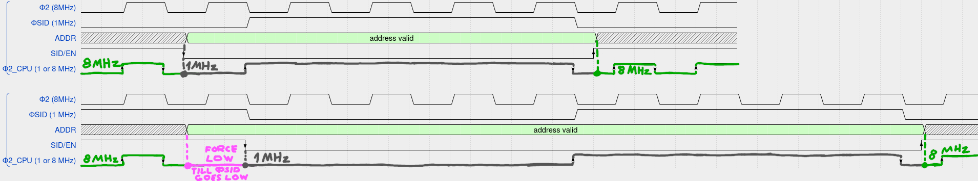

Andrew, may I ask if there is an upper CPU clock limit when using an SID IC?
Good question! I've managed to run SID on frequencies >1 MHz, but it just didn't sound right - low frequencies were inaudible and high frequencies felt too pitched. I've ditched the idea of incorporating SID for now since it requires clock stretching (I saw some articles on this forum, including some nice solutions from Jeff using a JK flip-flop).
My idea was to run SID on constant 1 MHz and underclock 65c02 when it attempts to access SID by putting it on SID's clock. This requires some trickery though, since in some edge cases the 65c02 (say, running @ 8 MHz) should wait for up to 8 whole cycles until SID's Ф2 goes low. I'm still figuring it out, will post an update if I find a nice solution!
I also have SwinSID, I think it should run at any frequency since it has its own 16MHz clock. But that offends my inner purist!

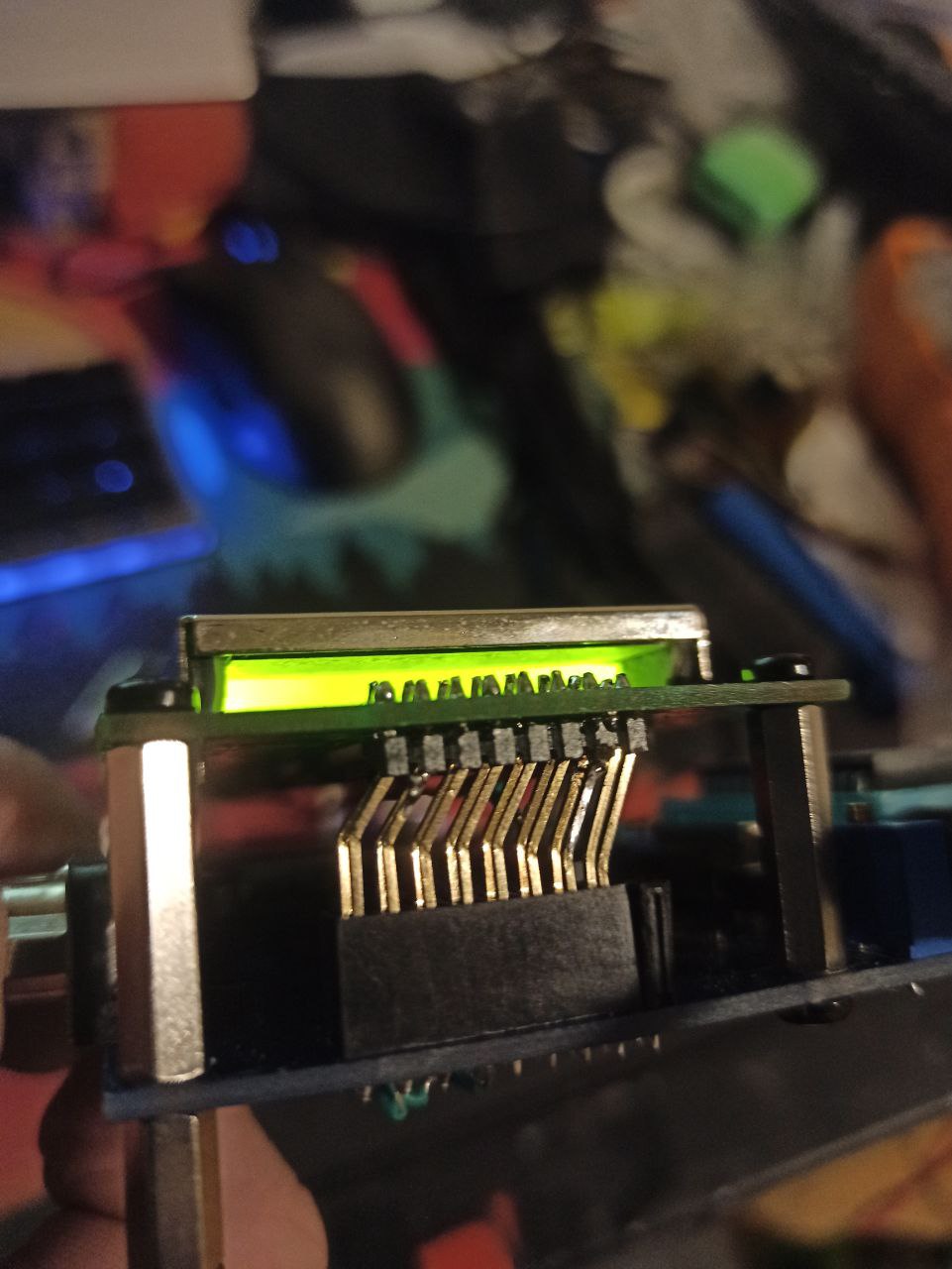

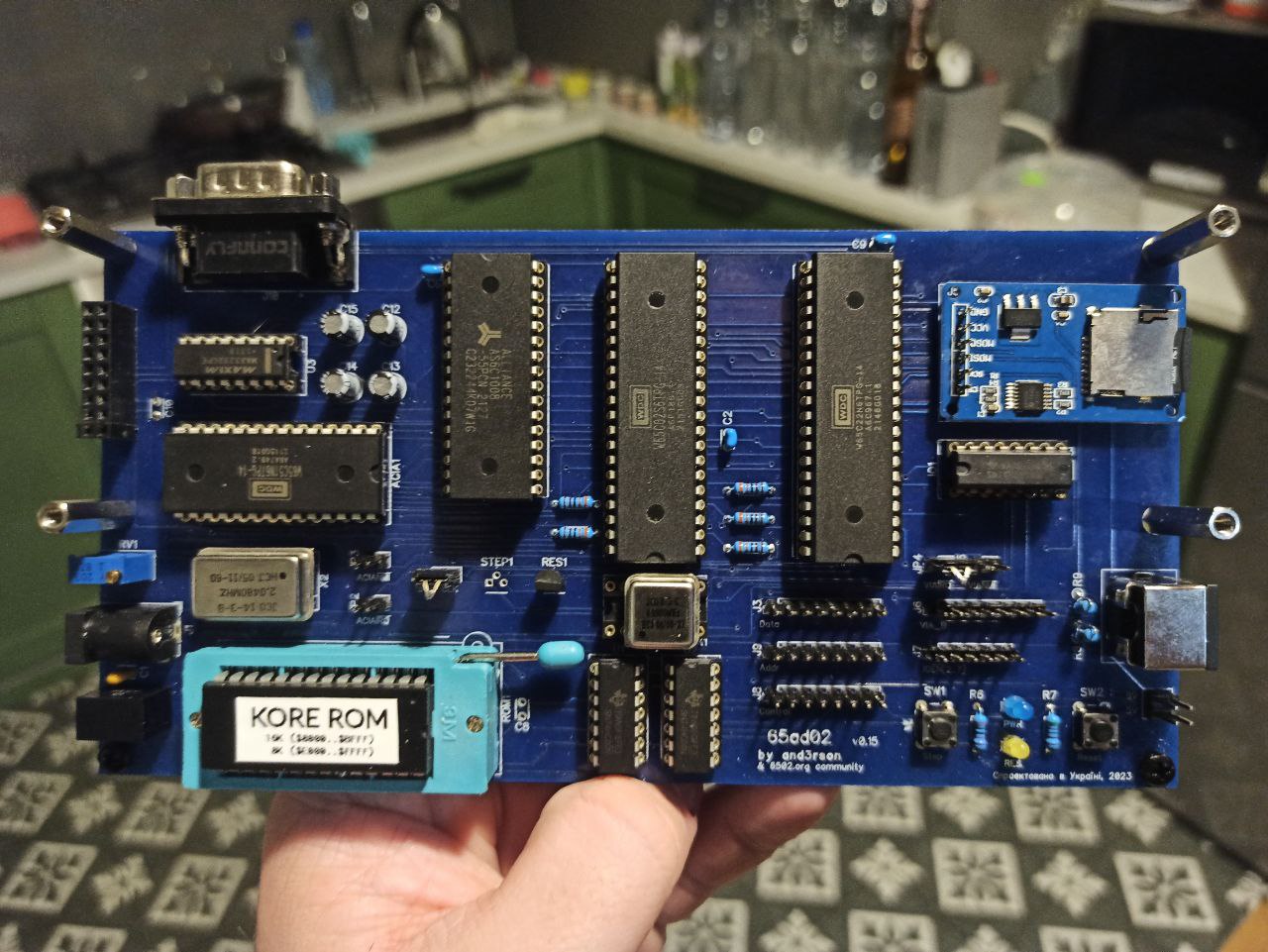

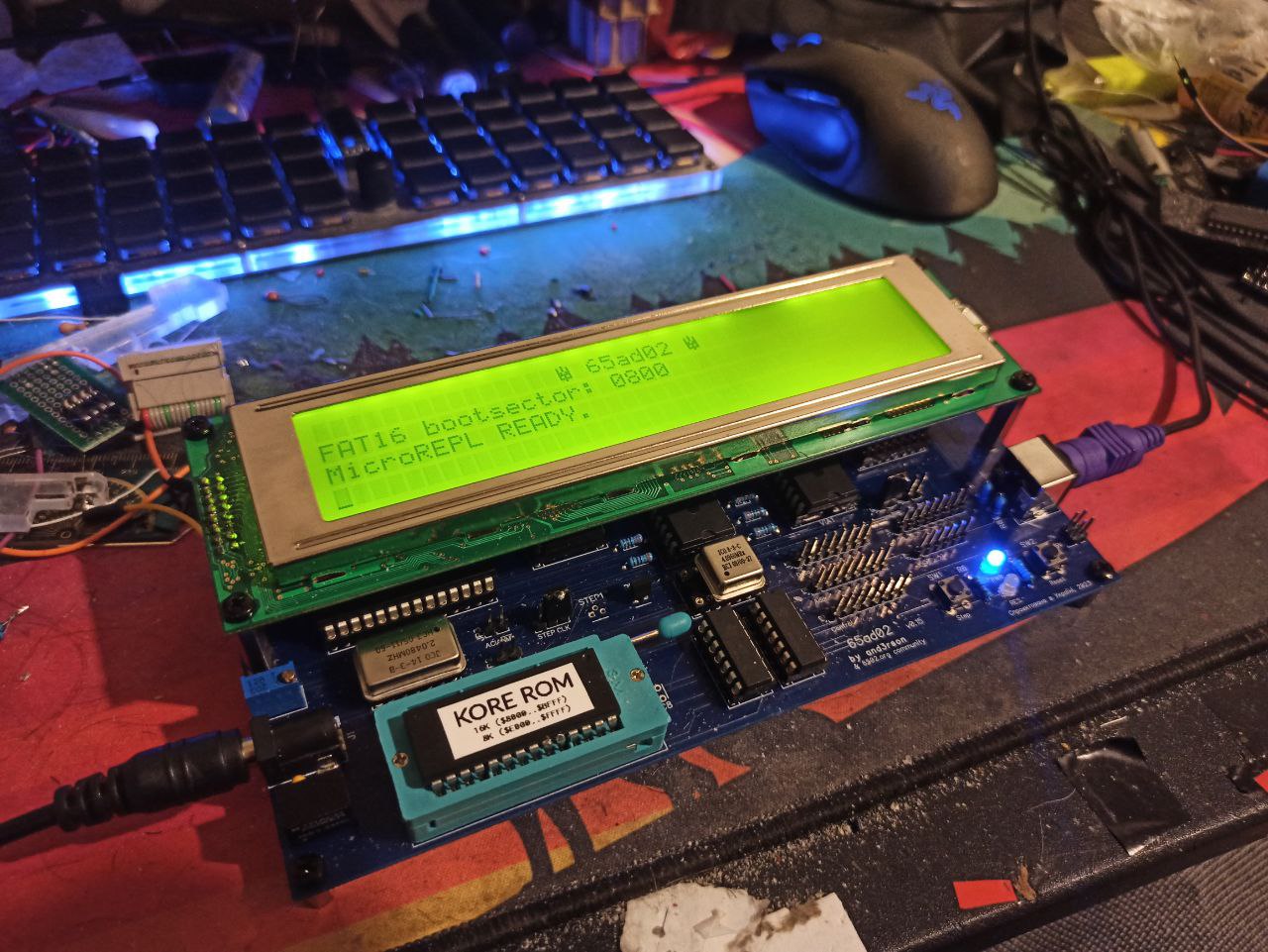

Also, I've decided that for now I'm fine with character LCD. Somehow I don't feel that much affection towards real video for now. I want to spend more time practicing my 6502 assembly. So I found a big-ass 4004 LCD (it actually seems to run 2 HD44780-compatible chips, since it has 2 EN lines, similarly to 128x64 LCD).
I totally love the look & form-factor of Tandy Model 100 & Atari Portfolio: the combination of character LCD & keyboard in one case is so cool.

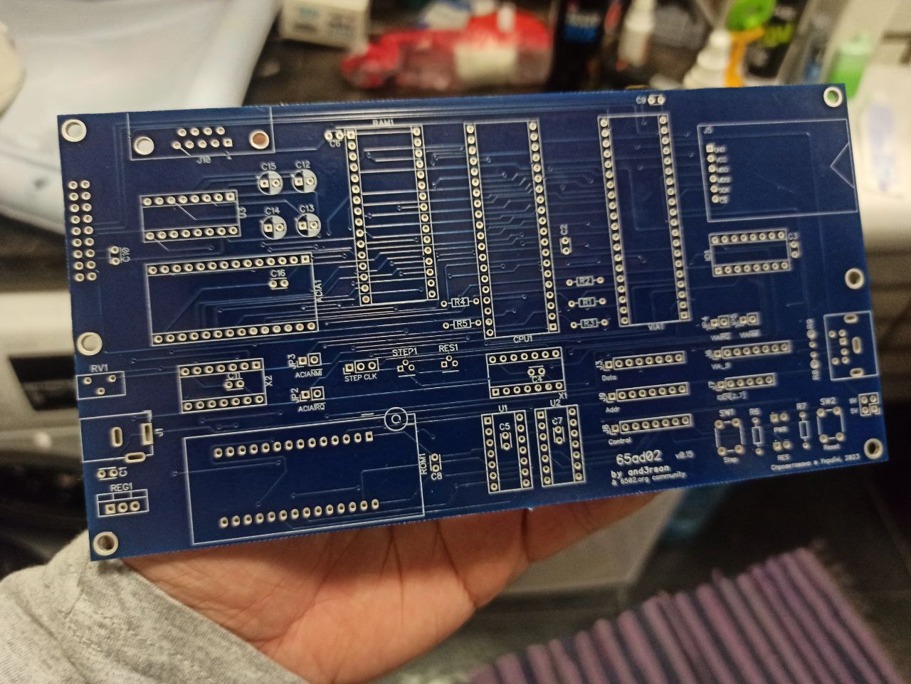

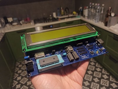

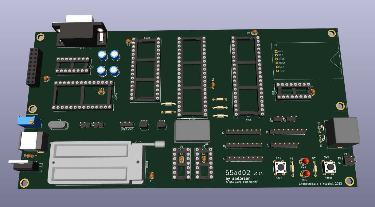

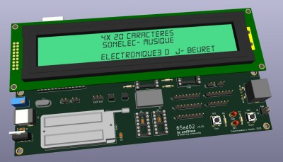

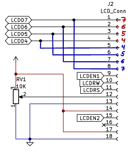

So I decided to make a new build, inspired by Tandy Model 100. I wanted to squeeze in a mechanical keyboard as well (I'm very much into them, I've built around 30 so far), but I was afraid it will end up being too bulky, so I kept a PS/2 port to use an external keyboard. Still, a built-in low-profile mech keyb with Kailh Choc switches is something I'll try out in future!
I've also made a custom footprint for it to properly align the 4004 LCD with my main board.
Finally, I've added ACIA + MAX232 and a header for external MicroSD SPI adapter.
I've increased my PCB to ~19cm*10cm and here's what I've ended up with. I love how it looks!
(The only downside is that my precious DIP chips are no longer visible!)
PCB - DipTrace rocks as usual (though ZIF socket needs minor tinkering with trace clearance):
Sandwiched screen:
I'm way over 100cm² now, but hey - L A R G E LCD!
/Andrew

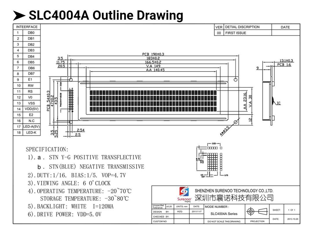

I think the new PCB looks nice, too. What are the dimensions of that LCD display? If you eventually publish the Gerbers, could the can oscillator footprint be modified to support either 'short' or 'long' versions?
About the SID chip... I wonder if the article Hardware SID Player by Dr. Nicholas FitzRoy-Dale may be of interest? BTW, this article is where I first learned about a simple microcontroller "blind interface" to 6502, 1802, Z80, etc. about ten years ago.
Regards...
Thanks for sharing! However it still looks like they run it on 1 MHz... Which is ideal for SID, but I want my CPU at 4 or even 8. Thus I'll need to find a way to put 6502 on slower SID's clock (Ф2 div 8) when it attempts to address the SID. This needs some synchronization magic though, since in some cases I'll need to delay SID/EN if Ф2-div-8 (SID clock) happens to be in high phase when 6502 wants to address it.
EDIT: Forgot to mention: the display is a big boy, measuring 190mm*54mm (~7.48"*2.13"). Here's the blueprint for it (I hope it's correct):
I also keep my gerbers & schematics posted here: https://github.com/and3rson/65ad02/tree/main/diptrace
Also, here's the footprint for Kicad that I made for it: https://github.com/and3rson/65ad02/blob ... .kicad_mod
There's also some 3D models I've found around, including the one for the 4004 LCD, too.

Oh, interesting! So is it more of a bit-banging approach, if I understand correctly? (I.e. treating chip select, r/w, data, & 5 address lines as registers)
The problem is that SID tunes (basically, all tunes from HVSC collection) are just native 6502 programs with subroutines that need to be called by main program every frame (50/60 Hz), so I don't have any control over how they access SID: they're all just machine code that directly mutates SID registers, so they need 6502 to have SID directly memory-mapped in order to play.
Thus I'm afraid that clock stretching (or rather stretching + syncing) is the only option.
Here are two possible siturations:
Ф2 is 8 MHz clock, ФSID is Ф2 divided by 8.
Ф_CPU is 6502's Ф2 input, it can be either Ф2 (normal 8 MHz operation) or ФSID (synchronized with SID's 1 MHz clock).
Here's some details on those:
  • In first situation, SID/EN can be asserted instantly when SID address becomes valid, since ФSID is low, so we can just kick 6502 from Ф2 onto ФSID (1 MHz). When ФSID goes low, we've finished reading/writing, so we can put 6502 back * onto Ф2 (8 MHz).
  • In second situation, address is valid, but ФSID is still high, so we must wait for it to go low (to prevent accidental writes mid-high-phase) and only then assert SID/EN. Then the process continues as in the previous flow.
I *think* I can consider this process as a state machine and add some flip-flops & NANDs to do all of the transitions in an over-engineered fashion (since my knowledge of discrete logic is currently limited by simple logic gates, RS flip-flops, and basic stuff like '138/'273), so I'm pretty sure Jeff will then come and tell me that it all can be done with a single JK flip-flop :mrgreen:
I'll give it a try anyway!

V15 board assembly
While waiting for 4004 LCD from AliExpress, I was lucky to find a used one at local bulletin board for ~5 USD. So now I had everything I needed for a final assembly! Here's what it turned out like.
I've ordered a new board from my local vendor. This one cost me ~30 USD and took 3 days to make, and as I mentioned - it's a 15-minute drive from my home, so I'm really lucky. The blue silk screen looks so much nicer than the previous green one:
I'm a sucker for those pristine looks of a fresh PCB with basic sockets soldered:
Soldering finished, taking one last look on those beautiful chips before I hide them beneath the LCD:
All done, trying to pose the board with some better lighting (I suck at taking photos):
And - done. BIG SCREEN!
As you may have noticed - I eventually ditched the Aries low-profile ZIF socket in favor of a standard bulky ZIF. Main reason - Aries has a really nice hi-tech look and is extra-small, which is great for PCBs with limited space. However it's painfully inconvenient to use, especially when constantly re-flashing my EPROM, and also makes it much easier to misplace a chip and bend some legs. Standard ZIF, on the other hand, is much more convenient: I simply throw the chip on it, and it always lands perfectly.
Those damn Chinese "standards"
I had to use taller standoffs (~0.8") since the pinout of LCD I have doesn't match the one I'm still waiting for. So I had to bend the legs as such:
This stole around 0.4" of space, but hey - I'm good with it for now. I still think I can go down to 0.4" with a properly matching LCD footprint.
Another pain was LCD pins: some 4004 LCDs have 18 pins, and some have 16 (backlight power is on the opposite side of the LCD PCB, as seen in my photos above).
What's even worse - some Chinese LCDs have pins 1-8 correspond to D0..D7, and some - to D7..D0. This is absolutely terrible.
Luckily, all other pins match. So here's where 4-bit LCD interface shines: I can simply connect pins 1-4 to pins 8-5! Since I had only half of data lines connected (obviously, the wrong half), all I had to do was to add some jumpers to mitigate this:
This way the socket will handle any ordering, so I can buy all the LCDs (unless the manufacturers mess things up even more!)
