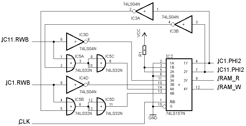

Yes and no. When two devices use alternate clock phases to "take turns" accessing shared RAM one does need to pay attention to how it's done. But a CPU sharing with a CRT controller is much the same as a CPU sharing with another CPU.
Bottom line: you mustn't allow the RAM's /WE input to go low immediately when one device's turn ends and the other device's turn begins. There needs to be a bit of delay (address setup time) before /WE is allowed to go low. And familiar designs using a CPU and a CRT controller already successfully manage this.
I'm just remembering... back in 2016, there was a forum thread about something like two 6502 chips sharing a bus, where that sort of topic had showed up.
My suggestion for clock generation and R/W# had looked like this:
//It was just a theoretical idea. Not tested with real hardware. Might still need some tweaking etc.
Hmm.
But before we start with writing the specifications for a multiprocessor 6502 gaming system,
I think we should wait until and3rson has decided what he actually _wants_ to build... ;) :)

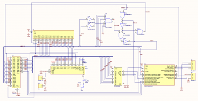

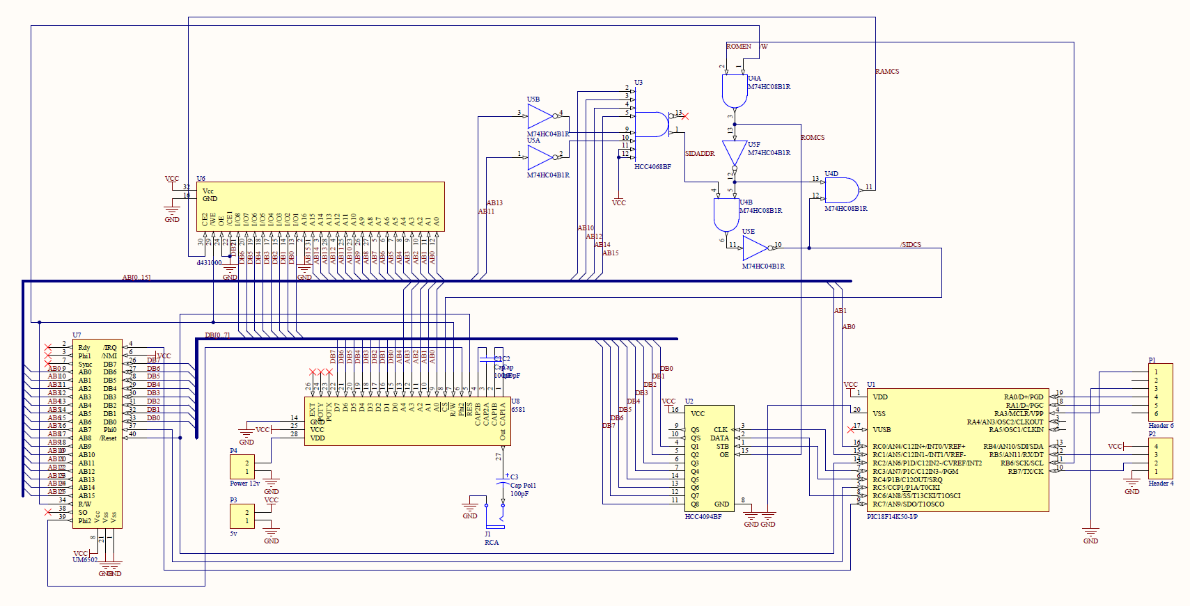

So it turns out I really don't need 48K of RAM! I'm mostly using my SBC for various software stuff as well as playing SID tunes, so 32K RAM would be perfectly fine.
I spent some time redesigning my address decoder, and it turns out that by just adding 1 extra NAND gate I can split my ROM into two segments - low (16K, $8000-$BFFF) and high (8K, $E000-$FFFF).
Main reason why I'm not placing them in a continuous segment (e. g. $A000-$FFFF) is because I want to keep my I/O at $Dxxx in order to be compatible with SID tunes (since SID has to be at $D4xx).
I can then use high 8K for reset/interrupt vectors an kernel-ish code, an lower 16K for actual "programs" (or even bank lower 16K).
I ended up requiring 7 NANDs on my first attempt, because I calculated equations for low ROM & high ROM separately as such:
LOROM/EN = NAND(A15, NAND(A14))        # $8000-$BFFF
HIROM/EN = NAND(/NAND(A15, A14), A13)  # $E000-$FFFF
# Uhh... I forgot that I need to OR the result (since I have 1 physical EPROM), and that's 3 extra NANDs...
However, after carefully re-thinking what bits need to be activated, I've actually managed to get the number of gates down to 4:
ROM/EN = LOROM/EN (10xx) || HIROM/EN (111x)
/EN = A15 && (/A14 || (A14 && A13))
/EN = NAND(A15, /A14 || /NAND(A14, A13))
/EN = NAND(A15, NAND(A14, NAND(A14, A13)))
NANDs are so magic!
File comment: '138 nicely eliminates the need of additional gates by having 3 enable inputs

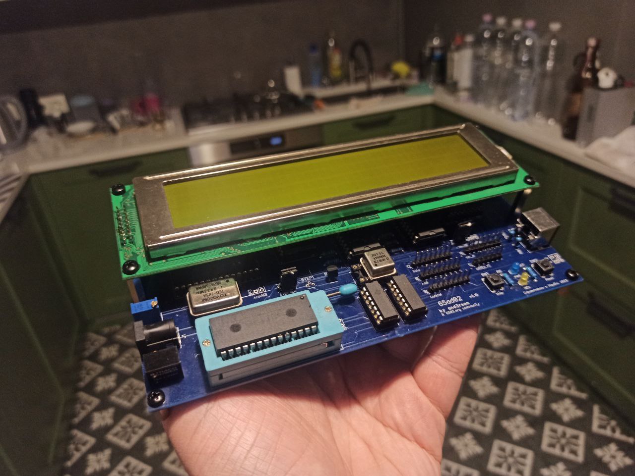

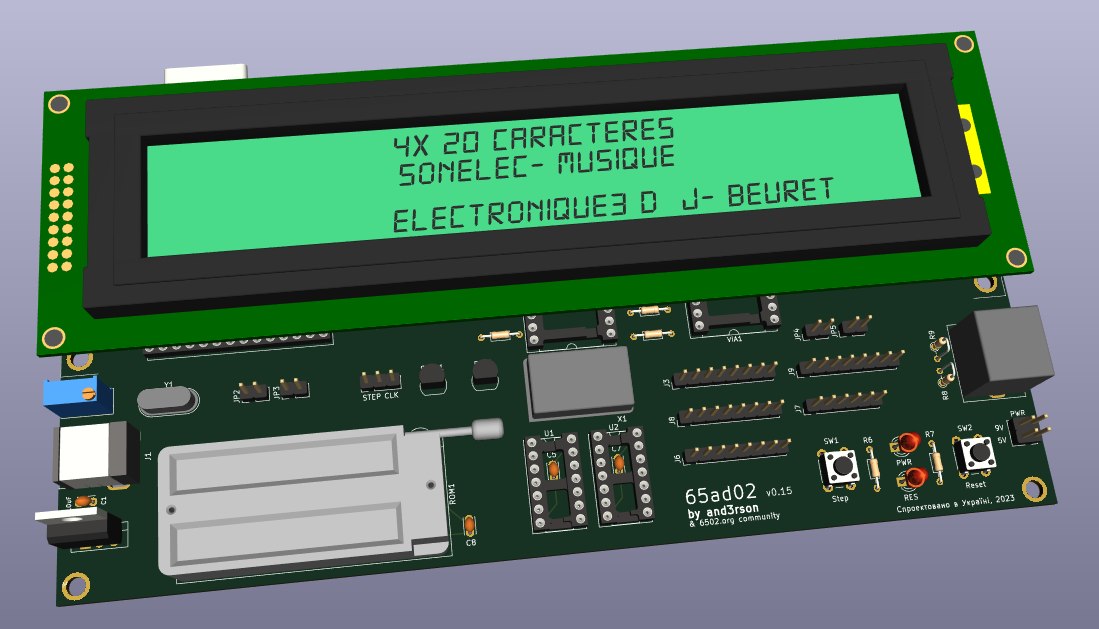

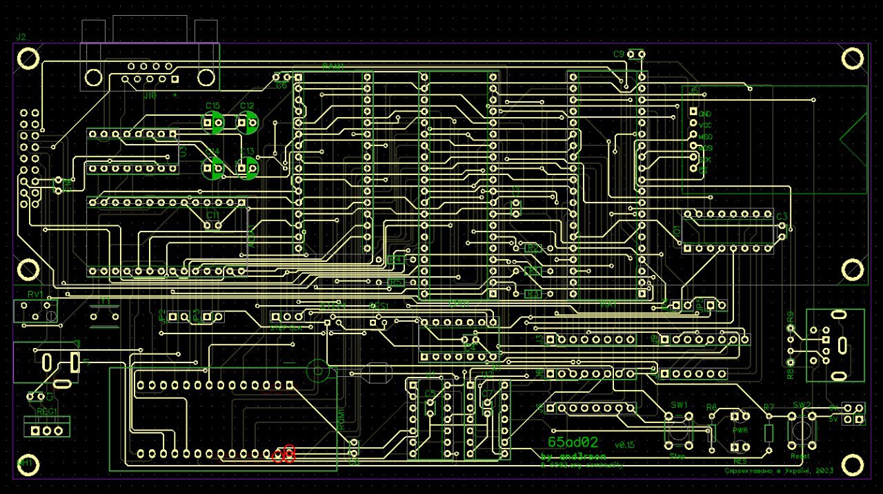

Also, I've decided that for now I'm fine with character LCD. Somehow I don't feel that much affection towards real video for now. I want to spend more time practicing my 6502 assembly. So I found a big-ass 4004 LCD (it actually seems to run 2 HD44780-compatible chips, since it has 2 EN lines, similarly to 128x64 LCD).
I totally love the look & form-factor of Tandy Model 100 & Atari Portfolio: the combination of character LCD & keyboard in one case is so cool.
So I decided to make a new build, inspired by Tandy Model 100. I wanted to squeeze in a mechanical keyboard as well (I'm very much into them, I've built around 30 so far), but I was afraid it will end up being too bulky, so I kept a PS/2 port to use an external keyboard. Still, a built-in low-profile mech keyb with Kailh Choc switches is something I'll try out in future!
I've also made a custom footprint for it to properly align the 4004 LCD with my main board.
Finally, I've added ACIA + MAX232 and a header for external MicroSD SPI adapter.
I've increased my PCB to ~19cm*10cm and here's what I've ended up with. I love how it looks!
(The only downside is that my precious DIP chips are no longer visible!)
PCB - DipTrace rocks as usual (though ZIF socket needs minor tinkering with trace clearance):
Sandwiched screen:
I'm way over 100cm² now, but hey - L A R G E LCD!
/Andrew

V15 board assembly
While waiting for 4004 LCD from AliExpress, I was lucky to find a used one at local bulletin board for ~5 USD. So now I had everything I needed for a final assembly! Here's what it turned out like.
I've ordered a new board from my local vendor. This one cost me ~30 USD and took 3 days to make, and as I mentioned - it's a 15-minute drive from my home, so I'm really lucky. The blue silk screen looks so much nicer than the previous green one:
I'm a sucker for those pristine looks of a fresh PCB with basic sockets soldered:
Soldering finished, taking one last look on those beautiful chips before I hide them beneath the LCD:
All done, trying to pose the board with some better lighting (I suck at taking photos):
And - done. BIG SCREEN!
As you may have noticed - I eventually ditched the Aries low-profile ZIF socket in favor of a standard bulky ZIF. Main reason - Aries has a really nice hi-tech look and is extra-small, which is great for PCBs with limited space. However it's painfully inconvenient to use, especially when constantly re-flashing my EPROM, and also makes it much easier to misplace a chip and bend some legs. Standard ZIF, on the other hand, is much more convenient: I simply throw the chip on it, and it always lands perfectly.
Those damn Chinese "standards"
I had to use taller standoffs (~0.8") since the pinout of LCD I have doesn't match the one I'm still waiting for. So I had to bend the legs as such:
This stole around 0.4" of space, but hey - I'm good with it for now. I still think I can go down to 0.4" with a properly matching LCD footprint.
Another pain was LCD pins: some 4004 LCDs have 18 pins, and some have 16 (backlight power is on the opposite side of the LCD PCB, as seen in my photos above).
What's even worse - some Chinese LCDs have pins 1-8 correspond to D0..D7, and some - to D7..D0. This is absolutely terrible.
Luckily, all other pins match. So here's where 4-bit LCD interface shines: I can simply connect pins 1-4 to pins 8-5! Since I had only half of data lines connected (obviously, the wrong half), all I had to do was to add some jumpers to mitigate this:
This way the socket will handle any ordering, so I can buy all the LCDs (unless the manufacturers mess things up even more!)
