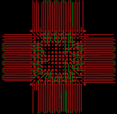

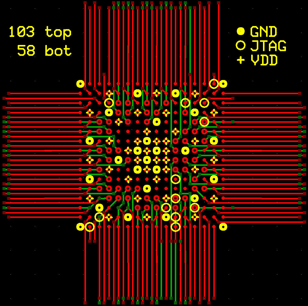

So I was working some on my BGA layout the past couple days.
This BGA soldering experiment may wind up being an absolute failure, in which case I will have to switch board manufacturers, because this is all I can do with a 4 layer board with the current design tools.
23 signal pins were wasted, i.e non-routable through the top or bottom layers. I concentrated on getting most of the GCLKs out. Most of them are on the upper right quarter of the device.
161 signals I have to work with. Could be maybe more, but I dont like using JTAG signal pins as multifunction. My current level of success I keep all JTAG pins as dedicated.
VDD pins marked in the pic below include all VCCint, VCCaux and VCCO.
I've tested this EPCB layout file, and it was accepted, so I'm not breaking any of the layout rules.
The next step is to choose and route a serial FLASH in order to program the FPGA. Also, the internal power and ground layers still need to be divided under the FPGA template.

What are the smallest drills and annular ring sizes your fab allows?
EDIT: I am confused over where the vias are

Re: Working with Xilinx BGA packages
Maybe the silkscreen makes it difficult to see. I just used it to label the pins to make it easier to check. I'll post a pic without silkscreen.
The green layer is the bottom layer. The 2 inner layers are not shown, they still need work.
