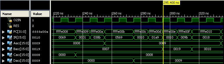

Ok, I believe I got it working!
For opcode bits [11:10] of ADC/SBC/AND/ORA/EOR the function I have looks like this:
This small chunk of assembly is working in ISim:
[11:10] FUNCTION
0: 0 original ADC/SBC/AND/ORA/EOR on 4 Acc's (as defined by bits [9:8])
0: 1 add value in operand to A Acc and store in B Acc
1: 0 add value in operand to B Acc and store in C Acc
1: 1 add value in operand to C Acc and store in D AccCode: Select all
$FFFFE0000 LDA #$07
TAB ;Transfer A Acc to B Acc
CLC
ADC #$01
TAC ;Transfer A Acc to C Acc
ADC #$01
TAD ;Transfer A Acc to D Acc
$FFFFE00B ADCAopBi ;Add op value to A Acc, store in B Acc
.BYTE $0010
LDBi ;LDB #$10
.BYTE $0010
TBA
CLC
--code trimmed here, due to waveform end--
