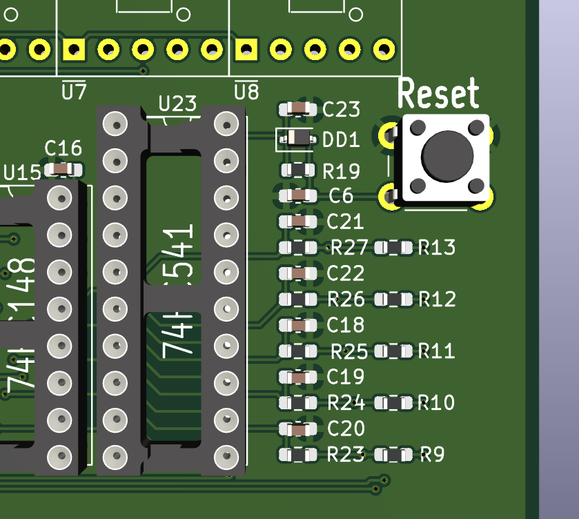

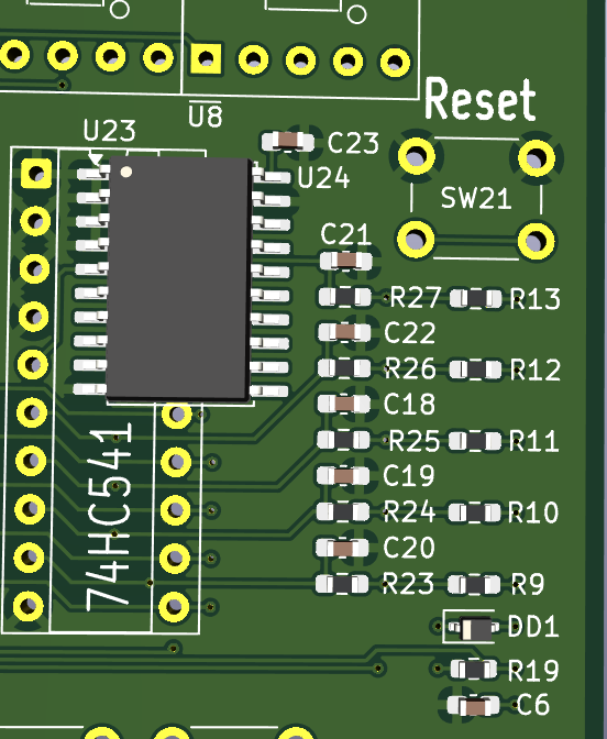

I went a bit all out on the debouncing: 2 resistors and a capacitor per switch row, feeding a '541 for the Schmitt trigger non-inverted output.
However, I want to play further and make that footprint so it will also accept a SOIC, if the TI DIP part doesn't work well.

I went a bit all out on the debouncing: 2 resistors and a capacitor per switch row, feeding a '541 for the Schmitt trigger non-inverted output. ...
In line with why the LS19-P won't work, the switch column goes live three clock cycles before the key is read, and then if there is no key the column switches before the next time the key is read ... is that enough time for the capacitor to discharge?
It may be that getting the values right for the capacitor to discharge after two or three pulses, a pulse at a time, may be plenty of time to ride out the attack bounce, and then the slower recharge guarantees riding out the release bounce. It seems like it would be something in the ratio of 16:1-20:1 between discharge speed and recharge speed, so a 5ms steady-state discharge might actually be a touch slow with discharge over roughly 1/8th of the time domain and recharge over 7/8ths while a button is pressed.
If net discharging while fully pressed, reading the key so soon into the discharge cycle would seem to give excellent debounce performance.

To work around the possibility of having to use a SOIC Nexperia part if the TI _isn't_ a Schmitt input, I've squeezed in some more PCB warnings... that way I can test both parts in situ. I'd rather keep everything except passives as through hole if possible; soldering an sm resistor is a lot simpler for a neophyte than a soic, but both are certainly doable. But through-hole sockets are a doddle. Ugly but workable. Normal 14 and 16 pin SOICs will fit inside a normal DIP footprint, but not the wide package 20 pin.
My first thought for a construction order:

Re: First thought on an interface (to use Paleolithic DROM)
Yeah, browsing around showed part of the market for direct drive Schmitt Trigger parts is the automotive industry (unsurprising that they like cleaning up high frequency noise), which isn't a market segment that helps maintains the stock of DIP packages.
I'll likely do a cycle count sometime in the next few days, to get an idea of how long the on-periods and off-periods are for the DROM code I posted if running at 1.8MHz (and see whether the asymmetry on the 1st LED column is pronounced). I have a hunch that a 6 LED cycle with a longer dwell on the first LED column might leave the 2nd-5th columns with a similar share of the time as a VIA clock tick interrupt on a steady 8 LED cycle ... though with the rotation between the columns happening at much higher frequency in the DROM code than with a proper background IRQ on a CIA clock tick.
Edit: I've looked, and the savings of two bytes by moving the led save routine out of the digit kills any chance for the capacitor to be drained on any other LED column. So I've added phy/ply back to the to_leds routine and put it back into the individual digit loop. That kills even the halfway proper backspace I had just worked out.
