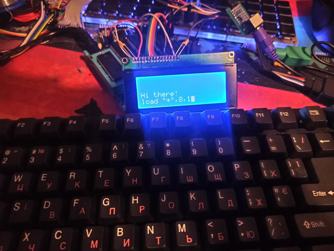

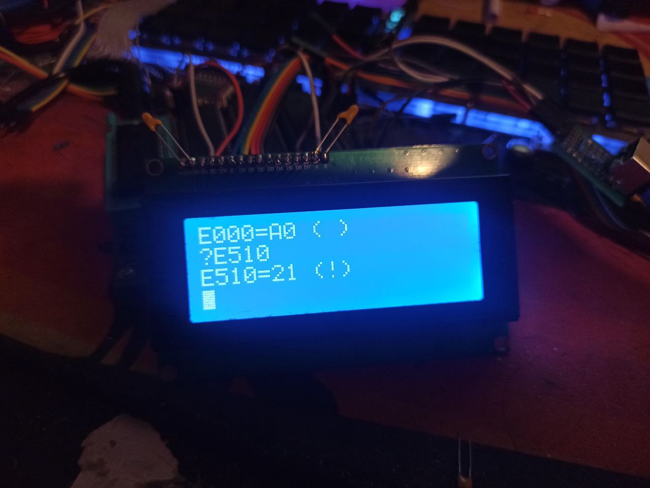

So PS/2 took me some time, but I'm really surprised how easy it was to implement, including make/break/extended scancode handling as well as shifted characters. My biggest mistake was forgetting to terminate my functions with `rts` and wondering why weird code is being called.
Also, some WDC instructions are totally awesome, including SMBx, RMBx, & STZ. ROR seems to work properly with shifting the carry bit in - I heard some myths about "bug" with it, maybe it's only relevant for some ancient 6502 NMOS revisions.
I think my PS/2 bit handling code could be slightly improving by juggling with VIA's shift register after start bit was received, but I decided to keep it simple and read all 11 bits in a bit-banging style.
Now I'll be able to do some interaction with my device. Probably the most helpful commands that I'll implement first will be reading/writing memory locations - that's gonna heavily reduce the amount of EPROM flashes!
Finally, having LOAD command to run arbitrary code from ROM or SD card in C64 format (i. e. binary that's prefixed with little-endian address specifying where to load the code) will be nice, especially for playing SID songs. I'll try to keep my code @ github updated at all times. EDIT: I've considered an option of porting one of small BASIC variants (e. g. TinyBASIC, since it's free for non-commercial use), but decided to stick with a simple 1-character-command terminal for now:

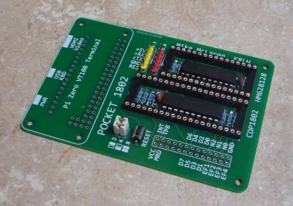

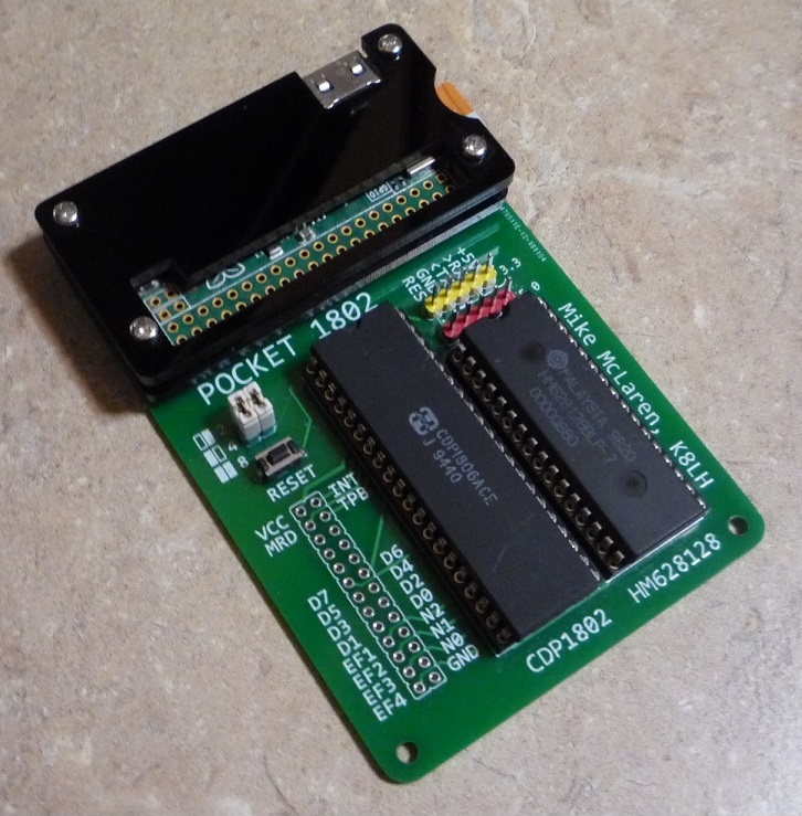

Not sure if this would be of any interest to you, but, I used a $5 Pi Zero and a fork of the PiGFX "bare metal" VT-100 Terminal Emulator software on one of my projects which produced HDMI and composite video output (I only ever tried HDMI video). I've attached a DipTrace file with the proper hole dimensions and outline for a Pi Zero if you'd like to take a peek. Geoff Graham's ASCII Video Terminal also produces composite (and VGA) video output.
- Attachments
- Pocket 1802 v3.zip
- (15.62 KiB) Downloaded 181 times

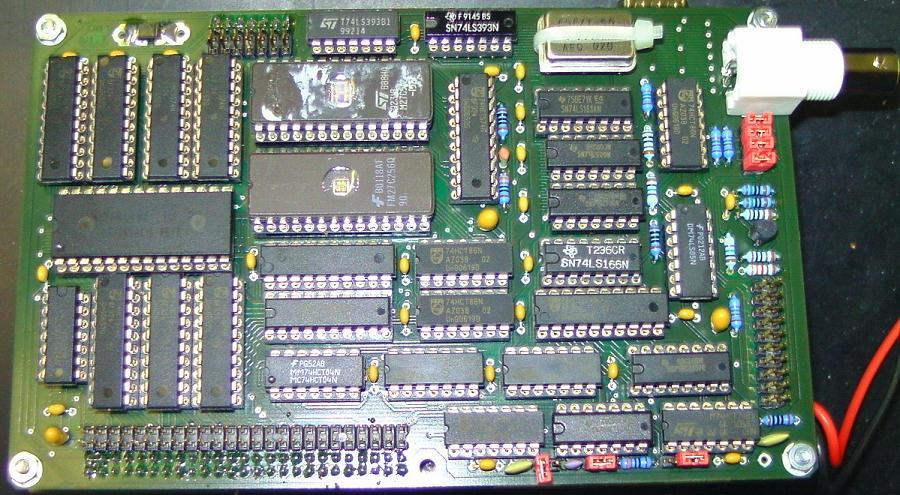

My solution was to make the TTL CRT controller a separate unit, running with its own clock, mirroring 6502 write cycles into its own display RAM.
So that the SBC doesn't need to be changed, and is able to work without the CRT controller being attached to it.

Because my TTL CRT controller was able to generate an analog video signal while working as a LCD controller...
