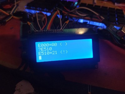

So PS/2 took me some time, but I'm really surprised how easy it was to implement, including make/break/extended scancode handling as well as shifted characters. My biggest mistake was forgetting to terminate my functions with `rts` and wondering why weird code is being called.
Also, some WDC instructions are totally awesome, including SMBx, RMBx, & STZ. ROR seems to work properly with shifting the carry bit in - I heard some myths about "bug" with it, maybe it's only relevant for some ancient 6502 NMOS revisions.
I think my PS/2 bit handling code could be slightly improving by juggling with VIA's shift register after start bit was received, but I decided to keep it simple and read all 11 bits in a bit-banging style.
Now I'll be able to do some interaction with my device. Probably the most helpful commands that I'll implement first will be reading/writing memory locations - that's gonna heavily reduce the amount of EPROM flashes!
Finally, having LOAD command to run arbitrary code from ROM or SD card in C64 format (i. e. binary that's prefixed with little-endian address specifying where to load the code) will be nice, especially for playing SID songs. I'll try to keep my code @ github updated at all times.
