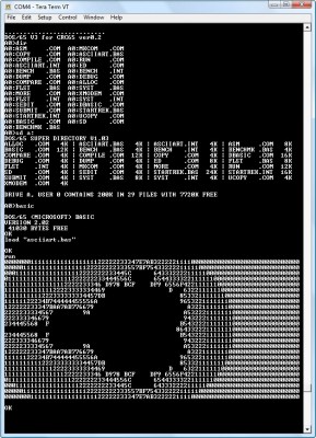

I have three BASIC programs on DOS/65: a BASIC compiler (COMPL205.ASM, RUN207.ASM), Microsoft BASIC (BASIC202.ASM), and ported EhBASIC (DBASIC.ASM). I am able to assemble BASIC compiler and MicroSoft BASIC using the native DOS/65 assembler; I assembled the ported EhBASIC using CA65 assembler. Here are the run times of mandelbrot benchmark on the 29.5MHz CRC65:
Compiled mandelbrot---24 seconds
ported EhBASIC--------45 seconds
MicroSoft BASIC--------51 seconds
(Edit on 10/31/22, running same benchmark on 22MHz Z80 BASIC-80 Rev 5.21)
Z80 MBASIC80 22MHz--155 seconds
MicroSoft BASIC is slowest, but it does have working "LOAD" and "SAVE" commands. Load/save commands are not working on the ported EhBASIC.

I believe I've successfully ported DOS/65 V3 to CRC65 SBC. Attached is CF image of DOS/65 V3. Unzip and copy it to a new CF (32MB or larger) using disk imaging tool like Win32DiskImager and it should autoboot to DOS/65. The difference between DOS/65 V2 and V3 are mostly in the PEM and CCM. SIM is basically the same except the warm boot routine copies one more CF sector to accommodate the larger PEM+CCM. There are 4 new software in version 3:
BASIC.COM is MicroSoft BASIC.
SUBMIT.COM is for batch file
UCOPY.COM can copy file to different user areas
SD.COM is super-directory, displaying more directory information.
