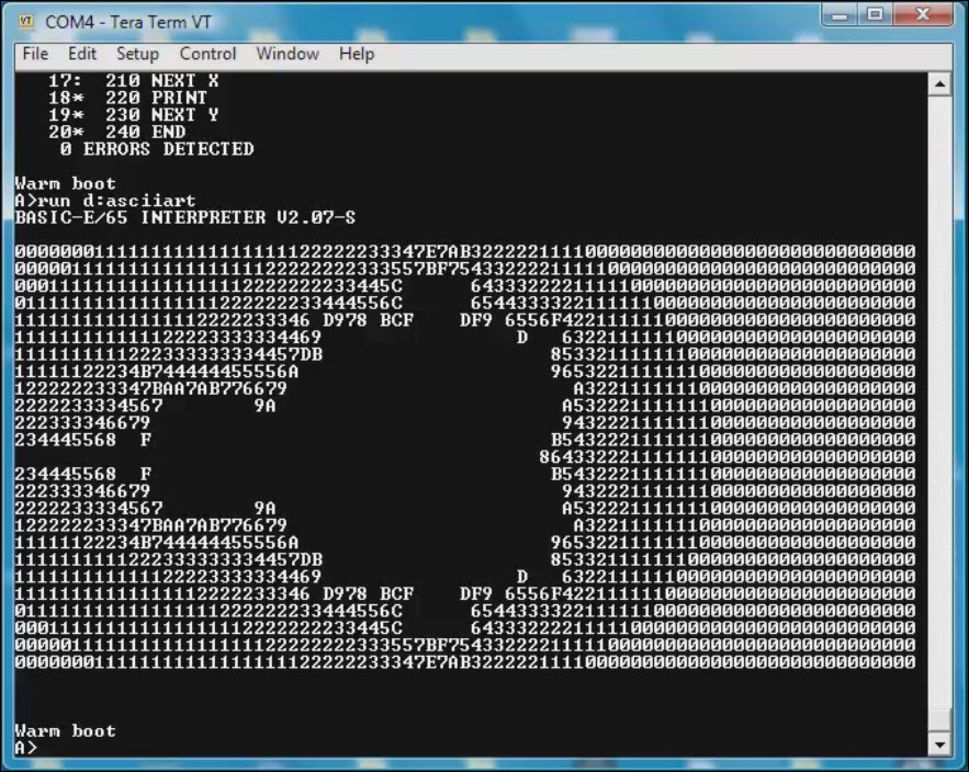

This is a six-minute video showing how a new DOS65 disk is created from scratch on a 29.5MHz CRC65 SBC.
The console is set to 230400, CRC65 is set to serial bootstrap mode and a formatted blank CF disk installed before the video. Video starts with execution of a TeraTerm macro file, newDOS65CF.ttl. The fast moving part is in the first 11 seconds when serial bootstrap is first loaded which then loads and executes the CRC65 monitor. The monitor then load the DOS/65 binary and a helper program to save save DOS65 in CF disk's system track and autoboot program in CF's master boot record.
At 0:11 DOS/65 and monitor software are done loading, the CF disk is now auto-bootable into DOS/65.
XMODEM, assembler, and mkcom hex files are loaded into memory and saved as executable .com files in drive A of DOS/65.
At 0:26 shows the directory of drive A with XM.COM, ASM.COM, and MKCOM.COM installed.
XMODEM is used to load system utility programs into drive D. The utility programs are alloc208.asm, compl205.asm, compr204.asm, copy203.asm, cputype.asm, debug204.asm, dump100.asm, edit205.asm, more202.asm, and run207.asm. Several BASIC sources are also loaded.
At 2:39 shows all files are loaded into drive D
The assembler, ASM.COM, is used to assemble the utility programs followed by MKCOM.COM converting assembler outputs to executable .COM files.
At 5:05 shows all utility programs have been assembled and converted into executable.
COMPILE.COM is used to compile the BASIC sources followed by RUN.COM to execute the compiled BASIC code.
At 5:25 BASIC program FLST215S displays the file status of drive A and drive D.
At 5:33 BASIC program SYST212S display system status
At 5:53 Mandelbrot benchmark result displayed.
Attached is all the files used in the video including the TeraTerm macro. The Teraterm macro looks for files in c:\teraterm\dos65

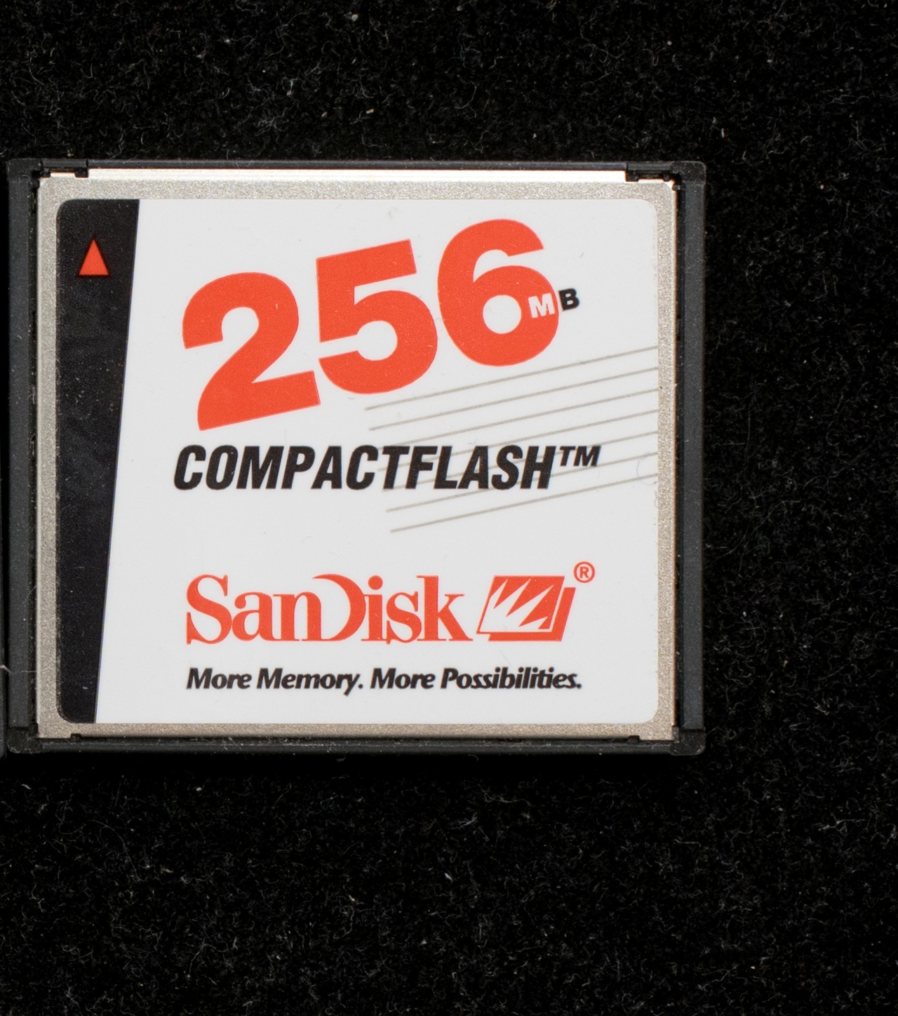

Are you able to run your CRC65 to 29.4912MHz? The board itself should run OK, but I've found the limiting part to be CF disk. The only one in my collection of CF that works at 29.5MHz is SanDisk 256MB. I have had 100 of them but I'm down to about 10. I'll be interested to know what other brand of CF disk can run that fast. PQI brand of disk-on-module also works at 29.5MHz but its IDE44 pinout is mirrored of IDE44 for CF.

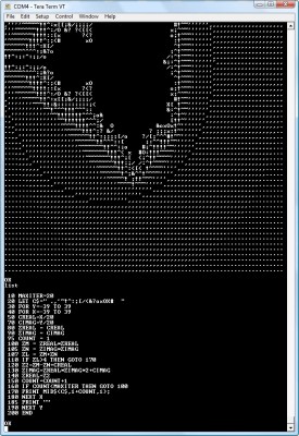

I have three BASIC programs on DOS/65: a BASIC compiler (COMPL205.ASM, RUN207.ASM), Microsoft BASIC (BASIC202.ASM), and ported EhBASIC (DBASIC.ASM). I am able to assemble BASIC compiler and MicroSoft BASIC using the native DOS/65 assembler; I assembled the ported EhBASIC using CA65 assembler. Here are the run times of mandelbrot benchmark on the 29.5MHz CRC65:
Compiled mandelbrot---24 seconds
ported EhBASIC--------45 seconds
MicroSoft BASIC--------51 seconds
(Edit on 10/31/22, running same benchmark on 22MHz Z80 BASIC-80 Rev 5.21)
Z80 MBASIC80 22MHz--155 seconds
MicroSoft BASIC is slowest, but it does have working "LOAD" and "SAVE" commands. Load/save commands are not working on the ported EhBASIC.

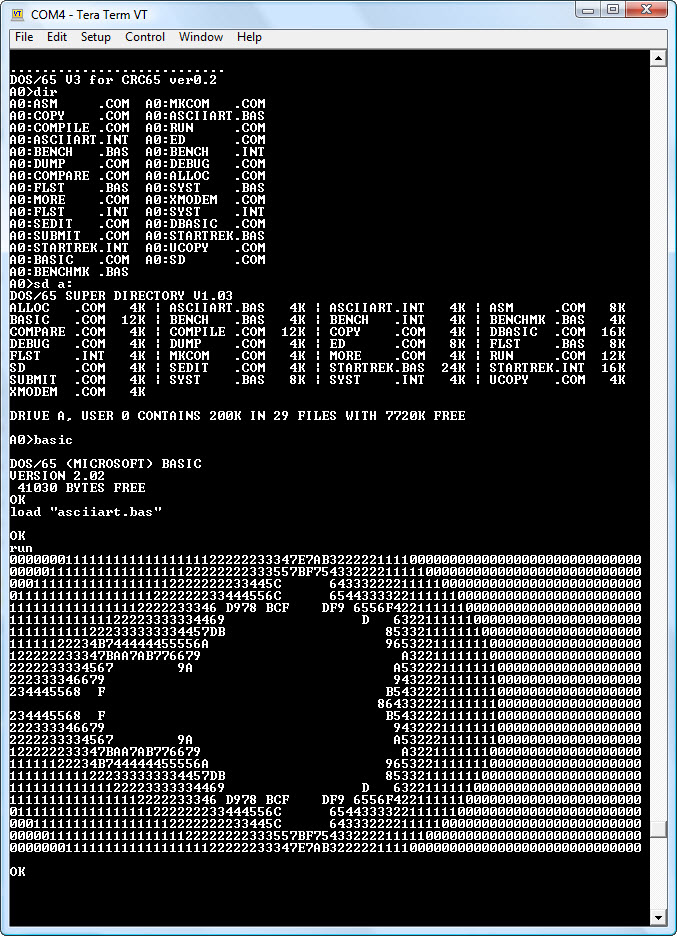

I believe I've successfully ported DOS/65 V3 to CRC65 SBC. Attached is CF image of DOS/65 V3. Unzip and copy it to a new CF (32MB or larger) using disk imaging tool like Win32DiskImager and it should autoboot to DOS/65. The difference between DOS/65 V2 and V3 are mostly in the PEM and CCM. SIM is basically the same except the warm boot routine copies one more CF sector to accommodate the larger PEM+CCM. There are 4 new software in version 3:
BASIC.COM is MicroSoft BASIC.
SUBMIT.COM is for batch file
UCOPY.COM can copy file to different user areas
SD.COM is super-directory, displaying more directory information.
