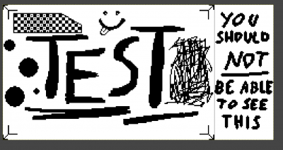

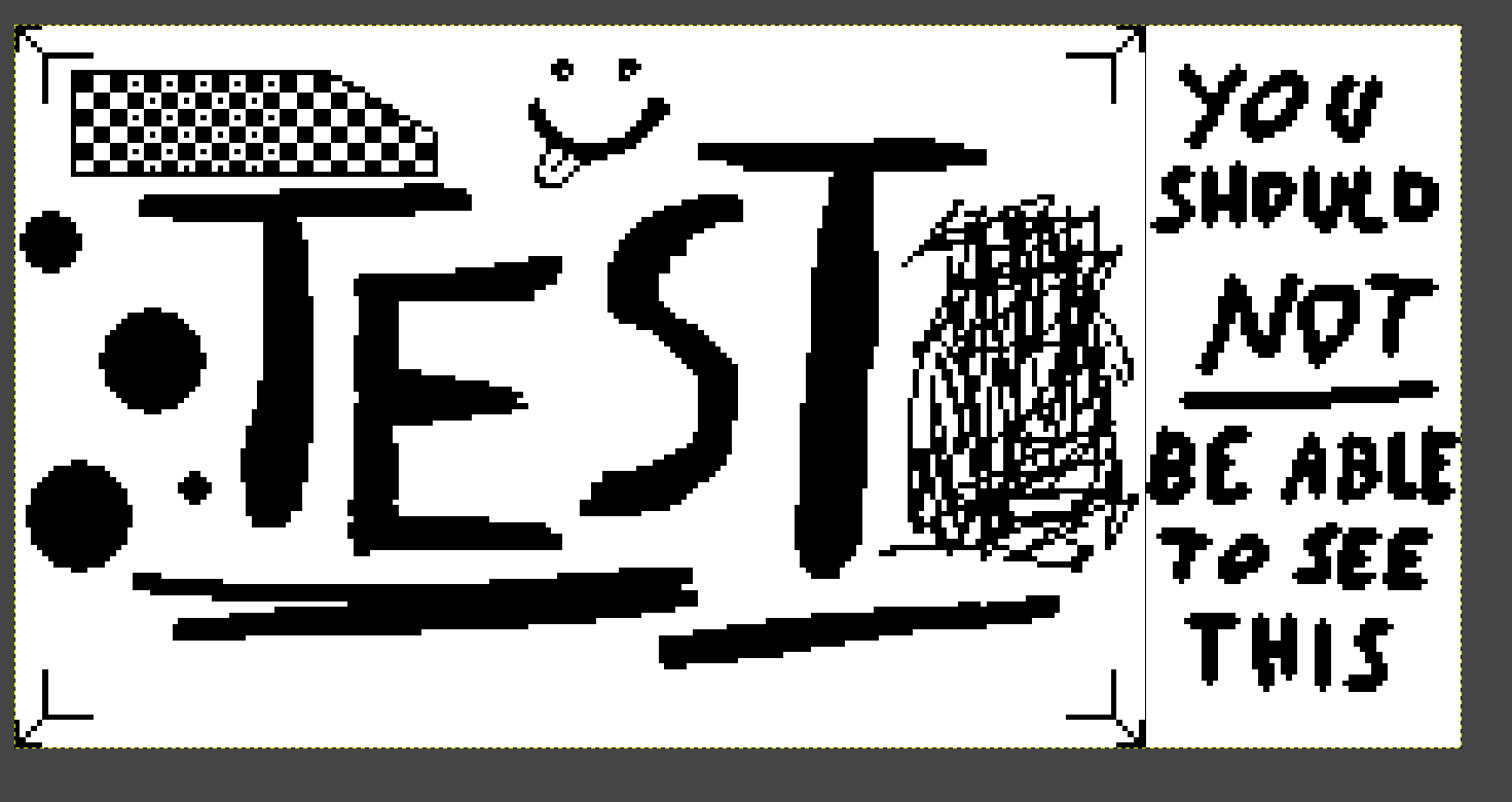

but before i can go into detail i kinda need to clearify how (i think) the drawing works.
basically you're throwing a 256x128px image at the screen, but only a 200x128px part of that is actually visible. (technically this means you could "easily" implement smooth horizontal scrolling)
so what you need is a Binary file that contains pixel data (1 bit per pixel) for a whole 256x128 image, so it lines up with the screen.
anways, to the process i went through to make this:
using GIMP i made an image 256x128, marked the 200px point so i know where the screen ends, and changed the mode to 1 bit indexed color mode. which only gives me Black and White but that is all i need.
i then drew this image: you can see the arrows in the corners, that is where i expect the visible screen to be.
I just threw random things at it to test basically everything you would ever want to throw on the screen. (aside from interactive/moving stuff)
I then exported the image as a XBM File. this basically takes the whole data of the image and converts it into a C compatible Array, with each line of 8 pixels (from top left to bottom right) being listed as a byte.
though note 2 important notes about that.
1. GIMP stores white pixels as 0, and black pixels as 1.
2. GIMP stores the byte in reverse order. so the order of the pixels on screen from left to right is: 0 1 2 3 4 5 6 7. and they get stored reversed to that as: 7 6 5 4 3 2 1 0
using that Array i extracted the pure data from it via Notepad++ and some search&replace functions (removing spaces, 0x-prefixes, commas, etc) and loaded that into my simulated VGA circuit

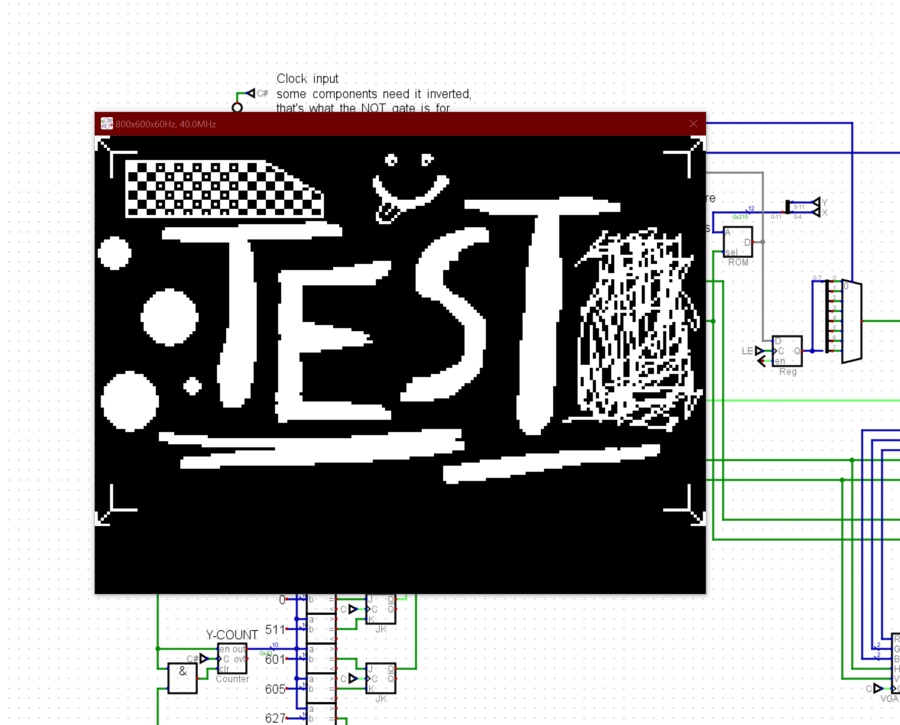

and this was the result: pretty good i'd say.

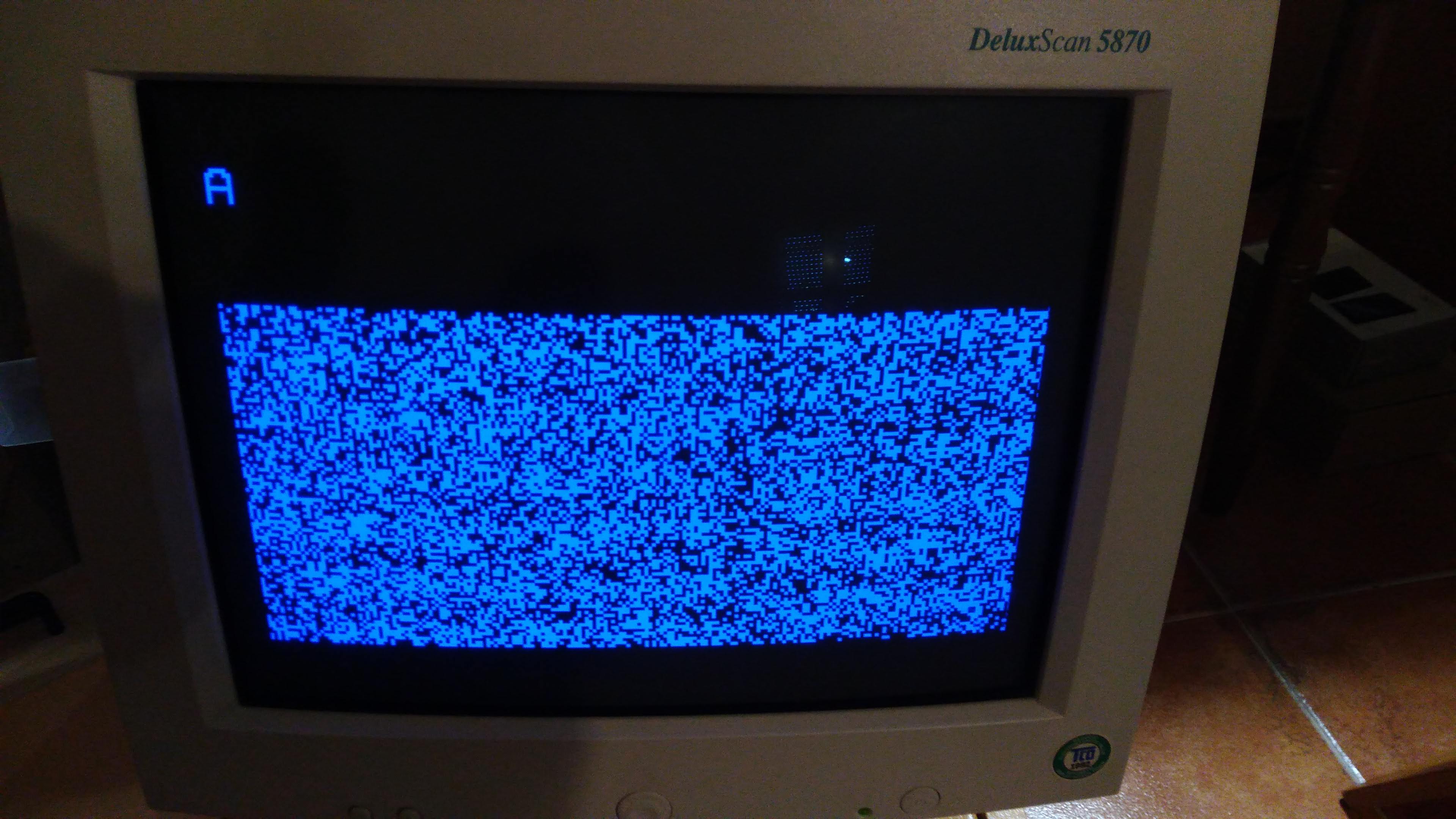

JuanGg wrote:
first pixel of every byte was too short, as the register had to be loaded.
[after the load,] the shift register does a series of shifts (I assume it's 7 shifts, making the character 8 pixels wide). So, the pattern for the shift reg is load shift shift shift shift shift shift shift [and so on]. But here's the thing. For a good looking display you need the timing of those eight events to be entirely regular... which is almost impossible with a '165 shift register but quite easy with a '166 shift register. That's because the load input on a '165 takes effect immediately, and thus the timing of the load signal is critical. But on a '166 the load input doesn't take effect immediately -- it simply alters the function of the next clock edge (when it arrives) from shift to load. Thus on a '166 shift timing and load timing are one and the same. The load is synchronous.
LIV2 wrote:

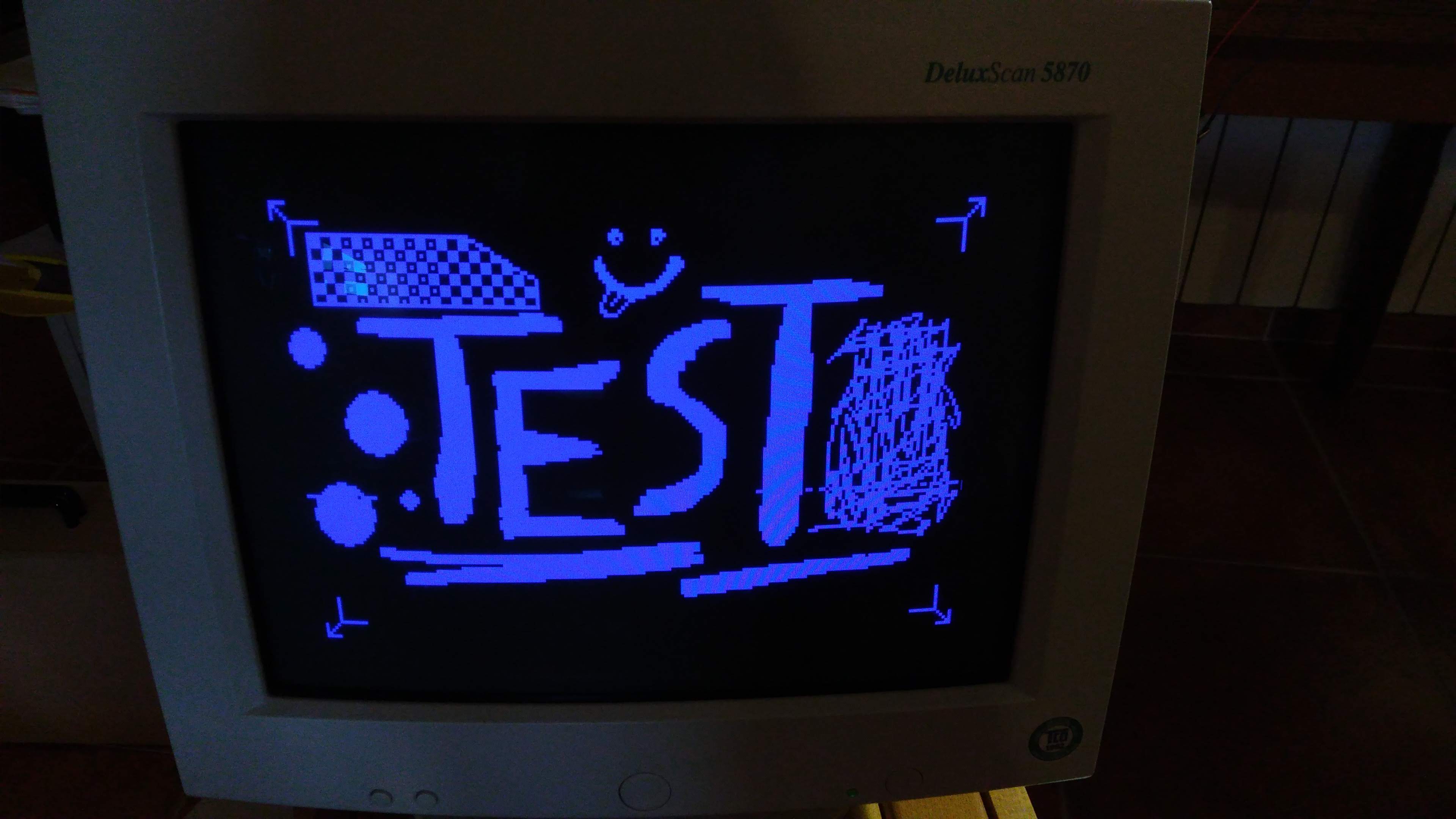

Yeah using a HC166 and it looks good so far. I'll create some test characters with one pixel on the left/right etc to be sure but it's noticeably sharper and no edge artefacts like I was seeing before
Re: Micro programmed 6502-like CPU
Proxy wrote:
that is some awesome progress!
but i think it's time for a test image, something complete you can throw at it that you know how it's supposed to look so you can see if it actually works as it should.
I am shifting bit 7 first. It just seems more natural to me to see the bits from MSB to LSB on the screen. Although I've gotten used to reading 8 bit values in reverse order while building my CPU...
This sounds like the sort of trouble that results when using a shift register with asynchronous load, such as the 74xx165. It's possible to reduce those symptoms, but doing so is a fussy business and you're unlikely to achieve 100% success. Of course, the results you're presently getting may be good enough, and I understand if you're reluctant to modify the circuit. But FYI others have recovered from this situation by switching to a '166 instead, as in this example. The goal is for each group of 8 pixels to seamlessly align with the neighboring groups (and with the left and right borders). Other synchronous load options include 74xx299.

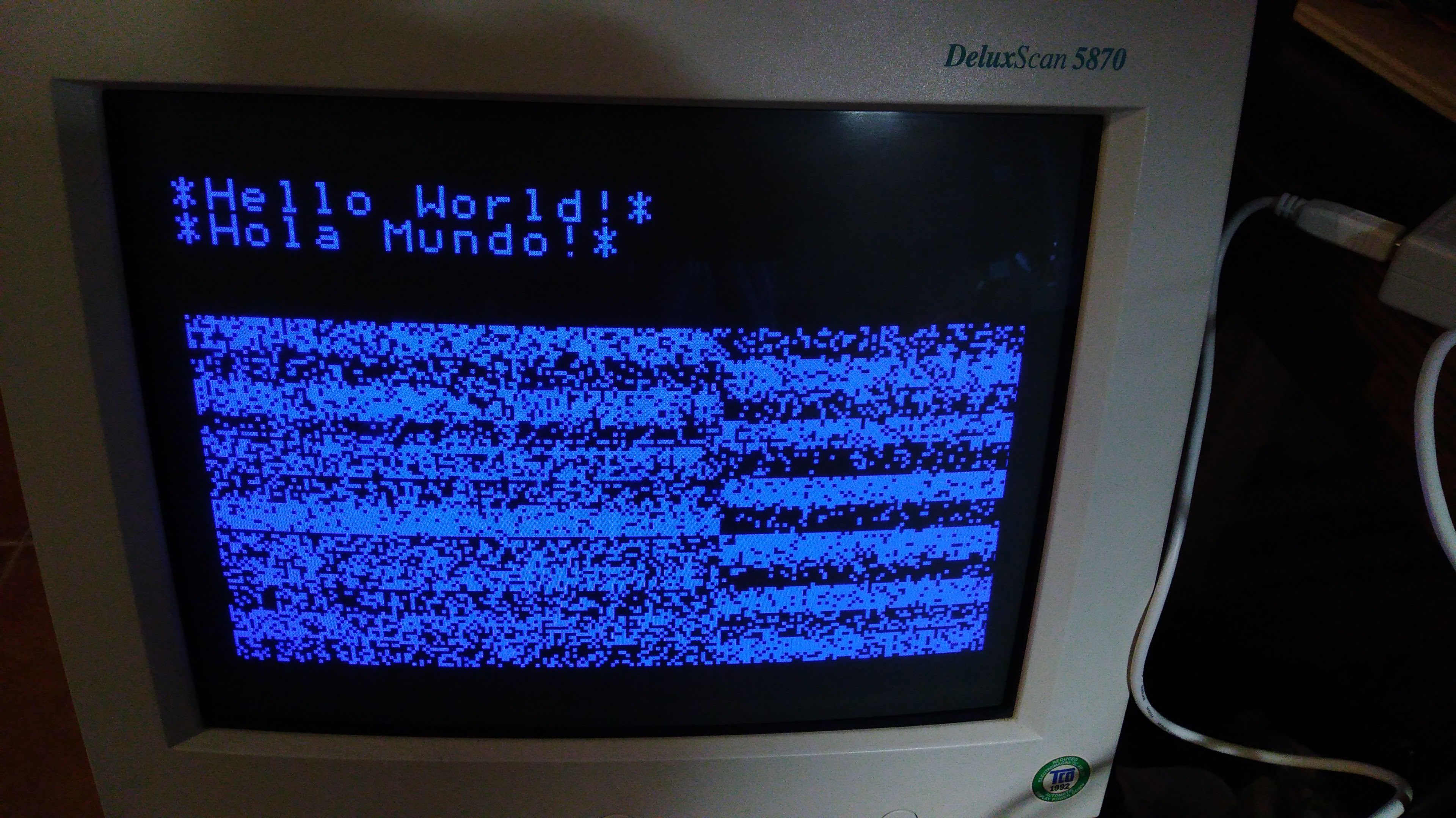

Some updates:
The video card is "finished" and working. I had to make a couple modifications here and there regarding RAM setup time, and now works as designed, fully asynchronously with respect to the CPU clock. I've just wrote a simple program that clears some of the screen and prints an "A", byte by byte. Running it at KHz clock speeds, writes to screen RAM can be seen in real time. At a MHz, I think it'll be fast enough.
Colours are hard-wired as of now. I may add a register that sets foreground and background colours for the whole screen or line by line. But that's just aesthetics. I'll add some proper, power, PS/2 and VGA connectors on the back (and leave some space for a DB-9) when they arrive, and then I can use a VGA cable instead of the mess of hanging wires I have now...
I now have to write subroutines for character output, scrolling and such. I thought about using PETSCII, but that would require 2K of ROM, and a look-up table to translate from ASCII. So I may use something like the ATASCII (https://en.wikipedia.org/wiki/ATASCII) character set, with printable characters matching ASCII, and "semi-graphic" characters on the control codes.

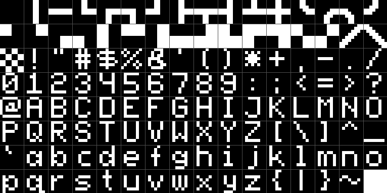

about the character set, i would recommend just going with 7 bit ASCII, that would mean you only need 1k of ROM for the whole character set. at the expense of more characters.
i made this a while ago for my own video chip. it's completely ASCII compatible, but the special characters have been reused for some graphical symbols. now about the routines, i would recommend just having each character stored as 8 consecutive bytes in the ROM. it makes reading the character a lot easier.
another reason is that it works perfectly with the Binary Image i made of that character set!
i call it "Modified ASCII" or just "MASCII".

Proxy wrote:
damn now i feel kinda stupid for having wasted that hour when someone else already made a font.
oh well atleast you got something working, and i got a character set i can use in the future.
i guess now it's time for just plain old programming to get some functions going.
question is, how are they supposed to work.
personally i would make 2 basic functions, one that puts a single character on the screen and one that puts a whole string on the screen (null terminated).
both would have 3 input parameters, an X and Y coordinates and the character/pointer that is supposed to be displayed.
the coordinates align with 8x8 tiles, not pixels. so the top left corner would be X=0, Y=0, while the bottom right corner would be X=24, Y=15.
bonus points if the functions output the X and Y coordinates of where the next free space is.
so for example if you input into the string function X=0 and Y=0, with a string that is 10 characters long. the coordinates afterwards would be X=10 Y=0.
though it would need to wrap around once X goes from 24 to 25. same with Y at 15 to 16.
overall this would allow you to put text directly on the screen wherever you want.
and also put multiple characters/strings in sequence without having to calculate the next coordinates manually, as the functions already do that.
but those are just my 2 cents. how you do it in the end is up to you. and i'm interested how you gonna do/are doing it.

I haven't posted in a while... I've been really busy with this "online university" thing. In less than a month I will be able to work on this more regularly.
I left off with fonts and such, and not much has happened since then. I've written some screen subroutines, including one that scrolls the screen one character line up.
And that's when trouble begins. When scrolling (it does so upon pressing the enter key just for testing), some lines, dots and other creatures appear primarily (but not only) at the bottom of the screen and make their way up. It's not a software issue, I have made simplified subroutines, testing a line at a time etc, and it still happens. Should anyone be interested here is my scrolling subroutine:
Just to recap, my video card just "listens" to the address and data buses and copies RAM writes on certain addresses to its own RAM.
So those must be errors when writing or reading from "system" RAM. Either the RAM, the CPU or something in between is to blame. I made a couple programs that wrote patterns to memory and checked back, but I wasn't able to get it to fail that way.
So I cleared the screen and modified the scroll subroutine to check if the bytes read were 0 or not. If it read a non-zero byte, it just does
so I get a pulse on the X register that I can probe with the scope (that's the good thing about ttl CPUs).
I then noticed that when taking the video card out, pulses became more frequent. The video card should only have an effect on power consumption, effectively dropping the 5V rail (it's the hungriest card of all). So I left it plugged in and lowered the voltage on my power supply. Sure enough, pulses became less frequent and eventually disappeared.
But now at lower voltages, the video card stops working properly, as expected. There is a "sweet spot" when both work, but that's no acceptable solution.
I had set my power supply to just under 6V, the drop in the leads resulting in about 5 V on the computer cards. When lowering it about 5.5 V, voltage on the computer is 4.4 V or so. RAM's recommended supply voltage is 4.5-5.5V.
I think this means that the errors are occurring during reads, as data on the bottom line of the screen is only written once at the start, but upon reading, it sometimes reads fine, sometimes doesn't. I have checked timing requirements and I think those are met with plenty of margin. I have swapped out the RAM for another identical one, and it makes no difference.
Whatever the cause is, RAM errors would explain the far less frequent "random resets" that I'm experiencing as well.
Any ideas are welcome. I may have to take out the logic analyzer to try and rule out the CPU...
Juan
