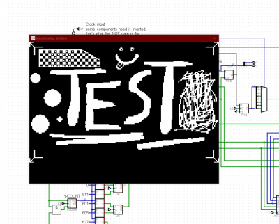

but before i can go into detail i kinda need to clearify how (i think) the drawing works.
basically you're throwing a 256x128px image at the screen, but only a 200x128px part of that is actually visible. (technically this means you could "easily" implement smooth horizontal scrolling)
so what you need is a Binary file that contains pixel data (1 bit per pixel) for a whole 256x128 image, so it lines up with the screen.
anways, to the process i went through to make this:
using GIMP i made an image 256x128, marked the 200px point so i know where the screen ends, and changed the mode to 1 bit indexed color mode. which only gives me Black and White but that is all i need.
i then drew this image:
you can see the arrows in the corners, that is where i expect the visible screen to be.
I just threw random things at it to test basically everything you would ever want to throw on the screen. (aside from interactive/moving stuff)
I then exported the image as a XBM File. this basically takes the whole data of the image and converts it into a C compatible Array, with each line of 8 pixels (from top left to bottom right) being listed as a byte.
though note 2 important notes about that.
1. GIMP stores white pixels as 0, and black pixels as 1.
2. GIMP stores the byte in reverse order. so the order of the pixels on screen from left to right is: 0 1 2 3 4 5 6 7. and they get stored reversed to that as: 7 6 5 4 3 2 1 0
using that Array i extracted the pure data from it via Notepad++ and some search&replace functions (removing spaces, 0x-prefixes, commas, etc) and loaded that into my simulated VGA circuit
and this was the result:
pretty good i'd say.
i also converted this image to a pure binary format. so that you can try it out yourself. (i hope your EEPROM programmer supports .BIN files, it should)
I actually made 2 files. one has just all bits in each byte in inverted order.
because i don't know the order that you put bits on the screen.
which do you do?
is the first bit (bit 0) of the byte drawn first on the screen, or is the last bit (bit 7) drawn first?
if it's the first bit you basically need to mirror all your text/letters/symbols that you want to display.
anyways, here the files:
bit 0 first
bit 7 first

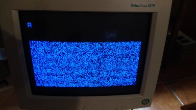

Thanks for your efforts. I've programmed your image in a ROM, and works as expected, see attached. There are a couple artifacts, that's because I'm using a defective ROM from ebay. Some addresses can't be reliable written to. But that means that I don't care much if I bend its pins during experimentation.
I am shifting bit 7 first. It just seems more natural to me to see the bits from MSB to LSB on the screen. Although I've gotten used to reading 8 bit values in reverse order while building my CPU...
This sounds like the sort of trouble that results when using a shift register with asynchronous load, such as the 74xx165. It's possible to reduce those symptoms, but doing so is a fussy business and you're unlikely to achieve 100% success. Of course, the results you're presently getting may be good enough, and I understand if you're reluctant to modify the circuit. But FYI others have recovered from this situation by switching to a '166 instead, as in this example. The goal is for each group of 8 pixels to seamlessly align with the neighboring groups (and with the left and right borders). Other synchronous load options include 74xx299.
I see. Dieter also uses a '166 on his D04 CRT/LCD controller. I've seem others do it with a 165 shift register and I now wonder how are they getting away with it. I could get the timing almost right by adjusting a pot in an RC network so I could not tell where the divisions between bytes were. But as you say, its fussy business and not very elegant. As I don't have any '166s at hand, and continuing with my approach of "trying to make progress during holidays with the parts at hand because I won't be able to do later...", extending the shift register with an external flip-flop clocked by the pixel clock makes everything work fine with no tricky adjustments. I may pop in a '166 later, this whole thing is "experimental" any way.

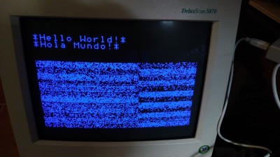

Some updates:
The video card is "finished" and working. I had to make a couple modifications here and there regarding RAM setup time, and now works as designed, fully asynchronously with respect to the CPU clock. I've just wrote a simple program that clears some of the screen and prints an "A", byte by byte. Running it at KHz clock speeds, writes to screen RAM can be seen in real time. At a MHz, I think it'll be fast enough.
Colours are hard-wired as of now. I may add a register that sets foreground and background colours for the whole screen or line by line. But that's just aesthetics. I'll add some proper, power, PS/2 and VGA connectors on the back (and leave some space for a DB-9) when they arrive, and then I can use a VGA cable instead of the mess of hanging wires I have now...
I now have to write subroutines for character output, scrolling and such. I thought about using PETSCII, but that would require 2K of ROM, and a look-up table to translate from ASCII. So I may use something like the ATASCII (https://en.wikipedia.org/wiki/ATASCII) character set, with printable characters matching ASCII, and "semi-graphic" characters on the control codes.
I'd like to write a machine-code monitor of some sort. With only 25 characters per line, showing an address followed by 8 bytes with spaces between them is impossible, unless I use 4x8 characters that is. One solution could be using alternating normal and inverse characters. So I have a use for those.
Just some thoughts. There is definitely a lot to be done.

I haven't posted in a while... I've been really busy with this "online university" thing. In less than a month I will be able to work on this more regularly.
I left off with fonts and such, and not much has happened since then. I've written some screen subroutines, including one that scrolls the screen one character line up.
And that's when trouble begins. When scrolling (it does so upon pressing the enter key just for testing), some lines, dots and other creatures appear primarily (but not only) at the bottom of the screen and make their way up. It's not a software issue, I have made simplified subroutines, testing a line at a time etc, and it still happens. Should anyone be interested here is my scrolling subroutine:
;*                   VGA SCROLL                      *
; Scrolls the screen one character up (8 lines)
vgaScroll:   pha ;push A
         txa
         pha ;push X
         tya
         pha ;push Y
         ;Set up two line indexes, one to read from and one to copy from.
         ldy #(hi vRAMbase)
         sty vRAMIdx +1
         ldy #$0
         sty vRAMIdx
         sty vRAMIdx2
         ldy #(hi vRAMbase) +1
         sty vRAMIdx2 +1
vsNextLine:   ldy #$0
vsLineLoop: dey
         lda (vRAMIdx2), y ; Copy lower line
         sta (vRAMIdx), y ; Save in upper line
         cpy #$0
         bne vsLineLoop
         inc vRAMIdx +1 ;Increase line index
         ldy vRAMIdx2 +1
         iny
         sty vRAMIdx2 +1
         cpy #(hi vRAMbase) +$10 ;Check if we have reached the bottom
         bcc vsNextLine
         ;jmp vsEnd
         ;Clear last line
         lda #$0
         tay
vsClrLoop:   sta (vRAMIdx), y
         dey
         bne vsClrLoop
vsEnd      pla ;Retrieve Y,X,A
         tay
         pla
         tax
         pla
         rts
Just to recap, my video card just "listens" to the address and data buses and copies RAM writes on certain addresses to its own RAM.
So those must be errors when writing or reading from "system" RAM. Either the RAM, the CPU or something in between is to blame. I made a couple programs that wrote patterns to memory and checked back, but I wasn't able to get it to fail that way.
So I cleared the screen and modified the scroll subroutine to check if the bytes read were 0 or not. If it read a non-zero byte, it just does
    ldx #$ff
    ldx #$0
so I get a pulse on the X register that I can probe with the scope (that's the good thing about ttl CPUs).
I then noticed that when taking the video card out, pulses became more frequent. The video card should only have an effect on power consumption, effectively dropping the 5V rail (it's the hungriest card of all). So I left it plugged in and lowered the voltage on my power supply. Sure enough, pulses became less frequent and eventually disappeared.
But now at lower voltages, the video card stops working properly, as expected. There is a "sweet spot" when both work, but that's no acceptable solution.
I had set my power supply to just under 6V, the drop in the leads resulting in about 5 V on the computer cards. When lowering it about 5.5 V, voltage on the computer is 4.4 V or so. RAM's recommended supply voltage is 4.5-5.5V.
I think this means that the errors are occurring during reads, as data on the bottom line of the screen is only written once at the start, but upon reading, it sometimes reads fine, sometimes doesn't. I have checked timing requirements and I think those are met with plenty of margin. I have swapped out the RAM for another identical one, and it makes no difference.
Whatever the cause is, RAM errors would explain the far less frequent "random resets" that I'm experiencing as well.
Any ideas are welcome. I may have to take out the logic analyzer to try and rule out the CPU...
Juan
