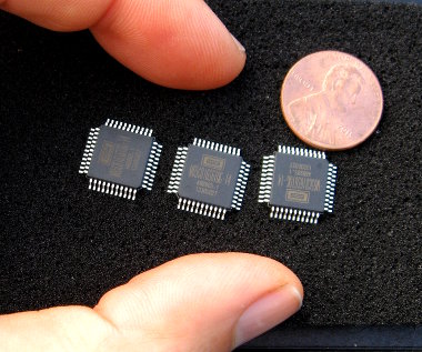

Look what came in the mail today from WDC! 816's in PQFP!
They say they expect Mouser to have them in the next week.
They exist!!!
Of course, there's no way I'll ever be able to solder one to a PCB. :evil:
<picture removed>
Excellent. I've been waiting for those, to put on this :
http://www.zeridajh.org/hardware/reco6502mini/index.htm
The PCB is ready for it. I designed it to take W65C02 as well as W65C816 (if it was ever produced). I just hope it doesn't have a 'surprising' pinout (compared to the QFP W65C02) ...
:shock: Those are neat!
Looks like I have to change my next layout! :mrgreen:
Bought a few W65C816S6TQG-14s, placed one on my little project, and working fine at 20 MHz (and 3.3 V) :-)
So it will probably do 24+ MHz like the W65C02, but that needs some further experimentation (no PLLs on board ...).
Yep. 24 MHz : pass (with soak test). Like the W65C02, not bad for a 14 MHz rated chip at 3V3.
