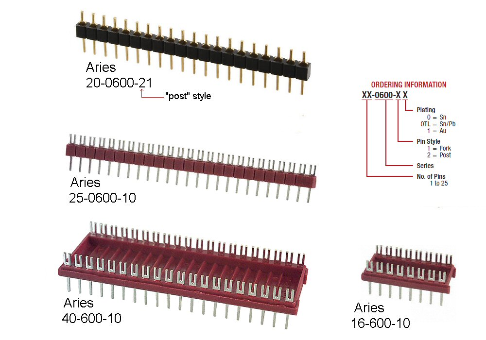

Tor wrote:
Pins? Something like this? http://oshchip.org/products/Flip-Pins_Product.html
(unfortunately only up to 20)
Those look terrific!
Here are some other possibilities. This stuff is hard to shop for, I've found, due to the very large number of more or less similar products. If you're browsing the Digikey site a good place to start is here:
> Product Index
You'll see there are half a dozen pin styles that could be creatively adapted to our purpose. Below I've shown two of the most obvious choices -- the so-called "fork" and "post" style pins.
Aries 12034-strip-line-header-337594.pdf [592.56 KiB]
Downloaded 192 times
AFAICT the prices and availability are not especially good. :( But Aries is hardly the only supplier for products with the fork style pins. It seems plausible you might find a bargain on these, particularly if you shop for the (rather common) 14- and 16-pin sizes. Ultimately you'd discard the plastic part and only use the actual pins, but the plastic part might be quite handy to keep the pins aligned during soldering.
Clearly, the "post" style of pin will work for through-hole mounting. But the "fork" style might actually be better for surface mount. (First you'd manually put a 90-degree bend in the two tines of the fork. For best results build a little jig.) Hmmm, if you bent (or cut) only one tine then maybe the result would work well for through-hole...
Other creative solutions exist, as I said. The Digikey link shows some other variations that seemingly might suit surface-mount.
Those appear to be the best so far. 20 pins is fine, since a 40-pin DIP has 20 pins down each side. Otherwise, they are end-to-end stackable anyway. Hopefully shipping won't make them exceed $4 per module. I would prefer it to be under $2 (5¢ per pin), but maybe it's just not possible. I haven't gotten a price on the Interplex parts yet, but all the other alternatives have one or more of these disadvantages:
  • $5 to $15 per module, just for the pins! (Even 40-pin DIP headers are nearly $6 now, plus shipping.)
  • too labor-intensive to mount (Labor-intensiveness is ok if I'm just making one or two, but not if I'm going to supply them for everyone who wants to buy.)
  • will damage IC sockets (Several potential buyers have expressed interest in plugging one into their existing '02 computer, and will probably want to leave the possibility of putting the '02 back in later. Cheap .025" square posts may stretch out the socket contacts so they'll no longer make solid contact on a normal IC.)
I think DIP headers (if they can be found inexpensively enough) could be surface-mounted, without bending or cutting tines, and it should be plenty strong if the PCB has holes under the tines, so there would be not only a good solder fillet but the copper and the solder under the tines would also reach into the holes for a better grip on the board. The holes would be smaller than the tines. Without the holes, I've seen too many cases of foils pulled away from the board and cracked when connectors were strictly surface-mounted in consumer electronics. Anything that handles some strain needs to be anchored into thru-plated holes in the board.
