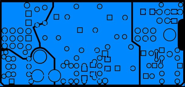

Ah, this is some great information!
But just to clarify. I have stated that this is a 4-layer miniboard pro. So with this in mind, do you guys see any problems?
The plane you see on the right is an attempt for a separate analog ground connected at one point to the digital ground plane. The plane on the left is an attempt to "shield" the USB data- and data+ signals. I just sorta threw that in at the last moment.
Traces should not cross the chainsaw line away from where the ground planes come together, unless you want an antenna (which is how some antennas are made on things like cell phones).
Many, many articles are available on the subject. If you want to do a search, a couple of notable authors who come to mind are Dr. Howard Johnson (guru of high-speed digital design), and Bonnie Baker who has been senior applications engineer at Texas Instruments and analog/mixed-signal applications engineering manager at Microchip, and author of "A Baker's Dozen: Real Analog Solutions for Digital Designers".
With the ground and power layers covering the full board area, you have what amounts to a gigantic bypass capacitor. Also, the ground bounce effect often seen with high speed digital circuits is not an issue. I've 'scoped things on my POC unit and have noted that absolutely nothing shows up in those layers.

Ah, so I have made some bad choices in my attempt at an analog ground plane since it is overlapping either the ground plane or the power plane, not sure which?
The video using the 4954 and the audio most likely will be abit noisy. Hopefully it won't be too bad. Will have to wait and see. I think the next version I will take BDD's advice on keeping everything on the same ground plane.
