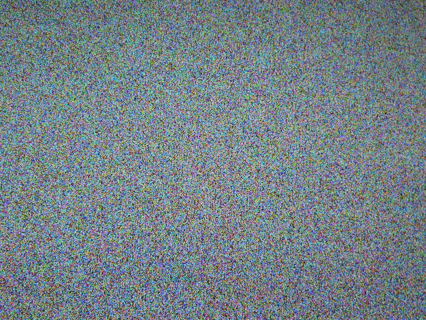

A proper statistical analysis I am not prepared to do... However, what I can do is a power-up of the TFT without doing a CLRSCR and truly see a randomness based on Quantum Mechanics of the powerup threshold of transistors inside the SRAM which is part the TFT ASIC. I know the SSD1963 controller has such an embedded SRAM for the video buffer.
I'll try a few more close up comparison pics before the end of today, but more likely tomorrow.
Also, there are some variables I could change in the code, but as it is now the 16-bit pattern will not repeat until after 2,147,483,647bits/16. For a TFT requiring 800x480x3=1,152,000 bytes to fill up a screen, there should be no repeating patterns...
I have DATA_OUT feeding DATA_IN and the cpu.:

This first pic is the "natural" randomness after powerup (10 min's no prior power). They're large pics but detail is needed here.
This is after plotting pseudo random LSB only:

Just a short analysis - the two pictures you posted are clearly different in their statistical properties. Just open them with gimp, look at Tools -> Color Tools -> Curves
While both pictures have all similar red and green curves (number of occurrences per color value), one has blue similar to the other colors, but the other picture has much less blue, about half of it.
Besides, the color occurrence curves look like Gaussian distributions, but the maximum is different. So in one of the pictures, the maximum of red pixels is shifted to darker red values, while the Gaussian distribution of the blue value curves is wider than the green ones (with approx. same maximum).
Nothing against using them. Just depends on your definition of "good enough".
(Just my $0.02 - but now I'll keep it at that :-)
André

Keep in mind I am only plotting the LSB of the pseudo-random 16bit number.
There is one reason I like this method and 1 reason I dislike this method. I like this method ,represented in Verilog, because it is simple and pure digital however it is a repeating function which I dislike, no matter how long the function lasts.
In V1.2 I will investigate a digitized analog noise source, and how much real estate this will take. I have read 1 diode, some cap's/res's and a comparator. More research is needed...
