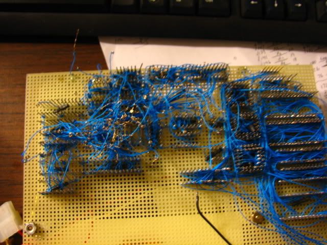

At this point of some real 6502SoC hardware, I am realizing I need some potent software. So I started digging in my past (i.e. garage), and decided to start this thread...
I started setting up my old C-64 system to see if any of my 20+yr old 5.25" floppies could still be read...
I've had interest in using Bill Yee's Micromon-64, an old assembler/disassembler for the C-64 that I've used very successfully for other C-64 based projects a long time ago.
I know I have the program on floppy, but I also have the code for it in a book I have called Compute!s First Book of Commodore 64. I would like to hack it and adapt it to the 6502SoC. Either his program, or Jim Butterfield's Supermon-64 (may he rest in peace)...
Right now it appears I will have to type in the machine code for Micromon, and do all the translation myself cross referenced to the C-64 memory map...
I know Mike Naberezny, owner of 6502.org, said he had the Supermon-64 code in the old Delphi post, but he's not been around for awhile now...

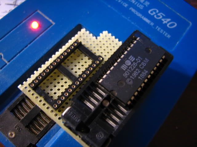

Cannibalization is taking place here! AHHHHHHHHH!!!!
I need a small chunk of vectorboard (in the upper left) real estate to make an 8Kx8 adapter socket.
Too bad for those discrete ABT and ACT parts, Iteration #1 of PWA is no more. Iteration #2 is still alive and well. You can see it to the right.
Q. What 8Kx8 memory has 24 pins?
A. A MOS 2364 C64 Basic Rom, and a MOS 2364 C64 Kernal ROM.
The 2364 pinout is much more like a 24-pin 4Kx8 industry standard memory...
So I made this 2364 to 2764 adapter socket...
BTW, Good luck if you think you can rely on the internet for a true binary image!
 Post subject:
PostPosted: Tue Apr 26, 2011 7:27 pm
Doesn't work reliably. When comparing 2 images I made reading the ROM, there are many data that are different. Maybe in the entire 8K image there will be ~200 data that are not consistent, differing by only 1 bit. Some off by 01000000, some 00001000, some 00000001, etc.
Thought it might be an access time issue. I actually went so far as to open up the programmer and insert a 74AC161 to divide down the 3.3V 4MHz 1/2 can oscillator to 1MHz. Didn't help.
I'm just impatient for my cable adapter to get these reliable images!

Sorry but only now I've actually realized what you want to do. You can find the binary image of the chip on your picture here: http://www.zimmers.net/anonftp/pub/cbm/ ... index.html
(plus other C64 ROM images).
Or do you just want to test your setup/adapter?
