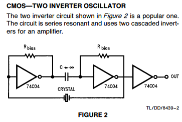

I did find a pdf [previously] which had a crystal and a pair of inverters (because after all a pair of inverters is an odd number if you're building an oscillator) and it placed a capacitor between the inverters:
From: AN-400 A Study Of The Crystal Oscillator For CMOS-COPS
[previously, dead image:
Edit: looking at this diagram, it's clear that depending on where you probe for the clock, you might be loading up the crystal, which might kill the oscillation. So try to probe after the buffer.

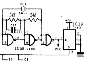

For reference, here's the oscillator circuit from a scan of the original uk101 manual - it's rather like the micro-uk101 as you might expect:
Compukit UK101 oscillator circuit

Ed, the first circuit "CMOS 2 inverter oscillator" is giving me 23.94mhz at the (buffered) output, is that correct? It's supposed to be 8. How can it oscillate faster than the crystal?
You mean something is actually oscillating? That's got to be a success, at any frequency!
It is a bit on the high side though. Presumably the third harmonic, or something like that.
You could use the '93 as a divide-by-16 readily enough, but that still leaves you with 1.5MHz, presumably too fast for this computer to compute? Or did you have the headroom in place for 2MHz?

Well, I measured 3Mhz at the CPU's PhiIn so I think it will not work.
The only other solution I can think of (apart from getting the clock to work properly) would be to use the unused counter in the LS93. At the moment, the first divider is unused (that's why InA is unconnected). If I feed the clock signal to InA and connect the Qa output to InB that would divide by 2 and give me 1.5Mhz.
What do you reckon?
Indeed, you need to rejig the use of the '93. You need to feed in the clock signal at pin 14 (InA/CKA), and then take pin 12(QA) to pin 1(InB/CKB) instead. That gives you an extra divide by 2. (Check a datasheet for 74LS93 - I'm referring to this one, third part shown.)
