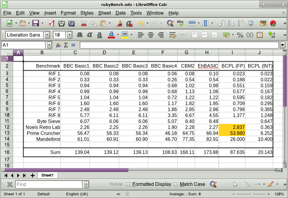

For no real reasons I decided to run some benchmarks on my somewhat retro Ruby816 SBC computer. It’s a 65C816 CPU running in 8-bit mode with various BASICs and in 16-bit mode running a 32-bit VM to support BCPL. It runs at 16Mhz and has 512KB of RAM (only 64KB accessible in 8-bit mode though)
I was mostly interested in how much faster BCPL was. The result was that it is faster, but not always (bother).
I put together a blog post on my own site about it all, but I’ll put the results table here:
It wasn’t always easy to do some of them in floating point in BCPL, and I gave-up with the Byte Sieve one, but do note that 2 were slower in BCPL than in BBC Basic4…
There is a link to the source code on my blog posting for anyone who cares to look.
Which is here:
https://projects.drogon.net/retro-basic ... enchmarks/

Here are some FORTH entries for the list.
These were run on a 65816 simulator with a cycle counter that FORTH can read. The times reported are # of cycles divided by 16000000 to get seconds.
There is no math coprocessor used - the floating-point operations are all coded in 65816 using a 32 bit mantissa.
The FORTH is subroutine threaded with a cell size of 16bits.
                        BBC Basic 4     Forth FP        Forth Int       BCPL Fp         BCPL Int
R/F1                    0.06            .043            .0012           .023            .023
R/F2                    0.26            .052            .0013           .188            .022
R/F3                    0.68            .288            .093            .551            .159
R/F4                    0.68            .140            .010            .577            .167
R/F5                    0.72            .141            .011            .595            .182
R/F6                    1.17            .345            .018            .709            .295
R/F7                    1.86            .527            .035            .798            .385
R/F8                    3.35            1.830           1.784           1.377           1.248
byte sieve              5.07            1.232           .080                            .647
noels retro lab         1.90            .772            .035            2.837           .363
prime cruncher          46.18           22.611          .157            53.980          6.252
mandelbrot              46.70           13.467          2.170           26.000          10.400
Attached are the console log files, edited to include annotations on the disassemblys of the FORTH words.
