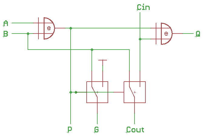

Squonk wrote:
You are right, and this was actually my plan: to build 4-bit slices on something like a 1 square inch PCB with pads on all sides much like the schematic in the OP, with buffers to split the drive load.
Yes, but if you happen to have flipflops in the microcode pipeline which fed the input drivers of two or four 4 Bit bitslice modules,
then using module input flipflops instead of module input drivers might make things a little bit faster/compacter. :)
Squonk wrote:
I have not experimented it yet, but a CLA might be possible, which takes the P and either a or B signals as inputs, don't you think?
Virtual Generate.png (33.16 KiB) Viewed 2387 times
To put it short: If (A=1 AND B=0) OR (A=0 AND B=1), then Cout=Cin.
The proplem is, that due to the different propagation delays, having Cin in the equation for generating G
might give you spikes in the upper chunks of the carry lookahead mechanism.
I think that's not dangerous, but it might affect overall speed because it takes some time until the signals have settled.
Another idea would be adding another FET switch for generating G.
Unfortunately, this increases capacitances...
