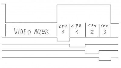

so, what if you had more than 2 CPUs? 4x 65C02's for example that all share the same fast single port SRAM with a video circuit. a lot of graphic operations can be split into multiple smaller pieces (like scrolling or drawing shapes).
my idea of connecting them was to have all CPUs run on the same clock with the same phase. but then use extra logic to restrict their time on the bus when PHI2 is high.
using bus tranceivers and latches (latches because data is only read on the falling edge of PHI2, so the data needs to be stored), each CPU could get a small part of PHI2=High time without having the CPUs themself run at extreme speeds. but of course the more there is on the bus the faster the support logic needs to run, which comes dangerously close to FPGA territory.
