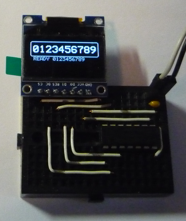

@plasmo
I got it working-ish. I ended up using my own I2C routine and initialization, but your code did help me figure out a couple of things :)
Since I only have 128 bytes of RAM I can't do the double framebuffer thing, so I have to rely on the one in the ssd1306.
However... It's blinking. It "works" and I got it to display text and everything(font takes up 5*95 bytes of ROM).. But it blinks. Like 10 hz refresh rate blinks - or like a fast version of the rolling bars you sometimes see on recordings of CRT screens.
I've been assuming it was bad hardware but a new 128x64 .96" OLED acts exactly the same way :/
Do you or anyone else see if somethings's up with my init?

PostPosted: Sat Apr 15, 2023 6:33 pm
Posts: 182
Hmm. Doesn't matter if I run the module on 3v3 or 5V.
If I crank up the display clock to max (d5 f0) the refresh flicker is hardly visible unless I move it and having precharge set to 0x11 seems to help too. It's still very visible on my phone camera. On my other camera the tearing starts to be visible around 1/13s shutter speed.
These are my current settings for future reference - I'm happy with how it looks but I'm still confused why I have to crank up the speed so much. Maybe something is slowing down the RC clock of the display.

PostPosted: Sat Apr 15, 2023 9:53 pm
Posts: 589
Here are a couple init settings I've used with SSD1306 OLED displays (you'll notice many of the 'default' settings were used). Hope this helps.

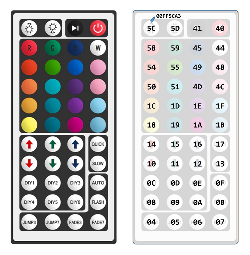

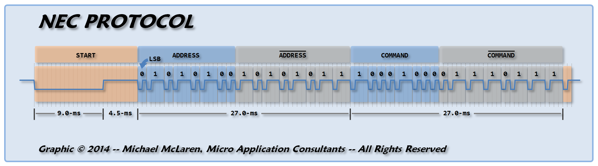

I enjoyed your I2C on a 6502 Single Board Computer video. Bit-banging the I2C protocol is a nice challenge and the relatively inexpensive 0.96" and 1.3" OLED displays are fun to code and use, though they require precious memory for one or more font tables.
May I suggest a relatively inexpensive keypad solution to complement the OLED display? They're LED lighting controller sets which include a small LED controller module and an IR remote keypad. You would remove the IR Receiver from the controller and connect it to a single I/O line on the 6532 RIOT (with pull-up) and you will need some 6502 code to parse the NEC codes from the IR keypad. A plastic coated paper keypad overlay would be a nice finishing touch.
Have fun. Stay safe. Mike
PostPosted: Mon Jun 19, 2023 8:52 am
Posts: 182
Michael wrote:
I enjoyed your I2C on a 6502 Single Board Computer video. The relatively inexpensive 0.96" and 1.3" OLED displays are fun to code and use, even though they require precious memory for one or more font tables.
Thanks for watching!
That's certainly the right price range! I might make a video with enough detail to do it with just a vs1838b IR receiver and whatever IR remote you have in your junk drawer (to stay with the green theme of only buying new if you can't rescue some junk - and an old TV remote membrane is usually better quality than the cheapest membranes).
Good idea!
