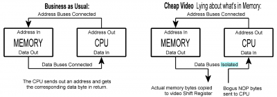

Why do you need 2byte instruction and not NOP to clock address bus?
The goal is for the address bus to increment on every clock cycle. NOP consumes 2 cycles but it's only 1 byte. So, a diet of all NOPs would mean the address bus would increment only on alternate clock cycles.
How does the opcode generator know when to stop counting and present RTS?
Lancaster's approach is to feed 5, 6 or 7 of the least-significant CPU address lines to a small ROM that's (mostly) filled with copies of the 2-byte, 2-cycle NOP-like instruction that's gonna be used (such as ORA# $00 or CMP# $C9). And the ROM is what the CPU sees during a scan. And if the goal is to have, say, 64 bytes per horizontal line then bytes 0 to 61 are filled with copies of the 2-byte "NOP." Next, byte 62 contains $20 (RTS), and byte 63's contents don't matter because it's fetched then discarded. So, the CPU does a JSR to an address to where video data is stored :shock: but instead it sees this goofy "subroutine" of a bunch of CMP# $C9 then a RTS. (Repetitions of this 64-byte pattern temporarily appear to fill a large portion of the memory space.) And that's how you output a single horizontal scan line. As the CPU fetches the illusory subroutine, the actual RAM data is simultaneously being fetched, and that's what gets serialized and output as video.
The ROM approach assumes your video data is organized so as to reside at addresses that result in the proper behavior on the LS address lines during a scan. And there's a bit of freedom to juggle things; for example it needn't always be 0 to 63. But KK sidesteps this fuss & bother entirely. Instead of a ROM, KK's fake instructions are generated by discrete logic. And instead of addresses, KK's "stop scanning now" cue is provided by a VIA timer that's freerunning at the horizontal rate. Whenever the timer reloads, the VIA outputs a transition on PB7, and that is what triggers the end of the scan by changing the CPU's diet from all $C9's to all $20's. :mrgreen:

Hm, that sounds like it could be the basis for a workable system. But it wouldn't be Cheap Video, if I'm understanding you properly.
The advantage of Cheap Video is in omitting the Video Controller or DMA controller and instead letting it be the CPU which increments the address bus on every cycle. To get that behavior, the CPU data bus needs to be fetching 2-byte, 2-cycle instructions from somewhere[*] at the rate of one byte every cycle while at the same time and using the same addresses video data is being fetched from RAM at the rate of one byte every cycle. Here's an illustration from my article. If there's anything the article fails to explain adequately I'll be grateful if someone will please ask.
Nowadays we have much faster processors and memory, and it's possible to make a low-end video system that doesn't require one byte of video data to be fetched every cycle. The cycles happen at a much faster rate! But if you want high resolution and/or increased color depth, Cheap Video still bears consideration, and there's still no Video Controller or DMA controller required. :!:
[*]Footnote: traditionally, a tiny ROM (or discrete logic) is the "somewhere" from which the dummy instructions originate. Aliasing causes the image to appear repeatedly in the address space, so a low capacity ROM will suffice, and that'll save money. But nowadays memory is drastically cheaper, and the builder may prefer to have an actual RAM or ROM full of dozens of K's of nothing but $C9 and the occasional $20.
