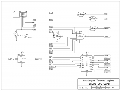

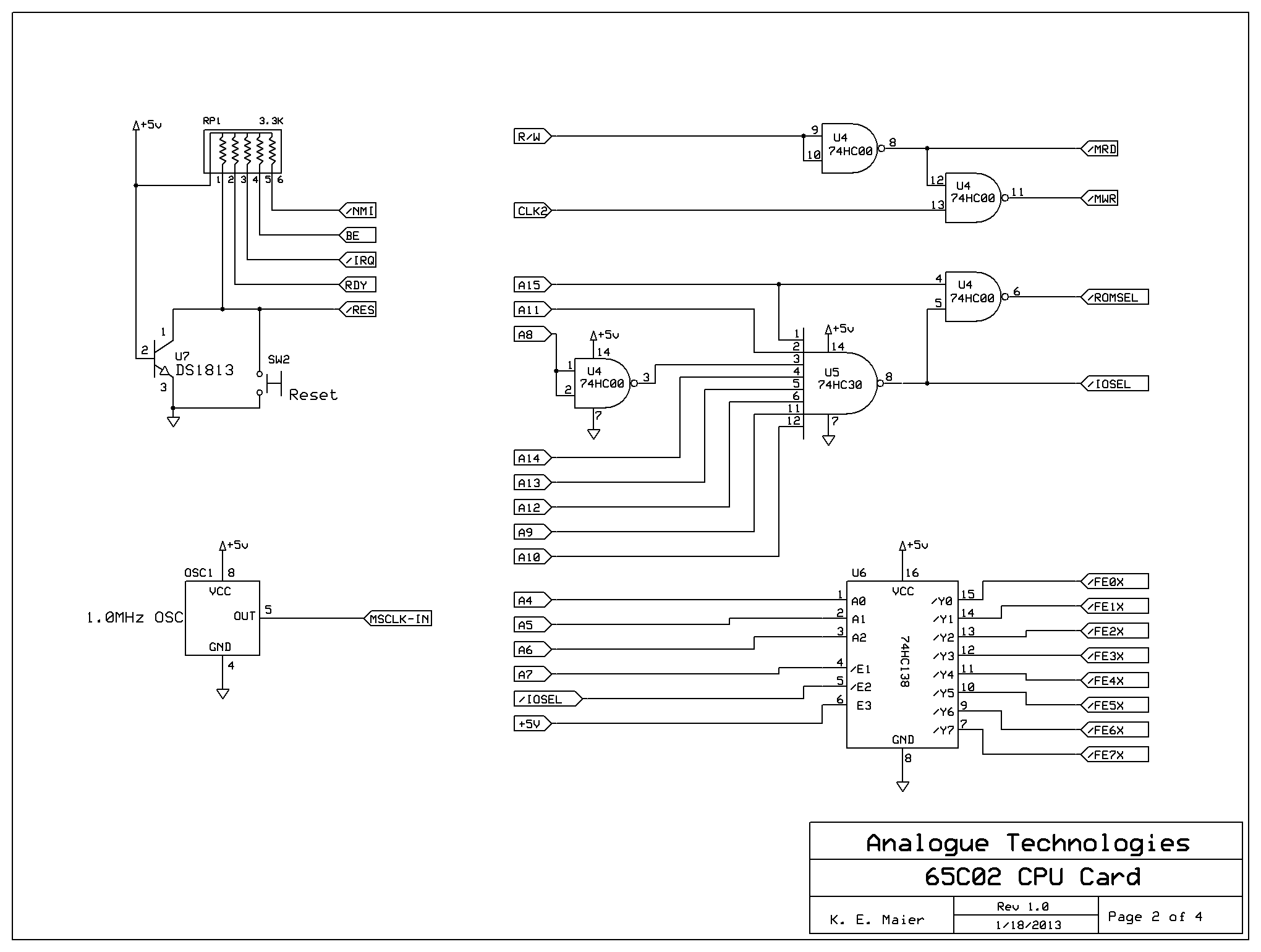

I also agree with Gordon on a smaller I/O window. For years, I've used a single memory page (256 bytes) for an I/O page. I've always located mine at $FE00. I don't recommend putting I/O in page zero.
I designed a small CPU board back in the 80's that use 3 logic chips:
- 7400
- 7430
- 74138
Using the above, you can have a memory map as:
RAM - $0000 - $7FFF
ROM - $8000 - $FDFF / $FE00 - $FFFF
I/O - $FE00 - $FEFF
- I/O is broken into 8- I/O selects, each at either 16- or 32-bytes wide.
Also, the write line for memory is qualified using phase 2 CPU clock, which is required.
I've attached a section of a schematic for this, albeit the I/O selects are done at 16-bytes wide, so only half of the I/O page is used.
Note that in the setup, the chip select for the 32KB RAM is tied directly to A15 from the CPU, which eliminates decoding it separately. You can also use a jumper for the write line on the 28C256, as these devices can be programmed insitu if needed.
You can also find the entire system with an I/O adapter on my github page.
