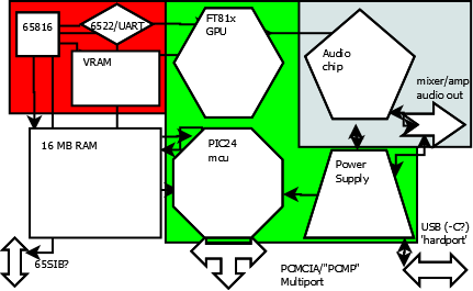

System Busses and Support Components
High Speed Video Bus 60 Mhz, GPU, Flash Memory i/o, the GPU has a 12.000 Mhz internal or external clock and a multiplier/divider
Mid Speed Common Bus 12 Mhz, PIC24 can run at up to 16 or 60depending on model, it at 60, it will bus to the GPU. The 65816 will also run at 12. Mhz in this case if the current GPU, a Bridgetek FT816 is used, to better sync up to its clocks and minimize oscillators.
RAM is being considered in full SRAM, dual port VRAM and traditional DRAM options. The system will have 16 MB of RAM, and may have additional RAM via a switch or RAM banking, allowing for 64MB of available RAM or More. the Integrity OS specification will further determine this. A major consideration is using high speed battery backed SRAM in 64K for the 6502 e mode to use as a dedicated 'fast page' or similar configurations regarding core functions of the 65c02/65816 in e mode.
RAM banking, fast ram for local pages banks, extended ram and rom chip options are being explored. The 6505/65816 have MMIO addresses for dedicated video access and control, mapping this to shared vram or FIFO buffers etc may be desireable to achieve GPU control without going through the PIC/board controller or even the 6522.
North Bridge Multimedia Controller Bridgetek EVE 24/32-Bit LCD Controller @60Mhz (or lower?)
offers LCD driver, GPU, mono sound engine, touch screen and flash rom access
South Bridge Board Controller PIC 24E series 16-bit MCU @60 MHz (or 12?)
UART, Timers, Interrupts, SPI, I2C, ALU, and USB services
Sound Generator Savage Innovations SSG01 Soundgin (or Yamaha FM-Synth or Similar, a PSG chip)
Mixer, Stereo, Amplifier, Headphone Out, On-board Speaker or speakers.
Stylus ERM stylus reporting on a resistive touch channel to North Bridge
Multiport external bus adapter (PC-Card type I or ISA Pin-compartible), USB-OtG
we are directly competing with EOMA, a well meaning but physically incompatible use of PCMCIA.
we are extending/forking the legacy PCMCIA standard, itself descended from the venerable ISA standard, into what we are calling:
PC-Card Multi-Port, or PCMP and it is pretty much PCMCIA as of revision 2.1 or later, possibly to include the entire 32-bit CardBus with DMA, though type i 8/16-bit cards are enough for now.

PostPosted: Sun Mar 19, 2023 7:42 pm
Welcome!
What stage are you at? Do you have any diagrams, or sketches, for example? Or perhaps you have some detailed ideas for circuit design?
Perhaps more important: what's your next step?
PostPosted: Sun Mar 19, 2023 7:55 pm
Joined: Sun Mar 19, 2023 2:04 pm
Posts: 137
lots of data sheets.
not at PCB design just yet. some function block stuff. I recovered a draft of a flash deck.
at one point I had many pages full of notes, and they were lost to a move
at another point, I had been on the phone with LCD makers for the screen unit, years ago
atm, Im gearing up to prototype in the next year or so.
I am working on a BIOS demo on the emulator when I get time here and there.
my next step?
I call people next week and talk to sales reps or tech support at different places.
I need clarity on some clock speed concerns and interfacing with other chips.
finding an FM synthesizer

PostPosted: Mon Mar 20, 2023 9:01 pm
Posts: 1488
Well, I'm curious...
It sounds very interesting, but also somewhat odd at the same time ...
The sort of project that requires you to "talk to people" for components are the ones that are expected to ship in the 1000s or more. Often much more in these enlightened days where we go to Mouser, Digikey, etc. for even 100s or components...
So what is it?
Sounds like some sort of hand-held multi-media/PDA/data acquisition/tricorder "clamshell" type thing (in which case there are far better CPUs for it) or some sort of retro equivalent?
Using "smart" graphics controller chips - well I'm guilty of that to a degree - the other side is that even a 16Mhz '816 will struggle to manage a memory mapped 800x480 pixel display at any reasonable speed although 8bits per pixel may be feasible, even then it's 375KB or just under 6 banks of 64KB which makes even something as simple as clearing the screen an issue. if you can get a high speed SPI interface to the '816 then it could do it though - providing the commands are of the form "plot a point", "draw a line", "put up a menu with these icons, these input areas, and load these images from the on-board SD card"... (I've used 4D system smart displays in the past like that).
Not sure about your speeds - why run it slower in emulation mode? My system runs at 16Mhz in native or emulation mode. Native mode is technically harder to run faster as you have to sample and latch the upper 8 bits of the address bus at the right time...
Then the biggest crux of them all - software.
Your talk of booting - a BIOS - needing 1MB of 6502 code... Are you aware the 6502 can only normally address 64KB? Systems "of the time" typically had 2KB of "monitor" then maybe 8-12KB of BASIC then maybe up to 32KB of RAM... The BBC Micro was 12KB of Operating system and 16KB of BASIC with 32KB of RAM. This sounds like a system more complex than either the Communicator or the //gs was at the time - and that's before going into native '816 mode...
In native mode I suspect you'll eventually need an operating system to handle that. I know of 3; First is the Acorn Communicator - a sort of 65816 version of the BBC Micro. They are rare, but the ROMs are online. 2nd is the the Apple //gs where there are Pascal and C compilers for, the other is my own Ruby BCPL OS. Great if you like coding in BCPL, I guess, but while it's faster than BASIC, it's still slow.
My own thing has an ATmega as the board host controller - that runs at 16MHz with the '816. For me, it took a lot of the "heavy lifting" of IO, serial, SD card (and originally video) off the '816. And I could write all that code in C rather than 6502/816 assembler.

PostPosted: Mon Mar 27, 2023 3:18 am
Posts: 137
Welcome, wayfarer. :) It would be good if you can share the function block stuff. Most especially, it would be good to see an overall block diagram of the entire system. Ideally that'd show the various buses between blocks.
just the start of one, Im starting high level and I am going to dive into each section further.
Right now, I want to get that Red section in the first post. figured out, thats the main logic unit of the system, and should be able to mostly operate on its own, with the rest of the hardware halted or powered down, that also leaves the PSU power unit, and I am not certain the 65SIB is going to get its 12v, though it might be possible to use when plugged in on the "high voltage service buss", atm, a 12v buss to flash eeproms with maybe. Ill have a better block diagram in a few days.
