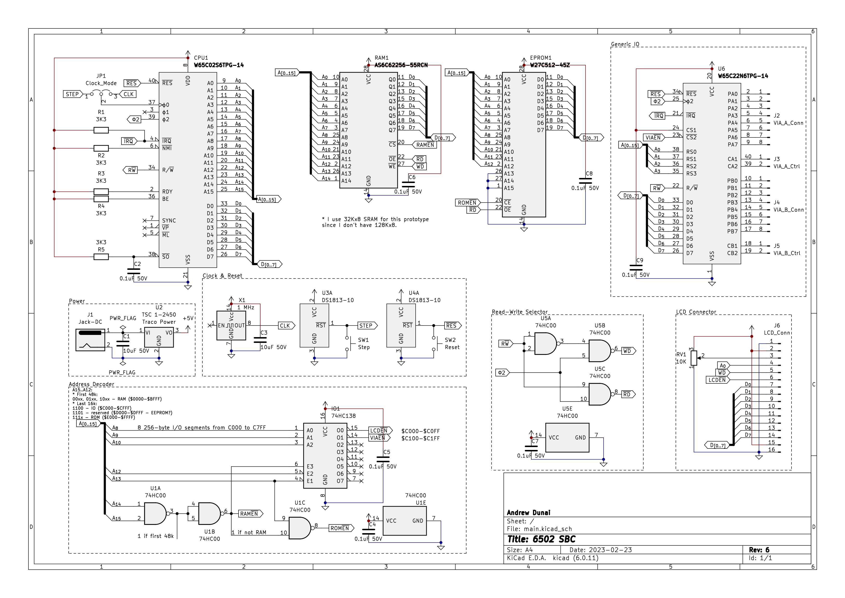

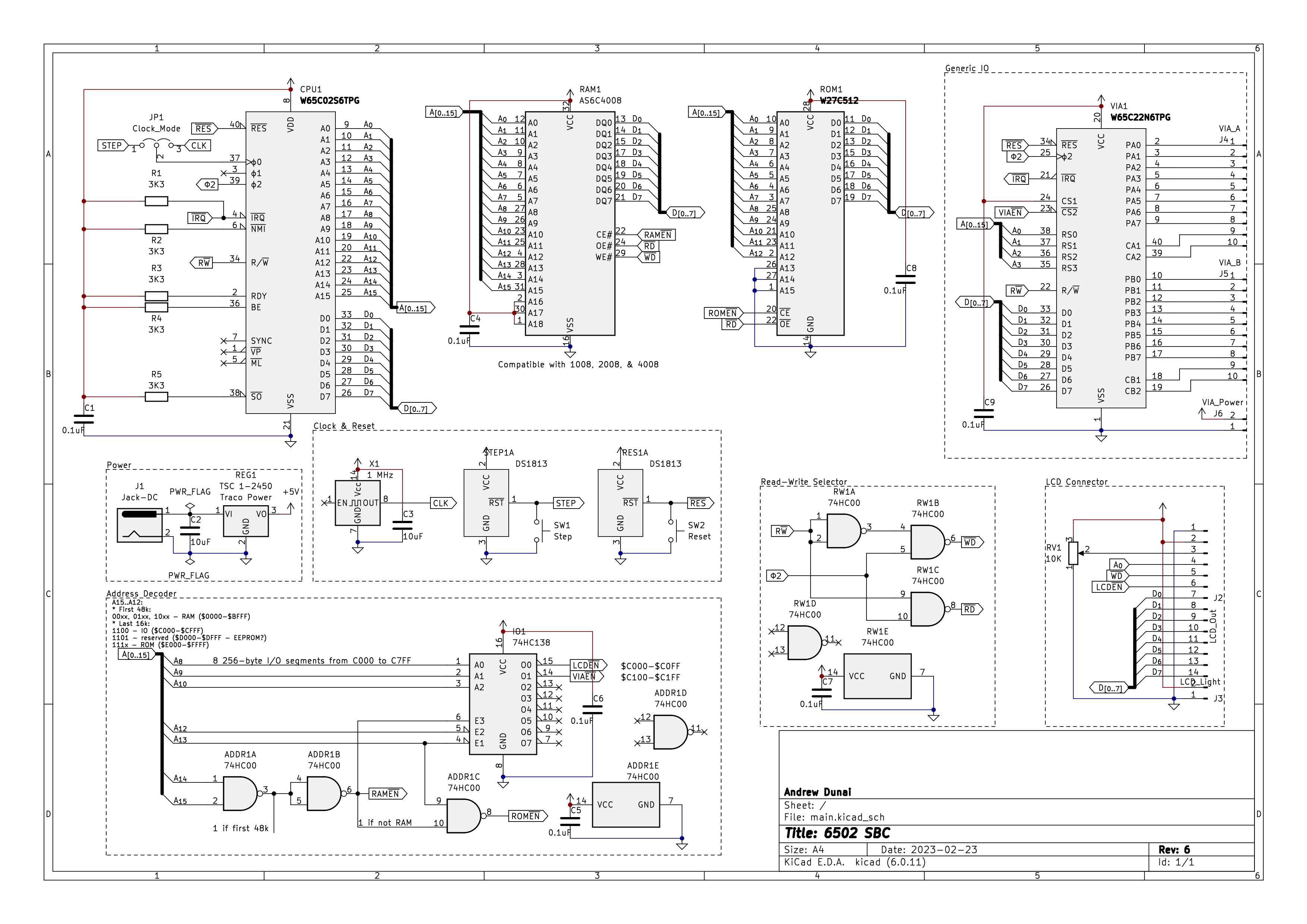

Using machine-tooled sockets with a ZIF socket is actually a cool idea, I didn't think about it. It will definitely reduce the footprint on the board also make it easier to squeeze extra caps/wires underneath. I'll try it!
In the meantime, I've updated my schematic to pass all ERC checks and came up with a version that I'll attempt to make a PCB of.
My 4x W65C02S have been shipped now, so I'll have them really soon - I hope! I've decided to include 2004 LCD & 6522 VIA in my "beta" PCB prototype, and I'll still use my perfboard for testing the basics - 6502+RAM+ROM.

Just once thing I once fell for. The most standard LCD text displays (All based on the Hitachi HD44780) have an active high Enable line. They are also quite slow, they will probably struggle at 1Mhz. In my SBC (viewtopic.php?f=4&t=5907), I bitbang the LCD interface with a VIA so I can run the CPU as fast as I need to.
Looks as though it ought to work.

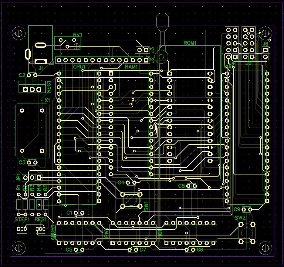

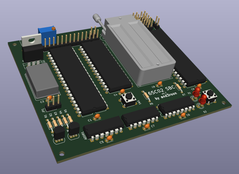

So I spent a ridiculous amount of time trying to route the PCB manually, and I eventually gave up and used DipTrace to auto-route things for me, because what the hell, it's just a prototype. (I think this project will actually never leave "prototype" stage, haha).
Also I've managed to squeeze everything within 10*10 cm footprint! That will save me some bucks.
My friend offered me some help with some improvements (including teardrops & copper pours), so that's what we'll try to do before printing.
Anyway, I know auto-routing is not perfect, there might be crosstalk and stuff, but I think it *should* work for my 1MHz device. I'll still be making another one with SID, EEPROM, & ACIA some time in the future - but for now, I just can't wait to order my bare-minimum first PCB ever!
/Andrew

Looks like a good result to me. Each year that passes, I'd imagine autorouters get just a little bit better.
PostPosted: Fri Feb 24, 2023 7:46 pm
Posts: 8524
Anyway, I know auto-routing is not perfect, there might be crosstalk and stuff, but I think it *should* work for my 1MHz device. [...]
Copper pours absolutely do not qualify as a ground plane.  They won't add any benefit unless you have lots of vias from the edge of the pour to a real ground plane, especially next to signal vias.  You could look up "coplanar waveguide" and "via fence" but the speeds of current 65xx OTS parts don't warrant going to that extent.  There is a way to use them to supplement real planes; but if they're not done correctly, they can actually make things worse, according to experts in the field like Rick Hartley, Eric Bogatin, and Suzie Web whose lectures you can see on Altium's YouTube channel.
In your case, I wouldn't worry about it.  I think you'll do just fine as-is.  For one thing, your board is kind of small for the edge rates involved.  I would do a ton of manual clean-up, but that's partly just me being kind of OCD about this stuff.  Do provide the shortest path you can between the ground pin of each IC and those around it, and of course to your bypass capacitors, and pay special attention to the Φ2 clock distribution, and you won't have any trouble.
Good luck.  We'll look forward to a happy report of a working board.
PostPosted: Sat Feb 25, 2023 3:58 am
It's not bad! And I've created a monochrome version of the image.
I notice the headers attaching to VIA Port A and Port B are only 10 pins each. I'd suggest 14 or even 16 pins each so you can connect a ribbon cable to an external device and supply the device with power, ground and perhaps even an extra signal or two.
I guess you're anxious to proceed. But if you decide to do another pass on the design, you could save some space by using a smaller oscillator, if available. Alternatively, the oscillator could be relocated. Right now the width of the board (from west to east) is consumed by...
  • oscillator, CPU, RAM, ROM, VIA. Instead, you could try...
  • ROM, RAM, CPU, VIA
The ROM (in its ZIF socket) is comparatively bulky, which is one reason I think it might do well at the edge of the board. Half of that extra width can hang over the edge! Oh, and I was thinking the CPU would be oriented with pin 1 toward the north, whereas the RAM, ROM and VIA would have pin 1 toward the south. This will tend to untangle some of the bus lines, but maybe with the auto-router you won't worry about that. Still, it'd be interesting to see what it would produce if you start by arranging the chips as I suggest.
Whether you do or don't reorient the chips, I would still consider moving the oscillator. With the extra width that's freed up, maybe those two headers for Port A and Port B could snuggle up broadside right next to the VIA instead of being pushed off the end. Just an idea... Good luck with the project, and have fun!
ps- and as Garth says, you needn't bother with the pour -- it is not a ground plane.
