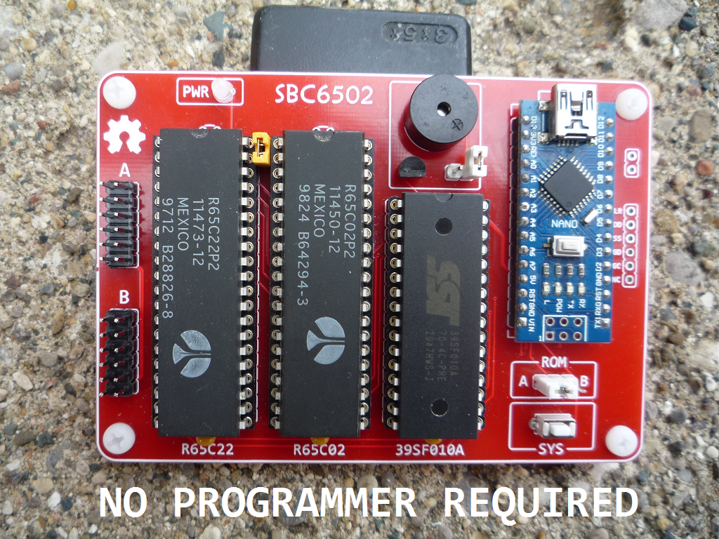

It's been several years but UTSource supplied 'good' parts compared to some of the scratched-up 'used', 'pulls', and 'refurbs' you might see from other vendors back then.
BTW, speaking of parts... I was pleasantly surprised to receive five (5) W65C22S6TPG-14 chips from China last week ($10.99 total, including shipping) which looked very nice and tested good at 8-MHz on my new SBC + Programmer prototype (see below). It was very exciting (for me) to be able to run Nick Gammon's G-Pascal package at 8-MHz with bit-banged 38,400 bps serial after replacing the Rockwell chips on the board with WDC chips.
