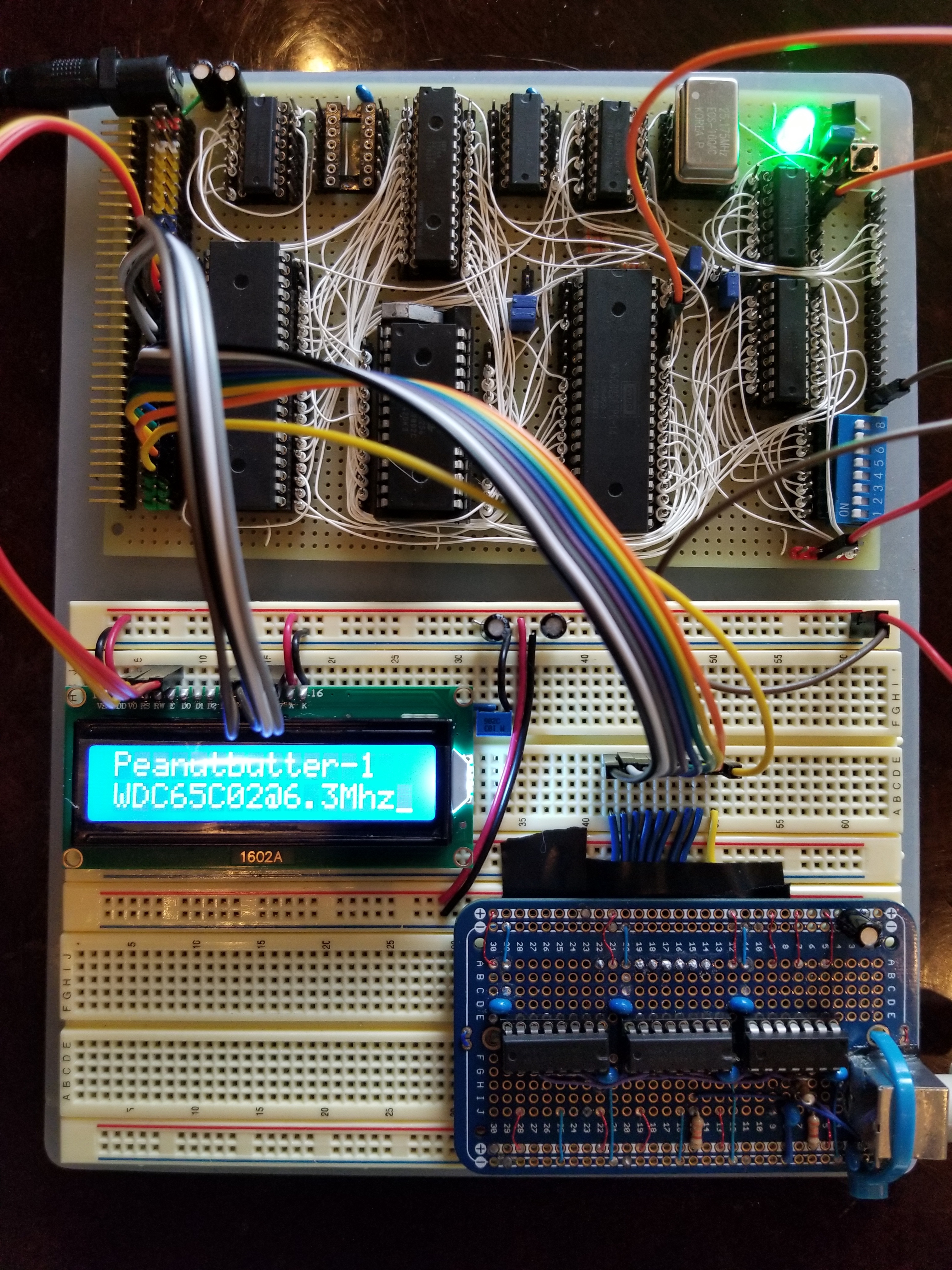

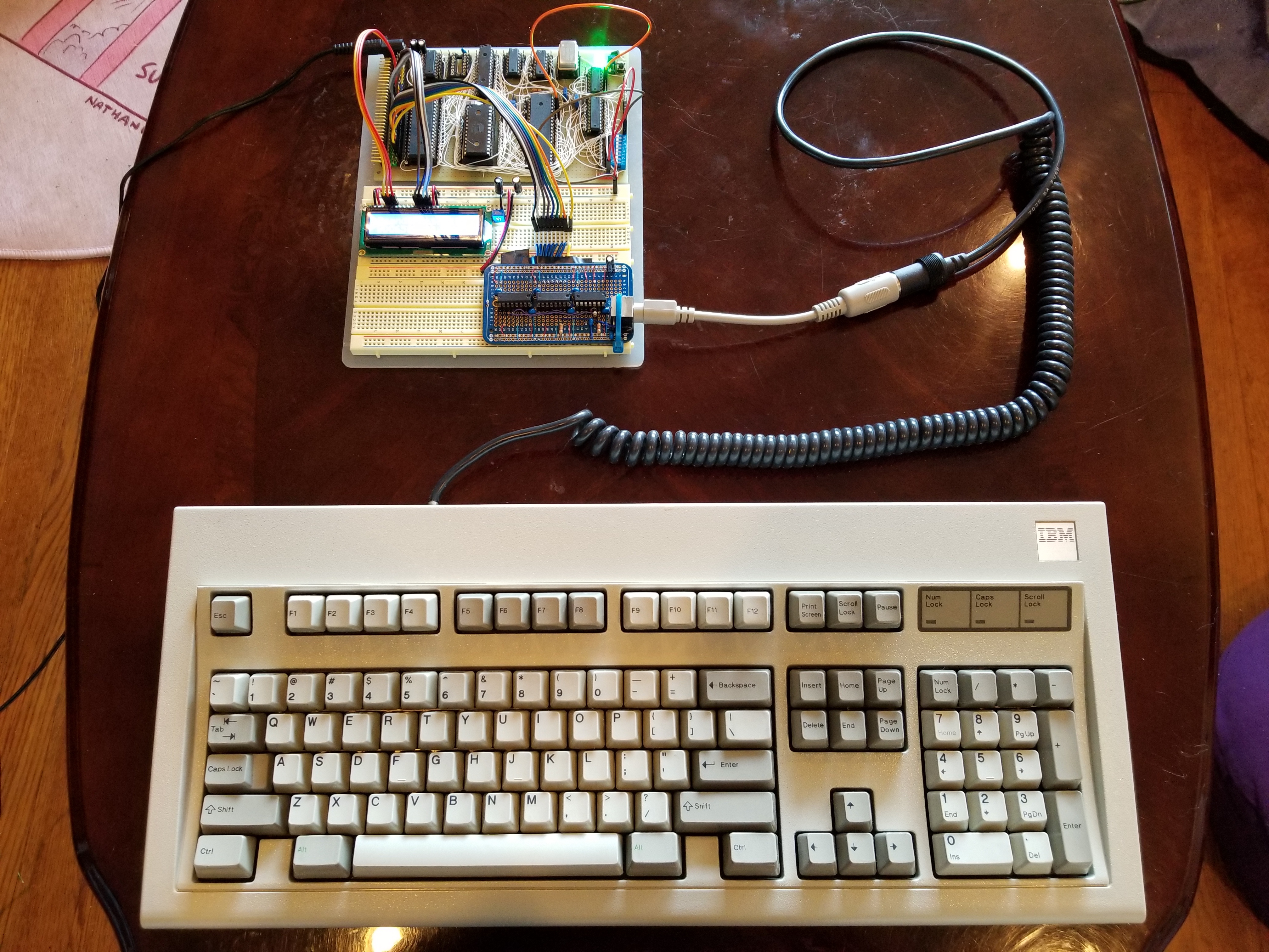

Here's a little update! Still procrastinating from building VGA circuits (hehe) but I thought it might be useful to have keyboard input in case I want to do some real-time debugging with a monitor. So, I stole Blue April's keyboard interface card and rigged up a breadboard for it:
It actually runs at 12.6MHz, but it's a little glitchy. Just a little glitchy. They're kind of funny glitches. Almost all the keys work, except M. When I push M I get a space instead. Just M, and always just a space instead. Weird. One hypothesis I have is that the keyboard card uses some AHCT logic (Blue April uses AHCT, and I didn't have any HC595s to replace them with), so maybe the bit pattern for 'M' just happens to generate line noise that the AHCT shift registers object to. I didn't investigate too hard. Everything works fine at 6.3MHz and I will have to slow everything down again when I hook up the CRTC anyway; it's a much slower part. So... :lol:

Turn up the voltage slightly up to 5.3V and see if it is more stable. 12.6MHz is 1/2 of 25.175MHz; it is nice to keep the design synchronous with one clock driving everything (except serial in this case--hard to make standard serial clock with 25.175MHz source).
Yep! I don't think I mentioned it, but that flying orange wire is the clock line; I have 12.6, 6.3, 3.14, and 1.6 MHz available off of a 74HC1633. That flying wire could also be contributing to the glitch. I have some nicer shorter jumpers coming, but they're taking forever to get here!
My voltage wall wart puts out around 5.1 volts. I don't have a nice adjustable bench supply, but I do have some spare ATX power supplies laying around. I've seen some videos where people convert them into bench supplies. I haven't quite got up the nerve to do it though; it's been a long time (read: decades) since I've done anything near the mains...

Does it put out 5.1 under load though? Wall-warts aren’t noted for their great regulation.
It's 5.15 where it comes onto the board. It drops to 4.94 across the A/K of the LCD backlight, which is the furthest point from the supply. All the IC sockets have at least 5 volts across their power pins.
I think it's having more trouble keeping up with the current demands; the Model-M is a power hog! If I understand how to use my meter properly (which is not necessarily a given) the SBC itself draws about 9 µA. When I plug in the LCD it jumps up to about 12 µA. The backlight for the LCD jumps to ~440µA!
With the Modle-M plugged in, it draws 133 MILLI-AMPS
Edit: I dunno, the wall wart is rated for 2A; maybe the LCD is just not a very good one... it was pretty inexpensive!
