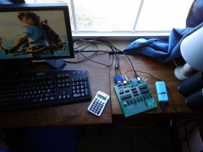

Did a bit of coding today, putting in the ability to add a VIA in the future.
Then I had a funny idea: Let's power this board from an external phone battery pack! The kind where you charge it beforehand and take it with you, and you can plug it into your phone to recharge it at some point. Extra portable power. Because I run power from a USB wall-wart anyways, this theoretically could replace it.
And replace it it did! It has been running for over 7 hours now. The battery pack was not fully charged, it hasn't run down even half of what it had. This battery isn't anything special, in fact it was the cheapest one at Walmart. Nothing is hot on the board, everything has been stable, multimeter says it has 4.9V right now.
I had no idea how fuel efficient this board was. This could seriously become a handheld or 'laptop'. Easily. I'd like to see how long it would last if I connect one of those 16x2 LCD's to it though, I figured that would draw more power than my VGA circuit.
There is an update. I'm very amazed! Thanks for reading.
The only significant power draw of the LCD is if it's backlit.  A reflective-type LCD (which neither needs, nor has, any backlight) will have negligible power draw.  Something I designed in the 1980's for work used a 16x1 intelligent character LCD and a 65c02 which ran at 170kHz most of the time to save battery power and kicked it up to 1MHz when there was a long string of floating-point calculations to do, and the whole thing, including the LCD, took 2mA.

I haven't measured, but I think my 20x4 LCD draws quite a bit of current. It's a little flickery, and I feel like my wall wart is struggling. I was thinking maybe I could put a pot on the A/K of the backlight and tone it down. It really doesn't need to be that bright...

you can use one of those cheap USB Power Meters to see how much current/power it's drawing from the pack. and see how it changes when you unplug things, like the keyboard, or VGA cable.
Your design is all CMOS and fairly low frequency, so I expect it'll draw 20-30mA. Your USB power bank is probably 5000mAH, so I'd expect it to last 200 hours or so, call it a week.
