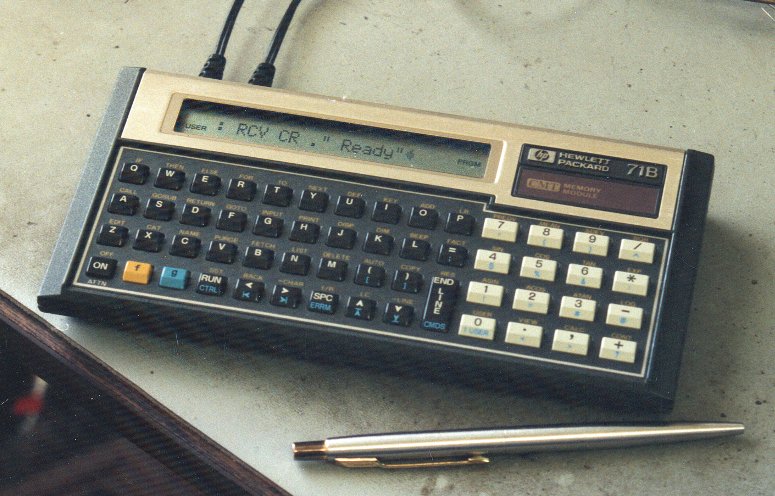

My HP-71 computer shown here
has a 1x22 LCD.  I have the 80-column video monitor for it, but for portable use, when I was using it a lot, I wrote a rather full-featured text editor for use with only the built-in display, that allowed me to nimbly move around a large file.  It may seem like you're looking at your work as if through an old-fashioned keyhole; but if you make it so you can move that keyhole around your work nimbly, it works surprisingly well.

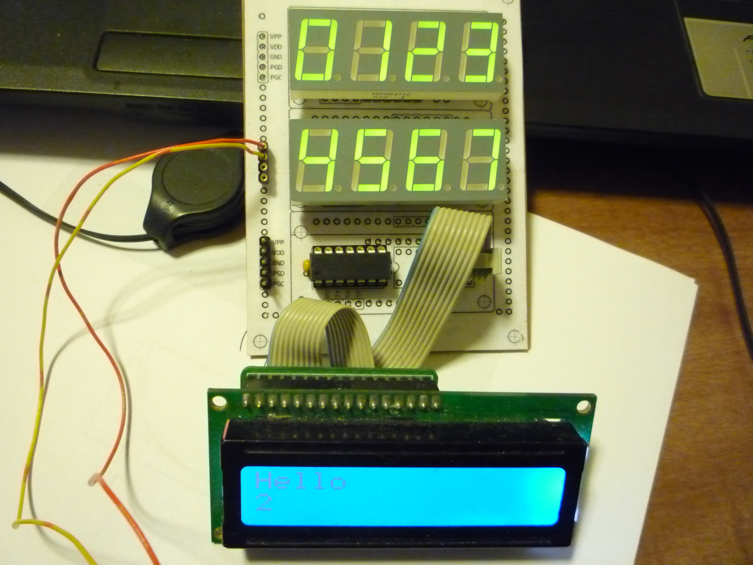

I've found the DIYMORE 2.42" OLED displays very good indeed. They're a seven pin SPI connection so easy to interface but as they're a pixel-addressable 128 x 64 graphics display (1309 controller) they're a bit harder work to drive. For text you'll need to include a font (vertical, just to confuse you!) and of course it takes a few more writes per character... but they are usable at eight lines of text though prettier at four lines (in both cases, of twenty characters).
They're available all over the bay; the last ones I bought were about thirteen quid each though single units are often offered at around twenty.
Somewhere I have a datasheet for the part but I can't immediately locate it :)

I found the technical PDF for the display; attached.
The initialisation code I use (In C, but obvious and linear) - ssd1309_write_command(xx) does exactly what you'd expect and sends the byte to the display via SPI

At the risk of going off-topic... I think it's interesting how you might take advantage of the HD44780 controller protocol and put those "unused" locations in DDRAM address space to use. For example, I prototyped a microcontroller based Serial LCD/LED Backpack that could drive either an LCD display or a 4-digit 7-segment LED display. Basically, each Backpack could be set to display four of the "unused" DDRAM memory locations if you plugged in a 4-digit display instead of an LCD display. Another "unused" location was used for brightness control. While I didn't take the concept further, I couldn't help wondering if other "unused" locations might be used for 8-bit output ports, a real-time clock, 8-bit input ports, a serial pass-through with circular buffers to a Terminal, etc. I've attached a picture of a prototype of 3 backpacks below. Two driving LED displays and one driving an LCD display.
Cheerful regards...

PostPosted: Sat Feb 11, 2023 7:13 pm
