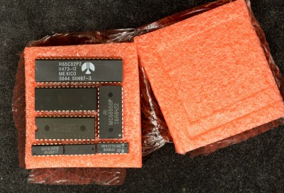

Here is a 6502 kit idea: You can buy kits on eBay with collection of IC. Here is $10 + $6 shipping for "Barebones/minimal 6 chip 6502 computer IC kit". I just ordered one, it says "118 sold". Yes, I understand 6502 from eBay is particularly problematic but this one is Rockwell R65C02 which tends to be less problematic. The rest of the kit should be OK.
Received the "barebones/minimal 6 chip 6502 computer ic kit" yesterday and the result is abysmal. Picture shows the received package, it is well packaged in antistatic foam. There are 7 chips in the package, the 3 TTL tested OK with TL866II programmer; the HM62256 failed TL866II test and also failed to run in a working system; AT28C256 reads OK, but can not be programmed successfully with TL866II; MC68B50 works; and Rockwell R65C02 draws more current than normal CMOS 6502 and does not work even at 1.84MHz.
I'm quite disappointed with the vendor who had provided good Z80 kits over multiple purchases. I will write to the vendor and complaint about the defective parts. My good experience with Z80 didn't translate to 6502. I'm really quite surprised by the defective RAM and EEPROM, this illustrates the hazard of making kits from untested eBay parts.
PS, this does not stop me from purchasing on eBay; eBay has good return policy so I'm ready to test parts immediately upon reception. The few defective shipments I had were fully refunded without exception.
...Rockwell R65C02 draws more current than normal CMOS 6502 and does not work even at 1.84MHz.
That “65C02” looks to have been re-marked. Also, the 0044 date is suspect. Rockwell discontinued 65C02 production in 2000.
I’d give him/her a “neutral” or “negative” rating for shipping you junk parts. Sending parts that were re-marked or outright defective demonstrates either intention or lack of due diligence on the part of the vendor. He/she deserves to be dinged for that.
Yes, eBay’s buyer protection is pretty good. However, it won't compensate you for the waste of your time, nor will it be of any help should a defective part inflict damage on other parts in your system.
Alas! I had high hopes. I have a better result to report: I just received 4 ICs from eBay seller joma0818. They shipped from CA, came in a reasonable amount of time (about 3 days, I think). Although listed in eBay's "new" category, I am 100% sure they're pulls, as I expected they would be. However, they are in good shape, and to the best of my ability to test them they seem to be the real thing. Which is to say, both the VIAs work at 4 MHZ as advertised. I don't have any way to test the ACIAs yet. :)
