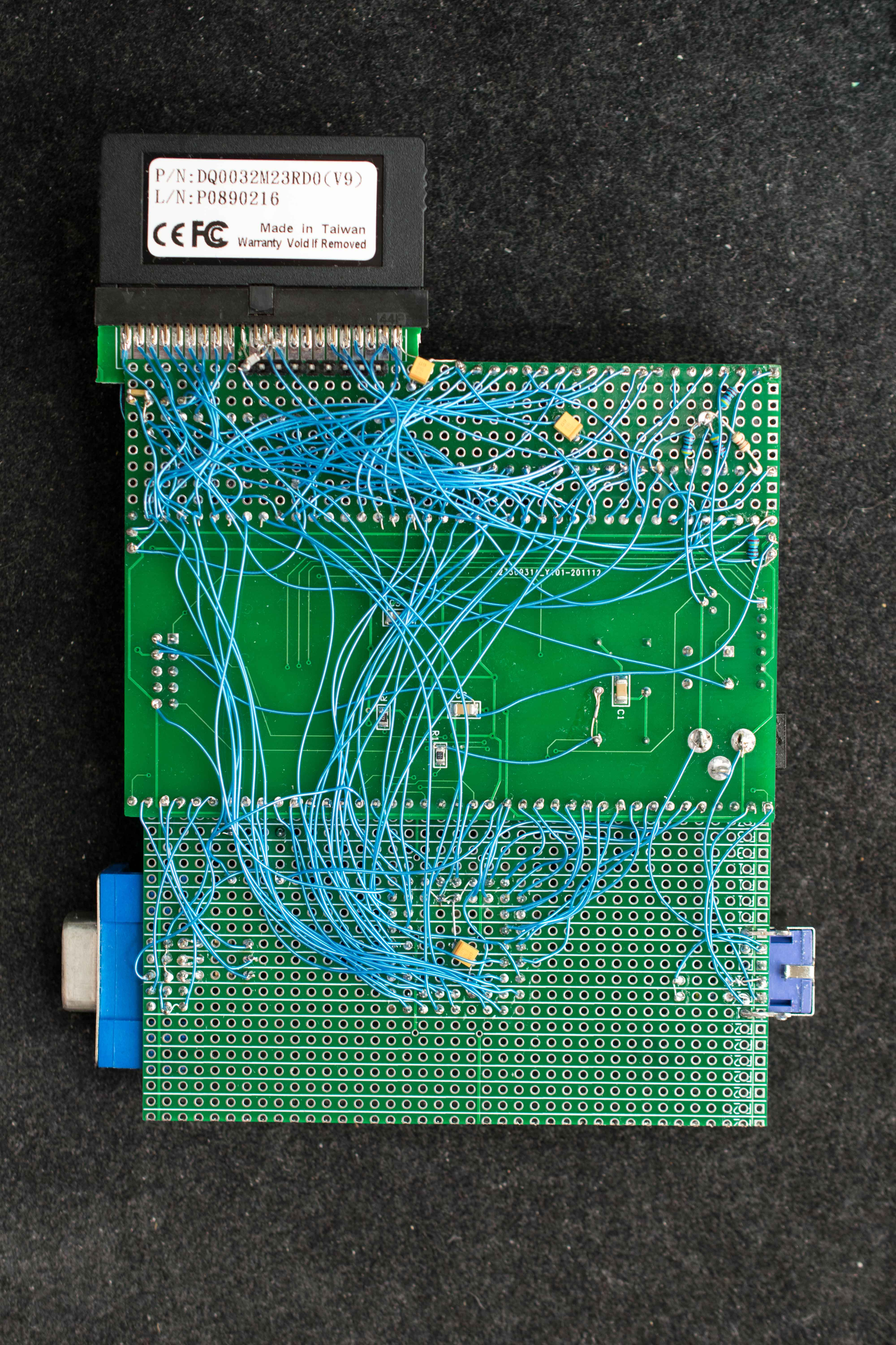

After a month of detour to work on an offshoot of this project, CRC65, I'm ready to come back to this project. I have done quite a bit of software for CRC65, so I do want to reuse these software for this project as well. CRC65 is a simpler design, so by making the design compatible, more CPLD resources would be free up for the VGA circuitry.
The goal of rev0.3 is adding a monochrome, text-based VGA display and a PS2 keyboard. Monochrome text-based VGA is about the simplest VGA video; it needs minimal amount of video memory. The video RAM is an inexpensive 4K dual port RAM (IDT7134) that maps to 4K of 6502's high memory. The other side of the dual port RAM is under the control of CPLD which generates the horizontal and vertical syncs and video data stream at 25.175MHz pixel clock rate. 4K video RAM should give me 1K of 8x8 fonts and 3K of character memory (64 columns x 48 rows)
So Proto65 rev0.3 tasks are:
* Change the design to be compatible with CRC65 software,
* Add a video daughter board that contains a 4K dual port RAM, VGA connevctor, PS2 connector, and 25.175MHz oscillator,
* Add VGA timing generator to CPLD and convert data in dual port RAM to VGA video stream, and
* Add PS2 keyboard input capability.
Picture shows the video daughter board married to Proto65 board.
Here we go...

I have revised Proto65 CPLD design so it is now compatible with existing CRC65 software. Schematic of the CRC65 compatible design is attached. The CPLD resource utilization is now 109 macrocells (57% utilized) instead of 142 macrocells (74% utilized). This should free up enough macrocells to implement the VGA timing logic.

Everything is wired up and smoke tested; 6502 still booted and responded to console command, so miraculously I didn't break anything. Now I need to do serious update to the CPLD to enable the VGA output.

Here is the first picture of the text-based VGA display. The display is 64 column by 48 lines. Each text character is 8x8 pixel so the display area is really 512x384 instead of VGA's 640x480. To take advantage of VGA's 480 lines and to improve readability of texts, I added 2 blank lines per 8 lines, so each character is effectively 8 pixels wide and 10 pixels tall with the bottom 2 rows of pixels always blank. This makes the effective display area as 512x480.
The fonts in the picture are 7x7 with one blank row at the bottom and one blank column at the right side. I can make it a little bit bigger, 7x8, since there are always two blank rows between each line of text.
The monitor is a 9" diagonal LCD monitor with VGA input. It is commonly used as a car backup monitor.
The base address of dual port RAM is at 0xD000. The text memory is from 0xD000-0xDBFF and font table starts from 0xDC00-0xDFFF. As far as 6502 is concerned, the dual port RAM appears as a regular memory. It can execute program, store data and pass memory diagnostic; memory can be read or written at any time. The other side of the dual port RAM is read-only and accessible by state machine in CPLD only. The VGA state machine in the CPLD is effectively 2 cascaded counters, modulo-800 counter driving a modulo-520 counter. Horizontal sync, vertical sync, and associated front porch and back porch are derived from outputs of the modulo 800 and 520 counters. One design complication is the CPLD state machine reads the text memory first then uses the value to index into the font table to look up the bit map associated with the character. The dual port RAM access time is 35nS and these two accesses occur over a character time which is 320nS at 25.175MHz, so plenty of time to accomplish double read access.
The CPLD is now 89% utilized,. plenty of room for PS2 keyboard interface.
