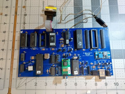

My first microprocessor experience was with a SYM-1 in the 'olden' days.
I spent many hours on one and have a fairly large soft spot for them.
A while back I decided to build a new board loosely based on the SYM-1 as a tribute to my old friend.
With help from this site these are my results.
System
- 65C02 at 2 Mhz
- 64K RAM with holes for IO and 8K monitor in EPROM
- two 65C22 VIAs with all IO lines brought out to header pins
- 65C51 UART
- 8K monitor program in EPROM based on the SYM SUPERMON
- I2C interface for mass storage on serial EEPROMs (24CS512)
- socket for USB-serial module for interface to PC if desired
- socket for 8K EPROM for user program
- onboard ASCII dumb terminal drives a 10" VGA monitor (PIC based from VT100 work by Graham and Hansel)
- USB keyboard (can be wireless)
- 5v/12v DC boost converter to power monitor
- can boot images of BASIC, ASSEMBLER (RAE) and FORTH from serial EEPROM
- all thru hole components for easier soldering

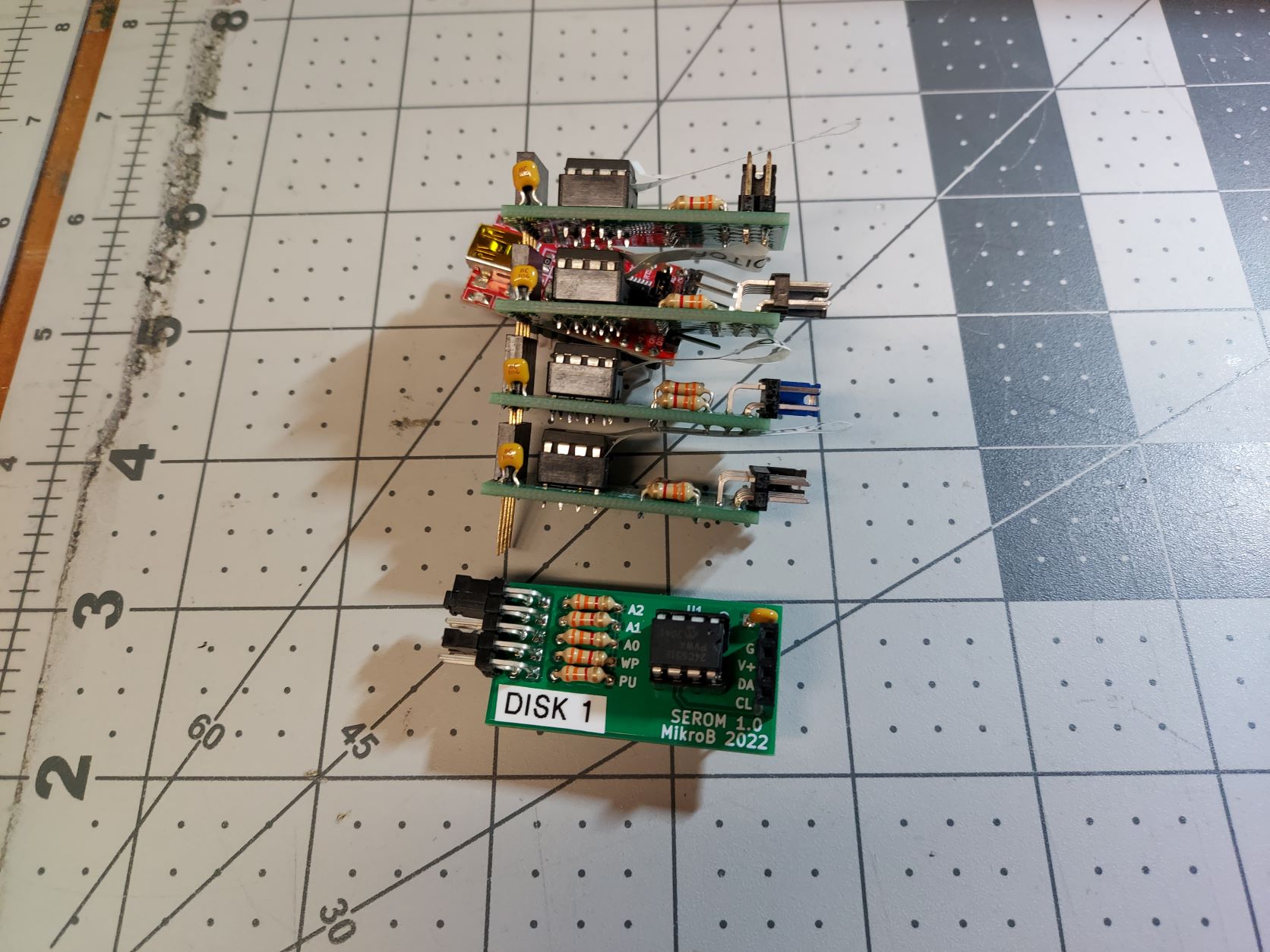

The serial EEPROM boards are used as pseudo-disks for saving BASIC programs, RAE programs and FORTH screens.
They are stackable so you can have several available at any time.

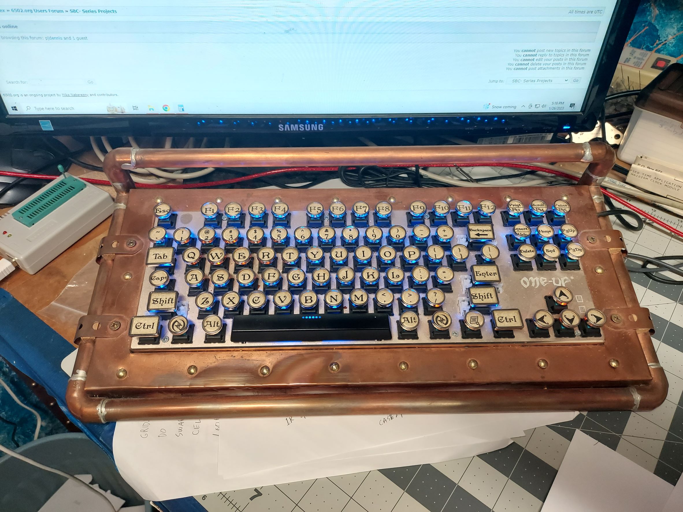

Is that copper pipe I see being used for the carrying handle?

Interesting to see all the options for memory and eeprom including the I2C. I had dragged out my SYM-1 and KTM-3/80 about a year or so ago and interfaced to an IDE-CF card interface as described in the posts about symbiosys from 2012-2013. It worked nicely but the lure of more RAM and higher speeds had me put the SYM away and build some of plasmo's boards. I would be interested in more details about the board design and interface options if you have links. Thanks for sharing.
Yes, good eye. I'm going through a steampunk phase.
It does make for a nice handle though.
You might get a kick out of my keyboard.

I don't have any links sorry, but I can try and answer any questions.
The CF card interface sounds nice, I had thought about that or SD but it seemed to be a little out of my comfort zone.
Reminds me of the old Royal typewriter I had in the late 1950s. No electricity, though—it was an “armstrong” model. Great for strengthening one’s fingers. :D
