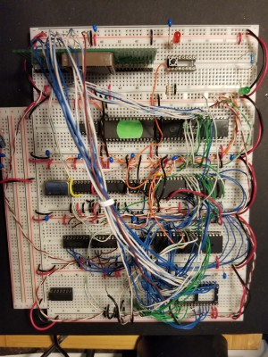

In my quest to bring a VGA text terminal to Blue April I recently arrived at this point:
(Actually, in that photo I have already scavenged a few parts; e.g., the missing EEPROM in the lower right.)
As mentioned elsewhere, it almost, but doesn't quite work. I might could debug it, but I think that I have reached, at least for me, right now, the limit of my neatness and of breadboard complexity. There are just too many wires, and getting the probes and trouble LEDs in there, I end up bumping other things loose and causing new problems. Plus the board layout was starting to get out of hand. The amazing trapeze of bus wires that connects the dual-port SRAM is a foot long. Even with a bunch of extra ground return wires it just seems like asking for trouble.

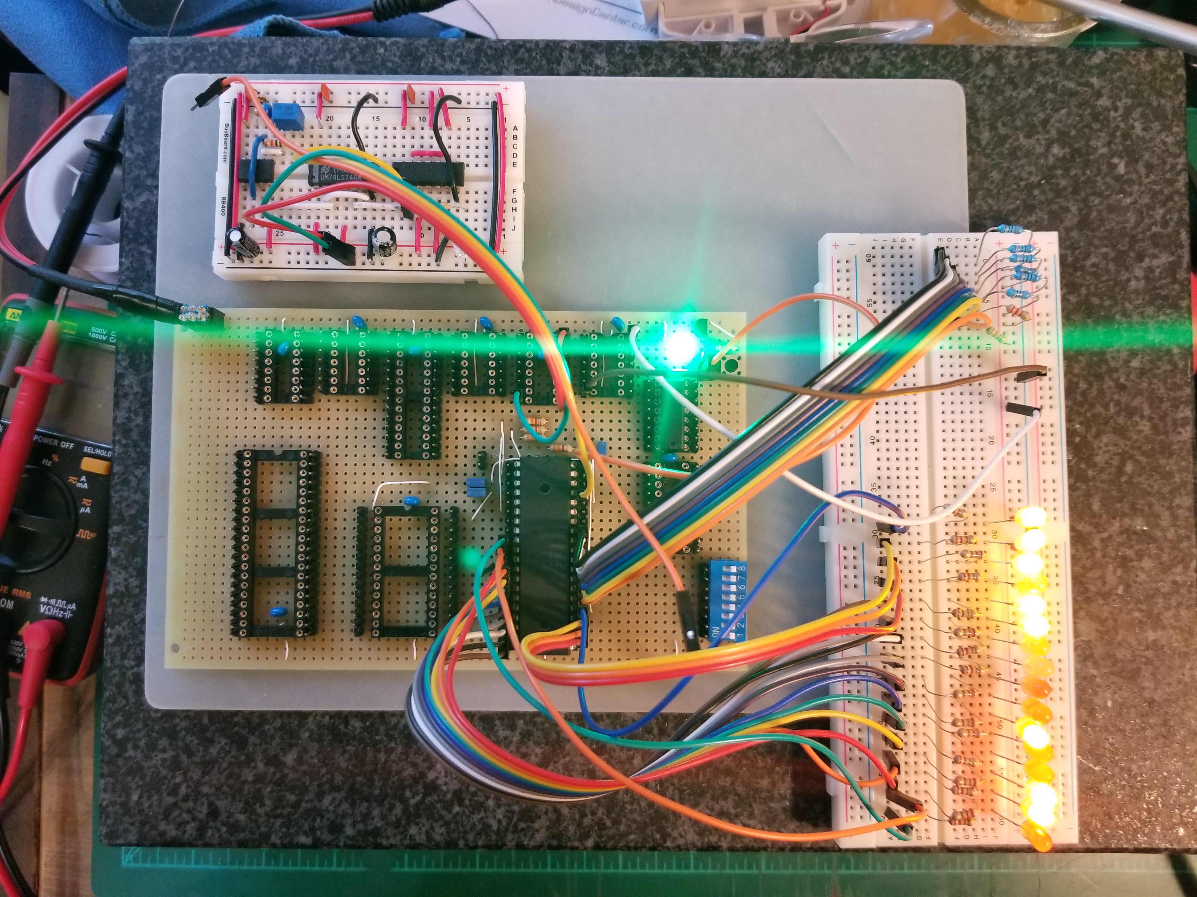

So I started moving the parts that work to a project board. Obligatory glam shot (complete with lens flare!) of the new test rig:
I will be doing some wire wrap on all those header pins, but for today's testing I just stuck on a few Dupont wires. I'll take some photos of the back at some point in the future. Right now it's pretty messy and covered in goo. Paste flux is a hobbyist's best friend. :)
Nice! I would love to see the back end sometime :) So, are you going to solder those sockets to it? Or are you wire-wrapping everything?
Sockets are soldered, along with bypass caps and VCC/GND connections. My protoboard is this stuff:
https://www.busboard.com/POW3U
so it has power rail strips kind of like a breadboard. The sockets are normal machine pin sockets with male pin headers soldered in next to them to serve as 2 height wire wrap pins. I do have some actual wire wrap sockets, but they are kind of precious and expensive and I don't have enough (or all the right types) to build this board, so I settled on a kind of hybrid construction system. I also soldered a few other things, like the jumpers for configuring 27C256 vs. 28C256 (E)EPROM, the jumpers for switching between regular 6502s and WDC ones, and some pullup resistors. I was starting to run a little low on space, so I decided to go with the moveable but not resizable I/O window; the DIP switch in the lower right just selects between 47k resistors to VCC and GND without bringing in all the address lines to be jumpered across the P/Q inputs of the '688.

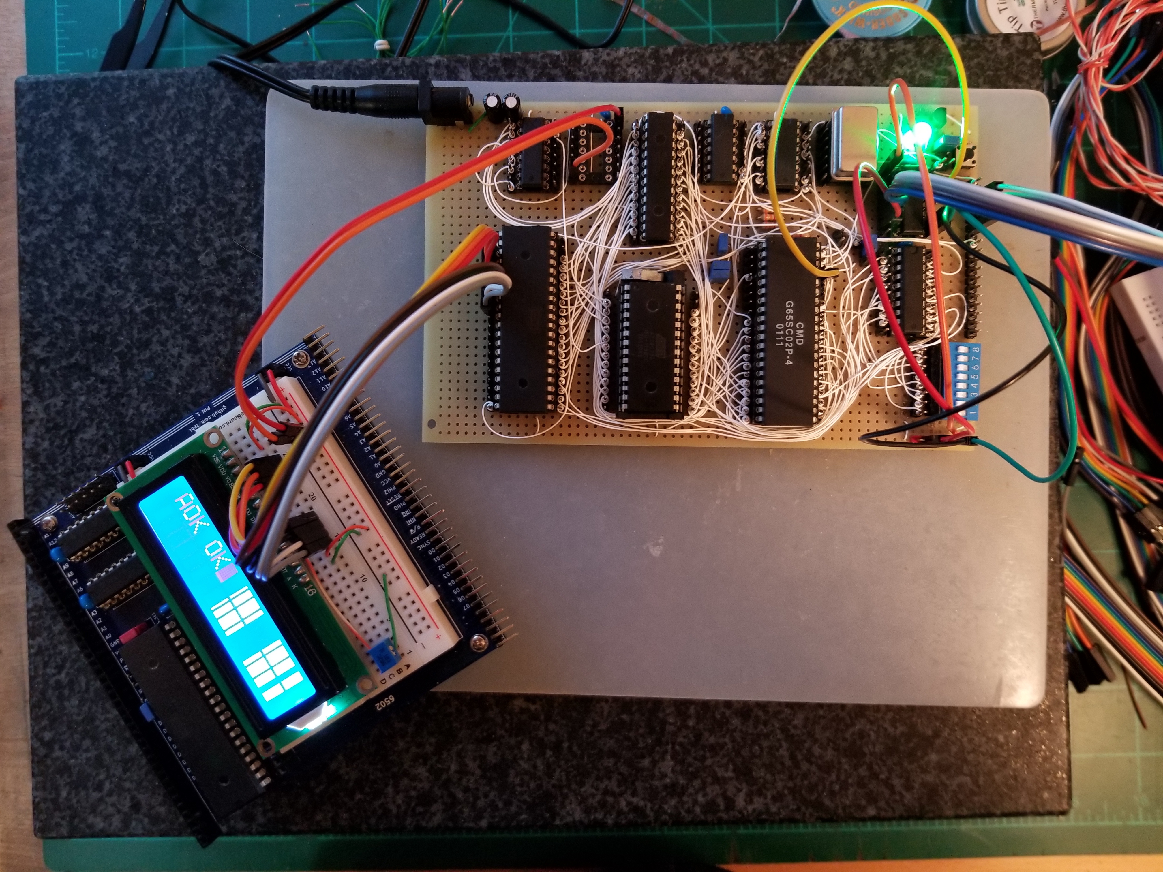

Working board!
I haven't fully tested it yet, but the basics are all there: it's reading code from ROM, jumping to the reset vector, calling a subroutine and returning, so there's some RAM in the stack page, and the LEDs are counting (INC PORTA) so the ZP IO is also working.
Here's a picture of the back, since Chad especially requested one:
It's a bit of a mess. I have a fair amount of rogue solder to clean up. Fortunately I just got a nice new solder wick. :D After that, an alcohol bath to clean off my flux. I make my own paste flux; it works great but it leaves a lot of goo. I also still have a few little housekeeping things to do; there are some floating CMOS inputs I want to jumper to GND, and I need to set up the pre-scaler (right now the '163 is not activated).

Nice! I love how well it is designed. I do not find that messy at all! I really like how you wire wrapped, and on top, but still made it nice and clean. Your soldering work is great too. You seem to have an eye for fine detail.

Did a bit of stress testing today! Unfortunately, something bad seems to have happened to my LCD module since the last time I used it. :cry:
The CMD G65SC02 seems perfectly happy to run at 6.3 MHz, even though it's a 4 MHz part. :D
I put a WDC65C02 in and it also worked, verifying my CPU selection jumpers. It wouldn't run at 12.6MHz, but it did fine at 8MHz. I suppose I've finally reached the limits of my poor overachieving (150ns) EEPROM! :lol: Next round I'll try a 70ns EPROM and see how it goes.
I also verified the moveable IO window jumper, successfully relocating it into the "ROM" area. However, I have not tried all the combinations of the "page select" DIP switches, so it's possible I have some address lines crossed. I'll do that next go round also.
Edit: well, it wasn't quite time for dinner, so I went ahead and did those tests now instead of later. :D The DIP switch block does select the I/O window correctly, and with a 70ns EPROM the WDC65C02 has no problem running at 12.6MHz. Woop! On to the next phase!
This is all pretty fun, but I think this little board is just about ready, so I will be able to go back to building video output circuits again soon! I need a name for this board. It's not blue, and it's not April. :) I was thinking Peanutbutter-1 because PB (Protoboard, or Powerboard, as Busboard calls it) reminds me of peanutbutter. Other suggestions welcome. :)

Be the in-between for the video circuit. Basically, to ease prototyping by giving me a reconfigurable 6502 project board that is easier to interface stuff with than Blue April is. The dual port video ram is not installed on this board; my plan is, to start with, to put it next door on a breadboard and connect to it with a cable. Then I can learn how the dual port ram works. I'll also put the CRTC on the breadboard, and my output stage from the last VGA circuit (cos I know that one works).
The POW3U protoboard I'm using has traces for an oldschool eurodin 41612 connector. Those go up to 96 pins :shock: , which is plenty for a 6502 expansion bus! Phoenix has the very ones, but they're kind of expensive (also their cheapest shipping is $14!) so I haven't ordered any.
