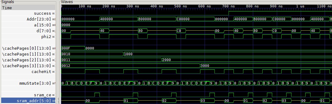

PostPosted: Sat Dec 24, 2022 4:00 pm
Posts: 193
Location: Madrid, Spain
A quick note before Christmas Eve :)
I got a very basic Helium MMU working in verilog. At least, in a simulation.
This is by no means simulating the CPU. I'm just feeding it ramdom address, similar to what a 65c816 does. Please ignore the "success" signal in the scope. Addr is the current address the "CPU" wants. a and d are the simulated 65816 address and data buses. PHI2 comes from the MMU itself.
CachePages is a memory array, which stores the 'page' part of the address. This is A23-A10. At boot up, there are 4 random pages there. As the requests for memory access come from the CPU, if in state 8 of the MMU, the cacheHit line is low, means the requested page is not cached. We then move into states CDEF, which right now represent the page read from DRAM. The full page is copied over to SRAM, and we jump back to state 9, which then enables the SRAM output. Meanwhile, the cachePages array has been updated with the recently read page.
Around the 700 ns mark, a page already in cache is requested, so the MMU jumps directly from state 8 to 9. You can see how PHI2 cycle is shorter here.
The idea seems valid. What worries me the most, is the huge penalty that a cache miss causes. Copying 1Kb from DRAM to SRAM, will require 1024 reads/writes. With a 10ns SRAM, let's say I get 3 writes/reads per CPU Cycle at 14Mhz. So, best case, a cache miss cause the CPU to stall during 350 / 400 cycles. Quite big impact I'd say. Reducing page size is the easiest approach to reduce this.
There are of course solutions around this, but complexity will increase too much maybe. I said complexity is welcome... but let's not overdo that :)
I'm attaching the verilog code for the cache, just in case someone want's to take a peek.
