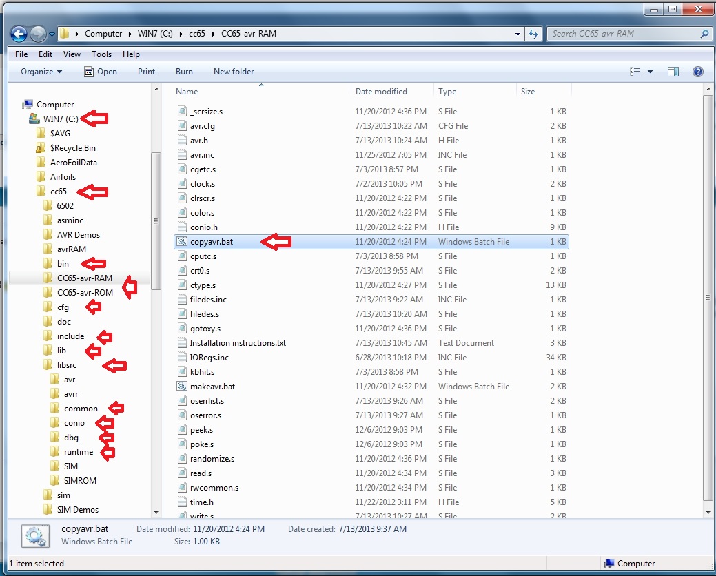

I have a question, I downloaded the AVR_CC65.zip and had a hard time to get makeavrr.bat work (I had to change the commandlines for AR65 and CA65, the versions I recently downloaded behave differently than the bat-file expects, e.g. CA65 expects a file name after -l and the AR65 does not like wildcards when adding modules, perhaps it's also due to my lack of Windows know-how). But now as the batch makeavrr.bat runs without errors I don't find the expected ROM Image. Or what do I need to do to get the image now? The BATCH file merely creates the avrr.lib and nothing more. Sorry if I ask a stupid question, but I'm completely lost.
Regards
Peter
PostPosted: Sun Oct 27, 2013 5:15 pm
Posts: 1748
Location: Sacramento, CA
Hi Peter,
CC65 is not easy to get set up. Did you follow the directions in the Installation Instructions.txt file explicitly? Did you install the CC65 files in "C:\CC65", or are they in another location. Did you also download the CC65 source files? My batch files expect everything to be in the right place. You should not have to run makeavrr.bat directly. copyavrr.bat will copy all files to the right place and then it will call makeavrr.bat.
The idea is that the "CC65-avr-RAM" folders are the original source files and they stay in the CC65 folder. The copyavr.bat file copies these to the libsrc folder and then runs the makeavr.bat file to compile the library. It also moves the library file, header files, startup .o file, and cfg file to proper folders.
If you run makeavr.bat from the original source folder, it will not work as the file are not located in the libsrc folder. I hope that makes sense.
I have attached a screen dump of my C drive with CC65 expanded. The red arrows show the required folders. You only need to run the copyavr.bat and copyavrr.bat file to build the libraries. Once that is built, you can compile your own C source files using the new libraries.
For example. After creating the RAM library, open the ascii folder in the AVR Demo folder and run the make.bat file. it will compile the program and create an "ascii.ram" file. This is the file you download to the AVR. It will load at $400.
Let me know if this helps. If not, can you email me some screen shots of your folder layout?
thanks!

File comment: folder layout for CC65

Hi Daryl,
I did as described, and on purpose used the same directory (c:\cc65. So except for the changed commandlines in the .bat files ("ca65 -l %%i" does not work, it gives a "missing input file" error in my case "ca65 -I %%i.lst %%i" works). I also was able to compile/assemble everything in avrr as well build the library (although here as well needed to change the command line for ar65 to get it work).
But I think I did not express myself sufficiently, with ROM Image I though now I was able to create the SBC Monitor from scratch, but as I understand now what is in CC65-avr-ROM/RAM are rather the IO Routines used by the SBC Monitor and so I need to download the monitor source code first and then compile this against the library. So I need sbc2os.zip and unpack it into the tree at c:\cc65.
Is that correct?
